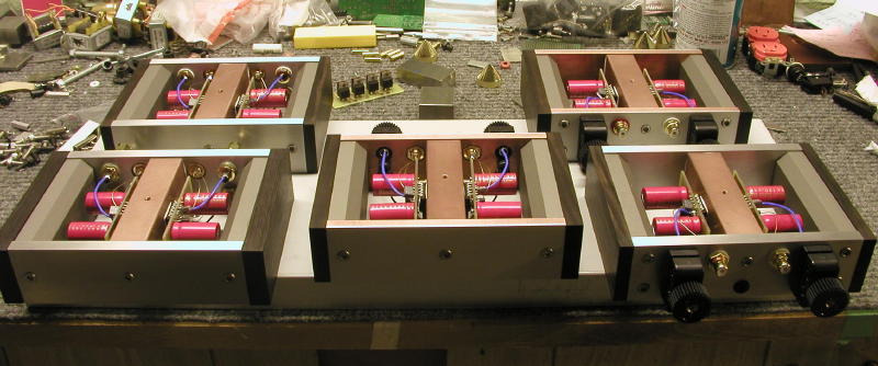

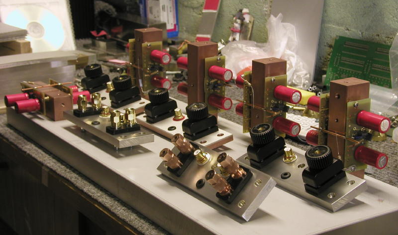

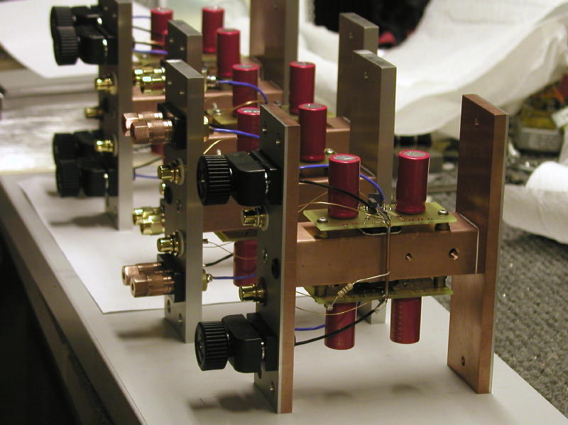

Here some pics how the Patek is made.
With regards to amp alone, the difference between regular version and SE becomes very small now.
In a pic below you see both versions, the only difference are copper/aluminum panels for SE, while regular amp features aluminum only.
The main difference is for PS enclosure.

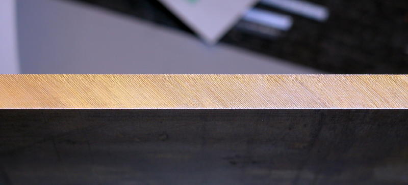

edjosh23 said:I purchased a Freud non-ferrous blade a couple weeks ago for about $45. I finally got to use it this weekend, my first time cutting metal, and WOW! It worked out really well. I have very few tools, but the cuts I made with it were amazing, or atleast for an amatuer like myself.
With a proper blade, cutting aluminum is not much different from cutting wood. If you want to achieve better looking cuts, move the piece really slow. I recently bought 100 teeth blade and I'm amazed with a finish of the cut: it looks almost as if it was milled.
Peter,
I actually did move the pieces very slow, especially the squares, the cuts don't need to sanded or anything, ofcourse I don't really have a stationary sander anyway.

I just cut a piece of 0.400 aluminum, this is how it looks:

sorry if this isn't the place for workshop advice but I thought I'd add my experience.
After a few DIYers had said aluminium cutting was not difficult, I bought myself an aluminium blade cheap(ish) on eBay, which may have been the mistake, and with a bit of trepidation I set out to cut up my 10mm aluminum sheet.
From the start it didn't feel good. One of the teeth kept not clearing itself so I had to keep stopping to pull the swarf out with pliers. After a while that tooth broke off and a different one became the 'collector'.
Needles to say the cut edges will need a lot of sanding.
My aluminum is 6082 T6 which from memory is the high strength grade, so the problem could be a mixture of that or a low quality blade, or something else.
That was definately the blade. There is no reason a carbide blade should load up, unless it is dull or mis-aligned. With missing teeth cutting metal with a table saw becomes increasingly dangerous. The odds of the material grabbing and kicking back increase dramatically. Don't ask me how I know😉
