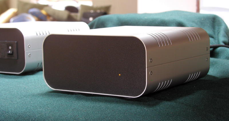

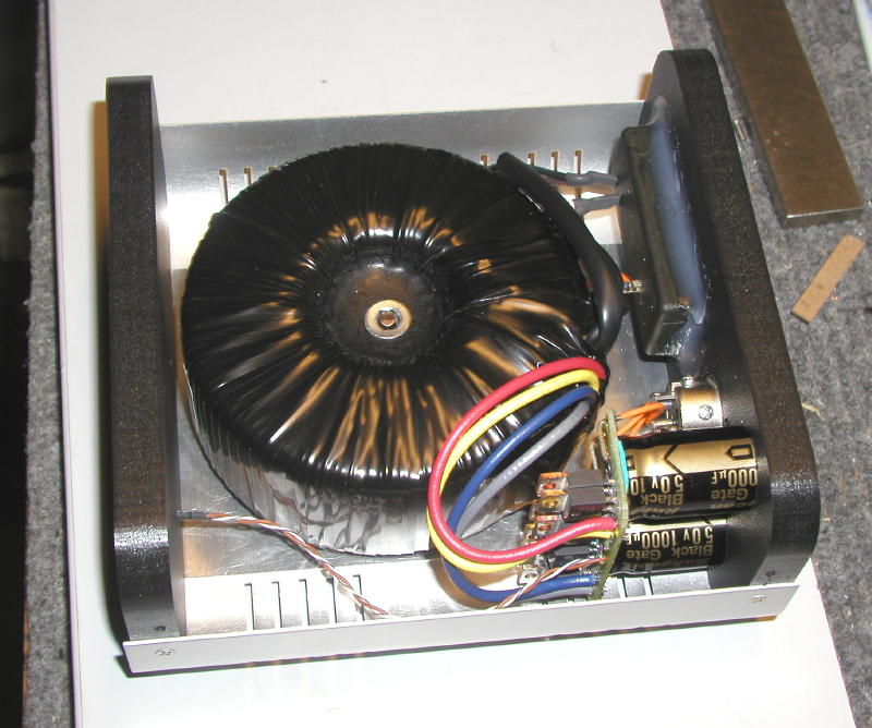

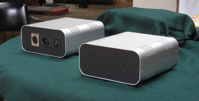

I'm using ATI top and bottom panels (custom made with clear anodizing). I didn't like their fronts and back so I decided to make my own. I'm using here polypropylene panels (1/2" thick, used for floors in boats). It is very rigid and easy to machine. With a template I can cut one in less than a minute using wood router 😉
There are only 4 screws needed to hold the whole chassis.

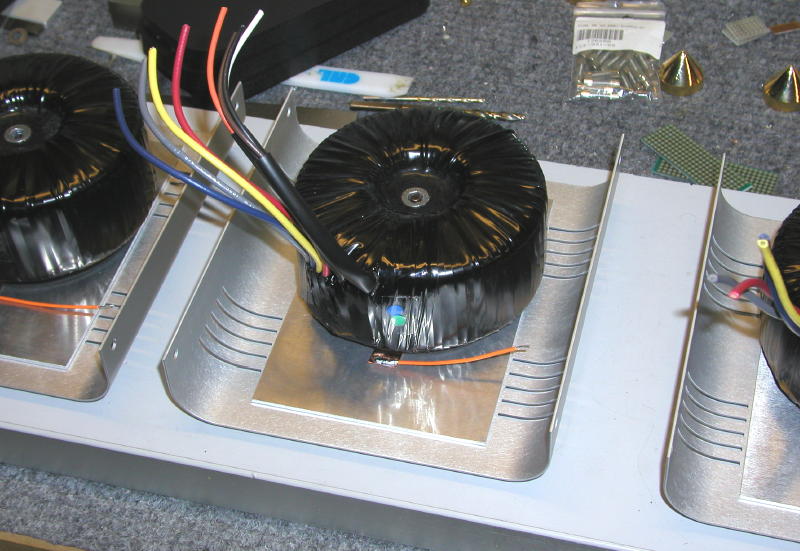

The bottom banel is reinforced with aluminum plate (4 x 5.75). That panel ads stiffness for transformer mounting, as well provides stops for both front and back so the alignement is simplified.
The two BG STD caps, needed in Patek supply, are press fitted into rear panel.

wow that is nice😉 is the Pateks case going to change also?
modern 😀
http://www.atiresearch-anodized.com/
modern 😀
Patek case stays the same, but I might develop cheaper line of monoblocks using those ATI panels, I really like them.
Besides, that case is only for a cheaper Patek version. SE Patek is still available and its PS enclosure appearance matches the amp.
