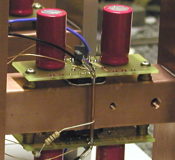

To mount the chips like that, the pins need to be bent 90 deg. With 1/4" spacers there is enough board clearance, as all components are mounted now on the other side of the board (ground and power planes are in bottom layer now).
The grounds of both channels are connected with thick copper wire, which makes the star ground for power supply connections.
I'm still using Rikens, you can see it in a pic below. The feedback resistor is soldered directly to chip pins.

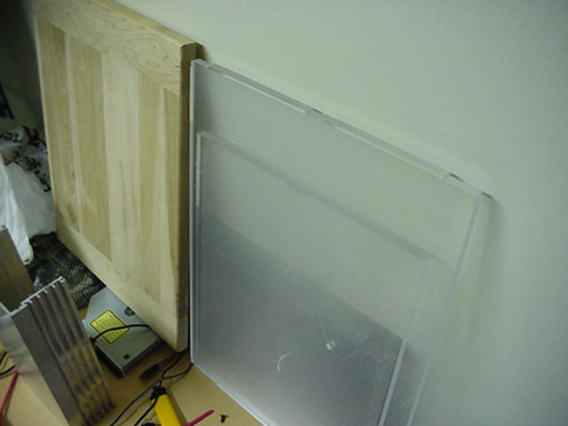

karma said:this is what i want to make😉
should be easy now. if i can keep all my fingers
Karma,
I don't care how good your saw blade is, I really wouldn't recommend using a table saw to cut that 1/4" glass.😀 It can get real messy!
I don't think even Peter can do that!😉
Joined 2002
karma said:ya right im using plexyglass😉 from old 20 inch lcd monitors.
the tube stays cool so it should be alright
Where do you get old 20" lcd's Id like one 🙂

Karma,
I don't know if that is true plexiglass (polycarbonate) or lexan. I have cut polycarbonate many times with a table saw, and it is very very touchy. It likes to crack and split. It is not dangerous, but the material tends to crack and run just like a cracked windshield. You need to be very particular about your saw setup. Any little bit of back cut on the blade can cause the plexi to chip and break out. So, take your time on setup and do some test cust on some scrap (if you have it).
The other place to pay particular attention is when you go to drill and attach it to something. When you tighten a screw into it, it likes to shatter around the hole. The trick is to use a bar of aluminum to spead the pressure out when attaching it.
Lexan on the other hand is a completely different beast. It takes abuse and keeps coming back for more. The lexan tends to do more melting than splitting. It is well worth the extra pennies IMO.
Good luck and keep all those digits where they belong.
DaveM

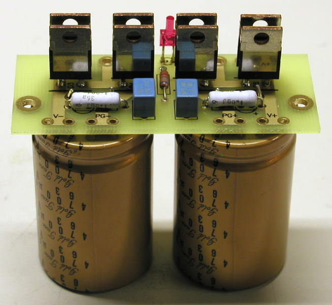

What you can upgrade in Premium kit are filter caps. Normally, I supply Panasonic FC, but for the best version I would recommend BG N 100/50 directly at the chip and BG STD 1000/50 at rectifiers. Everything else stays the same (you also need a very good transformer for best results).
This is the exact configuration I'm using in an award winning Patek amp: 😉

Now I have to ask, because I think I will buy some BG's as you mentioned and I have seen.....
Where did you attach the BG's on the rectifier board? I think I can figure out where they go on the amplifier board 🙂

Ok Peter now you know I have to ask....
What do you have on C3, C4, R1 and R2? (R3 is just for the Knome hat LED right?)
Yeah I am nosy, but I figure I might as well make the best freaking amplifier I can. I plan to use this in my main with some FR125s horn floor standards I believe... Plus I LOVE solid state!
