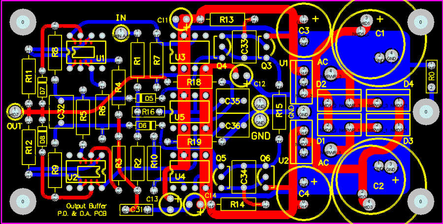

I'm close to finilizing an output buffer stage that can be used in a preamp or DAC. Here's the proposed board layout. The board contains one audio channel and a complete PS (except for transformer). The size is about 2 x 4" .
I think Me / Brent would be good person to give you some feed back on this :D
Here's the schematic. I was working on that design with another forum member, Veteran, and he provided the layout's concept, I made the final trimmings. Schematic is also drawn by him.
I've been using that buffer in my preamp for last two years, and I'm very happy with a performance. Combining that with an input gain stage and volume control circuit, may create quite attractive line stage.

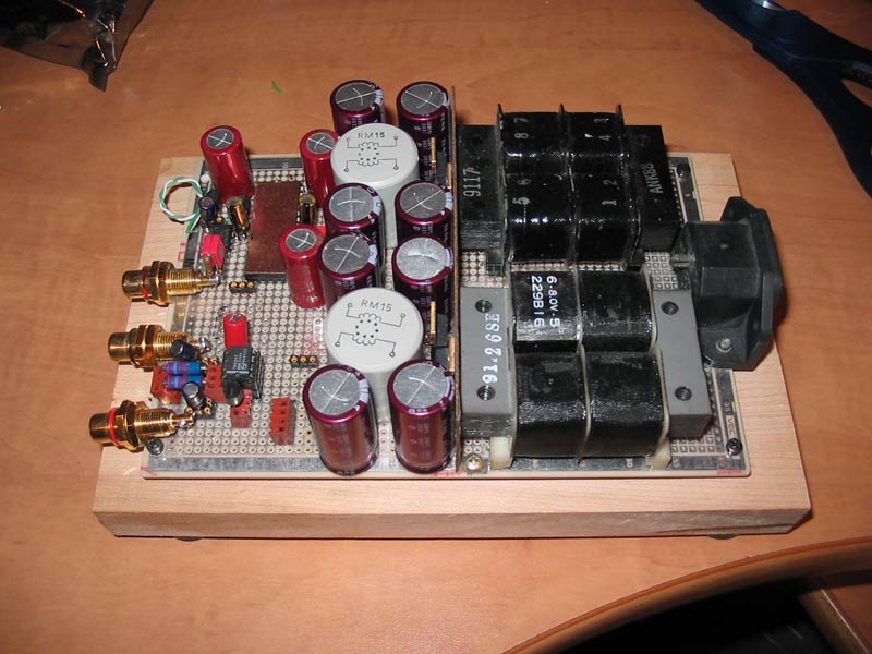

This was one of the early prototypes, made p2p. Apart for two separate transfomers and different caps in initial filtering, there is not much difference with current DAC version. That DAC was still using ceramic triplets, removing them may improve the sound (or maybe not ;)).

Jason... Take a close look at the underside of the board to see them. I haven't changed anything on it yet. In the days when I only had one DAC I was afraid I would have none if I messed with it. Next time it finds its way back to my desk I will bring it up to date and also give it a USB front-end :)
You are not allowed to put a usb front end on it..

Sorry for being a pain in the neck but without an input cap the servo may possibly want to adjust offset voltage from the stage before the preamp/buffer when things are DC coupled. Just a note to those that may want to try this schematic.
