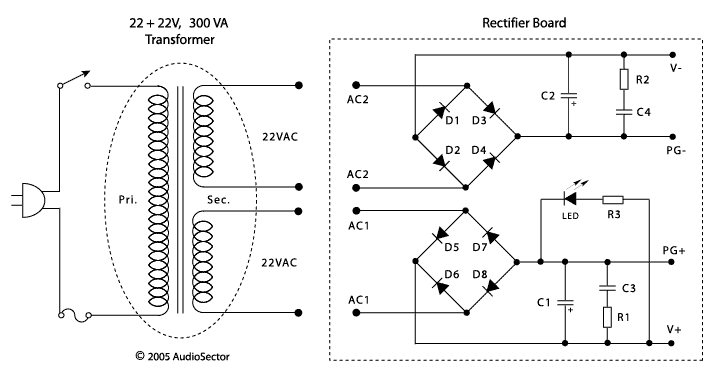

Thanks to the courtesy of a forum member, here's the detailed schematic of LM4780 rectifier's board.
C1/C2 as supplied are 10uF Panasonics FC, but you can experiment with different values as well. Recently some people tried 100/50 BG N caps here (with Panasoncs 1500/50 FC on the amps board) and the results were very good. You might also choose to not install those caps at all.
R1/R2 and C3/C4 are snubber components as suggested by Carlosfm. I'm not a fan of snubbers and I'm not using them. The current values can be found here: http://www.diyaudio.com/forums/showthread.php?postid=748529#post748529 There are additional holes on the board, where a cap up to 10,000uF can be installed when snubber is used (that cap would be on schematic in place of C1/C2 and the small 10u caps are not being installed then.
R3 is used to limit the current through the LED and for a small Panasonic red LED, I'm using 68K resistor.
I will be soon posting similar schematic showing the amp board.

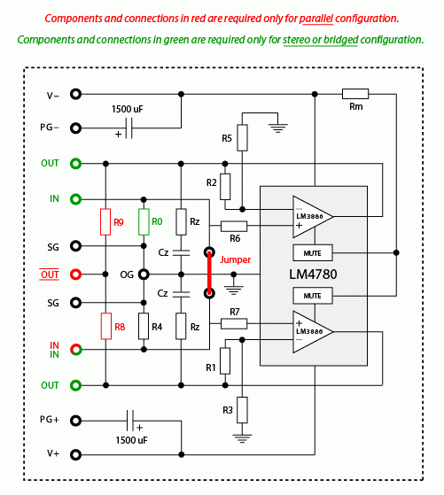

OK, here it is, a proper schematic for LM4780 amp board: two options available, bridged configuration is the same as stereo (a balanced signal needs to be supplied to the amps input). The connections diagram also matches the board's layout (nice touch, Todd) 😉
Resistors values are as follows:
R1/R2 = 22K
R3/R5 = 680R
R0/R4 = 22K
R6/R7 = 270R
R8/R9 = .1R
Rm = 10K
Rz = 2.7R
Cz = .1 uF
The (red) jumper for parallel config mounts like that: http://www.diyaudio.com/forums/attachment.php?s=&postid=636571&stamp=1115409304
CHG can be used for connecting circuit ground to the chassis. I'm using 10R resistor when doing that. Please also note that currently 270R series resistors are being used (instead of 1K).
