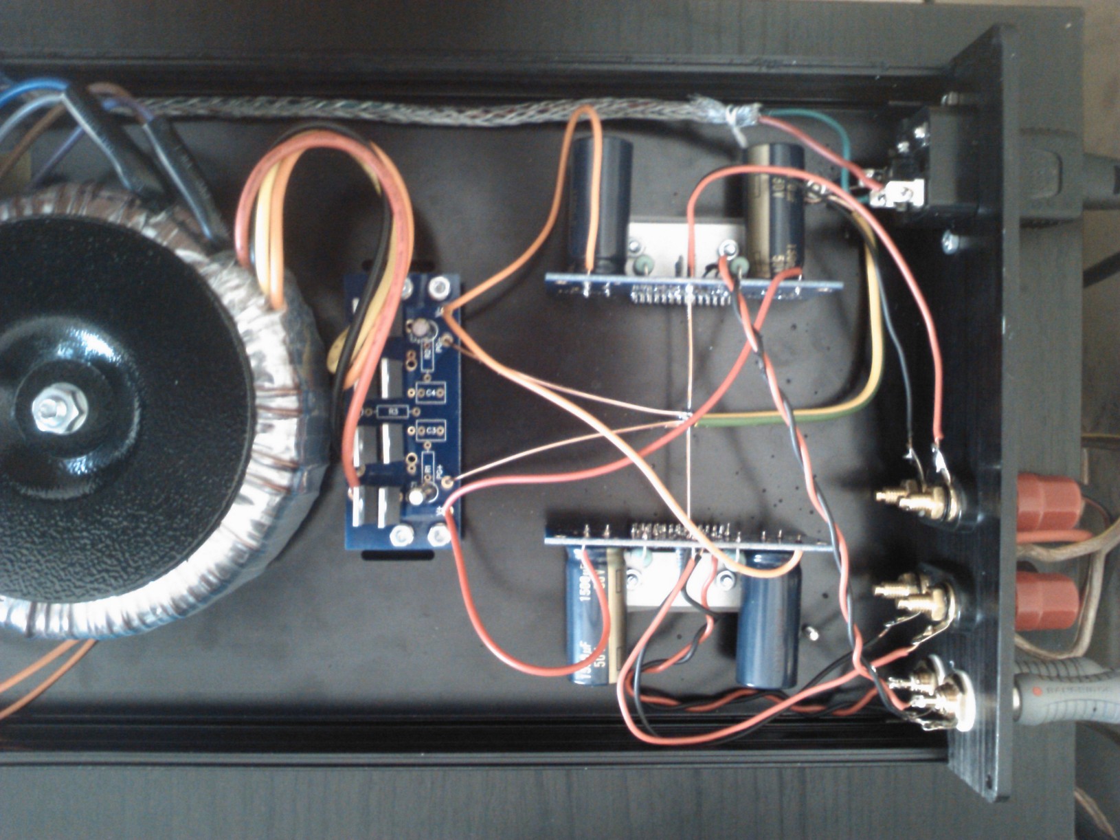

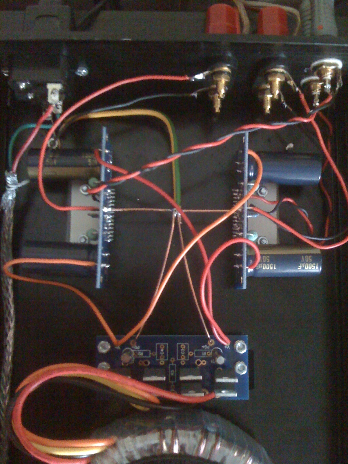

I have finished the kit doing what I asked before.
The LM4780 is now working 🙂
But I have some questions.
1 - In my system ( LM4780+SqueezeBox V3+Celestion F20) I really like the sound. But when I tested at my fathers place ( LM4780+SB V3+Martin Logan Clarity) there was a distinct sound coming from the speakers. Something like gre gre gre gre. Any idea what the problem may be?
2 - It gets really hot. Today I left it just turned on for some hours and when I went to see the temperature with a IR thermometer the temp was 71 Celsius! Is this normal? If yes I really need to add some heatsinks to the side of the casing.

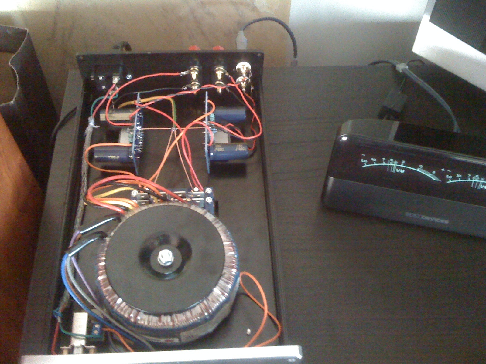

As you will see from the picture the holes that the case had where not in the best position. Do you guys think problem 1 may be related? I'm thinking of doing a back panel with holes in "proper" locations. Will that help improve the sound?
I really enjoy the amp. And in the last few days I have spent all my free time listening and reading 🙂 Great product.
1 - [...] there was a distinct sound coming from the speakers. Something like gre gre gre gre. Any idea what the problem may be?
Can you record the gre gre gre and post?
If left on (presumably without a signal) it shouldn't heat up as you describe.
HF instability/oscillation?
Can you get a scope on the output with not signal? Should be dead quiet, if not, maybe the LM is thrashing away at inaudible frequencies? Do both channels heat similarly? Which part was at 71C?
Does it also get as hot if you disconnect the speakers? Try disconnecting just one, then just the other, then both - and see if there's a pattern. What about with different speaker cable or speakers.
Not the same part, but my LM3875 runs dead cold, and quiet.

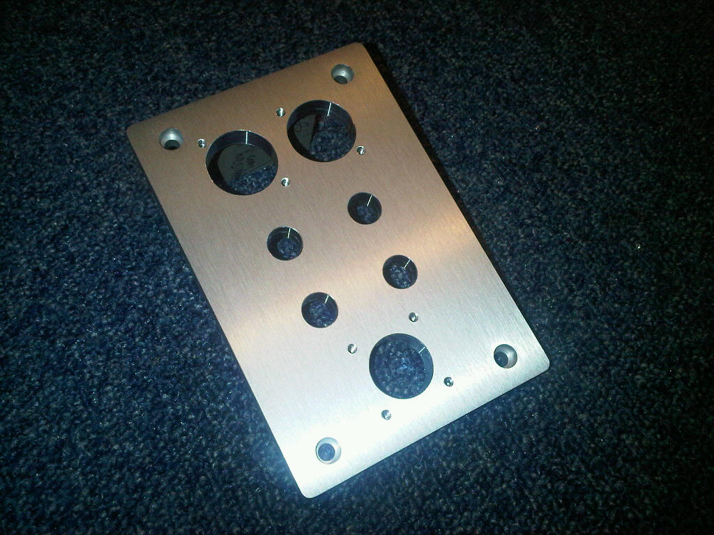

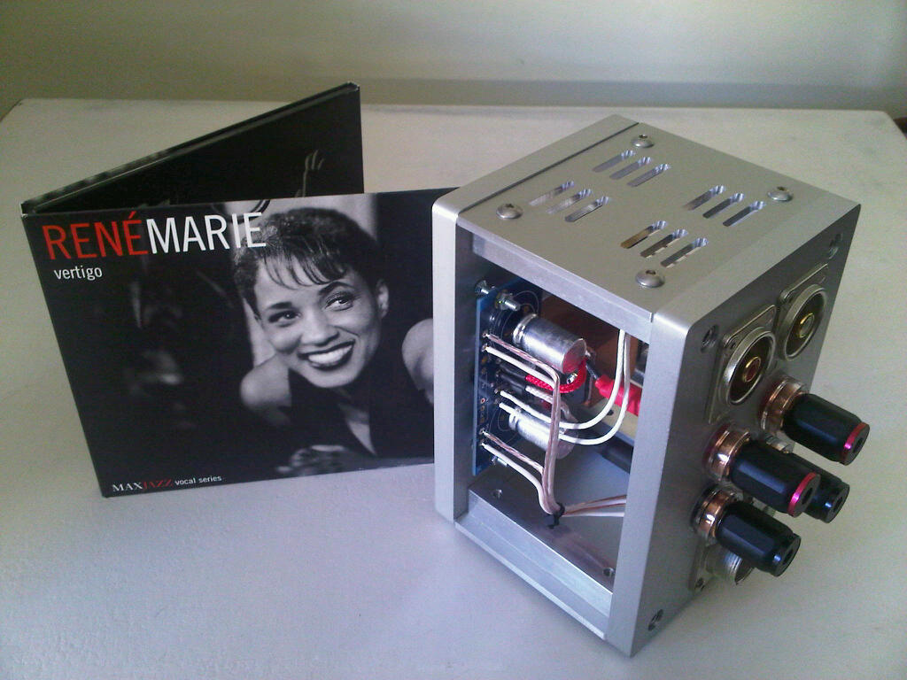

My recent implementation
Just thought you would like to see my recent implementation of this amp.
Front and back panels are from Hifi2000, machined in the case of the back panel to allow connectors mounting.

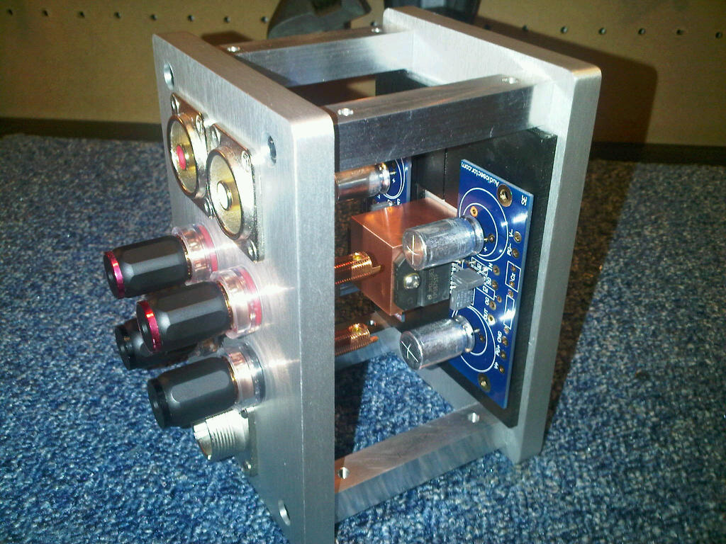

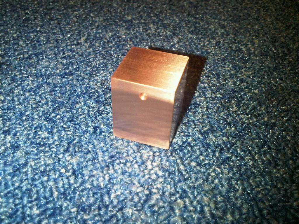

Inside there is a big copper block that serves as heat sinking for the IC's, whish is then connected to the front panel via heat compound.

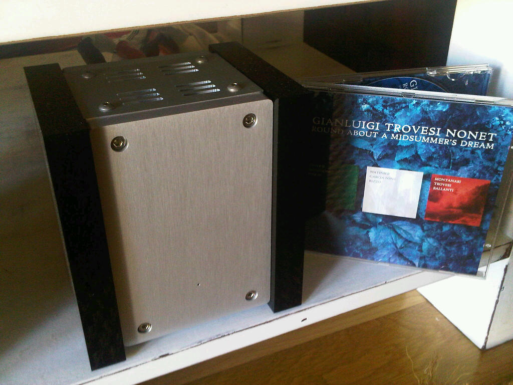

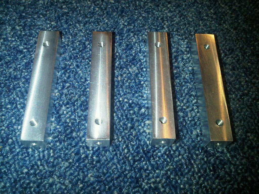

Connecting the front and back, 4 machined aluminum pillars. Laterals are 15mm polished 15mm acrylic boards.
Top and bottom are produced by Front Panel Design in Germany.

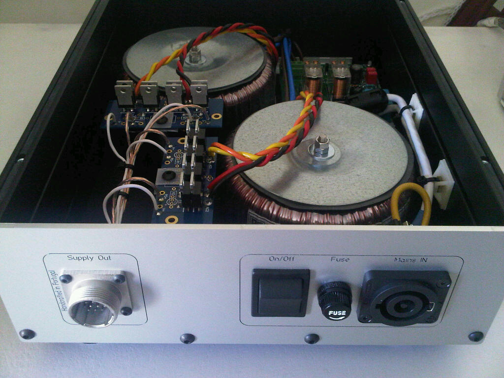

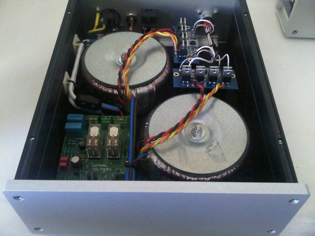

Separate power supply, using separate 225VA toroidal transformers and 2 rectifier boards. Caps under the boards are 15.000uF Gold Tune Chemicon's.

A work of art!
Nice job rclourenco
I also used a block of copper in a small ridged case made of au. How does it sound?
I found it useful dampening vibration with sand. Crazy but you could actually fill your case with sand if you replaced the vented ends with solid plate.
Nice job rclourenco
Nice job rclourenco
Thanks Wlowes, never thought of using sand, and I have plenty here (leaving near the sea 🙂). Nevertheless I use that black rubber compound you see in one of the photos, behind the boards. It's the same used in several hiend eq. On their chassis.

What is the thinkness of the front panel on your power supply box. The scale is great.
It's 10mm. (hifi2000) chassis.
