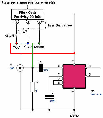

DAC with Toslink
Peter,
One more question.
I want to include Toslink to the DAC. Can you provide the part number (e.g. Digikey or Farnell) of the additional components for Toslink module to the DAC?
The problem is that I cannot select the right part for optical receiver. Different values in nm confuse me.
Thank you very much.
HT

For Toslink, you can use TORX177 or similar: Digi-Key - TORX177FT-ND (Manufacturer - TORX177(F,T))

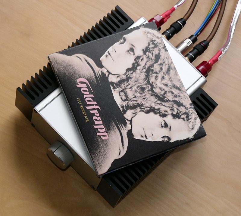

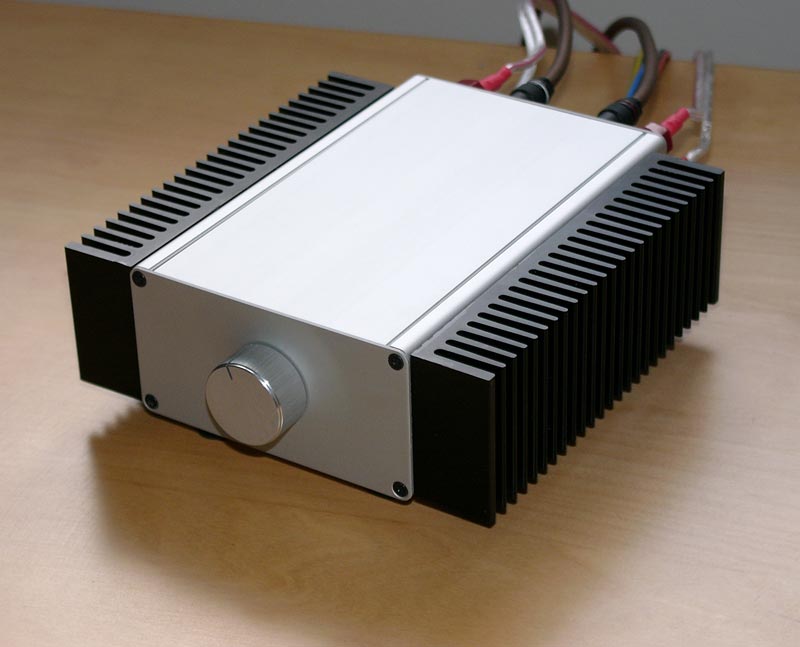

Finished LM3875 kit
Well recently finished Peter's LM3875 kit, burnt it in for quite a few hours and been seriously listening to it for the last few days - must say I am seriously impressed. I have never been an out and out hifi fanatic and never owned any really high end stuff but this little amp is giving me such listening pleasure. Its so silent, not a trace of hiss or hum, and there is so much new subtle detail and effortless performance being extracted from my fairly humble source (small NAD AV receiver system via), and it runs beautifully cool. Speakers are the tiny PMC DB1+S transmission line monitors. The PS uses Airlink 2x22v transformer (easily available here in UK) and is remote from amp. Using stock 1500uf on amp board, and 470uf Panas on rectifier board - no snubbers or zobells. Here are a few pictures of finished article.
Interior shot
Exterior
Exterior with CD for size reference
Had a session at my son's place last night and using his Cambridge Audio CD player and Beresford DAC brought even more out. So the source is my weak link not the little amp. I wonder what this amp sounds like with really high end source, speakers and interconnects. Damn, got me thinking now! Also did a comparison with his monstrous XTZ Class AP-100 class A Power Amplifier and I felt the LM3875 amp was not shamed in any way.
So a big thank you to Peter for making this stuff available to us and for his inspiration and excellent support here. It's been an eye opener and I have a feeling I am now on the slippery slope to poverty.

Check I2S lines with scope.
Hi Peter,
I've checked as you said. Got sin waves at gates 1,2, and 3 of TDA1543 when DAC is on and no digital in. But when digital was connected, I got flat signal.
I again checked output voltages at indicated positions. All values are very close to the values you have suggested in the DAC's diagram.
That is not normal, right?
What would be happening in the DAC?
Thanks,
HT
Check the I2S lines (connections between CS8412 and TDA1543 chips), there should be square wave showing.
Hi Peter,
Thanks,
HT
