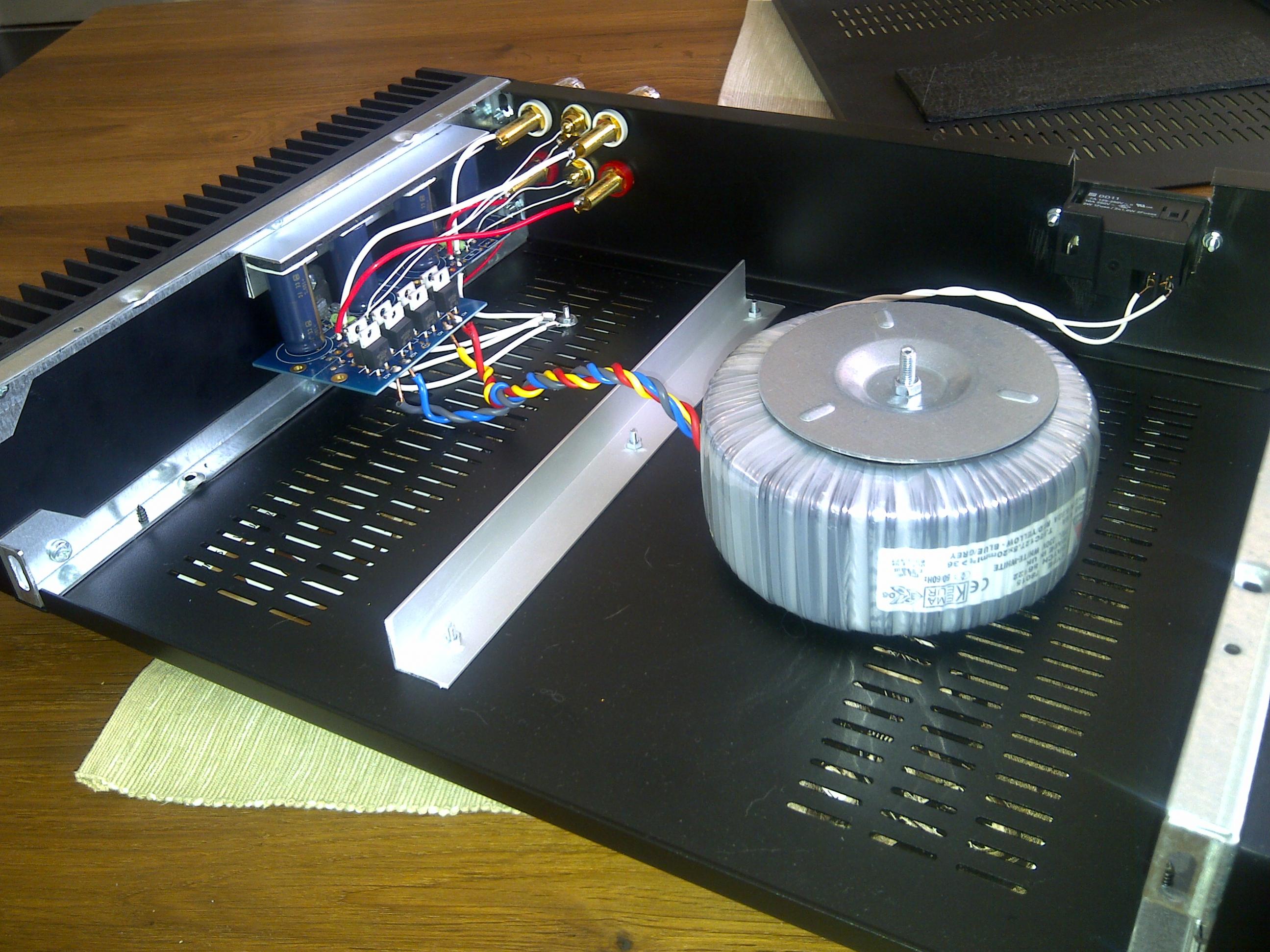

Gain problems
Hi Peter,
As discussed before, the amp sounds good, however I have very low gain on the LM3875's. See pics for my setup.
Help is highly appreciated as I can't figure out what's wrong..... 🙂
Mark.

Found the issue..... I accidently put the 220R resistors on the feedback. Replaced them with the 22k and gain is as it should be 😎
