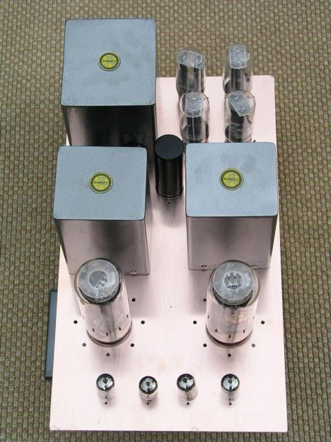

3mm copper chassis. tango op trans, tamura supply choke and James power trans specially ordered.
left with little $ , i used Jensen copper foil caps for front stage coupling.
Only prob is --- i have no real Ongaku to compare with.

clone Ongaku 211 Outlook. Use copper plate & call large copper wall picture company to coated some material( they did not told me) to prevent oxidzed.

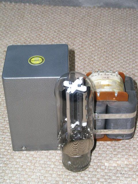

this is tempory OPT which use 0.1 ultra Hi-B according X-10S which prepare for clone Ongaku.

Hi Thomas,
Looks pretty cool. Yeah those Kondo caps are pretty special and rather hard to make, but along with the wire perform very well - more than a little too my surprise.
Your "temporary" transformer looks very nice. You made it as 10K or 16K primary? It was marked 10K wasn't it? The 16K results in higher damping factor, lower thd, at the expense of significantly less power.

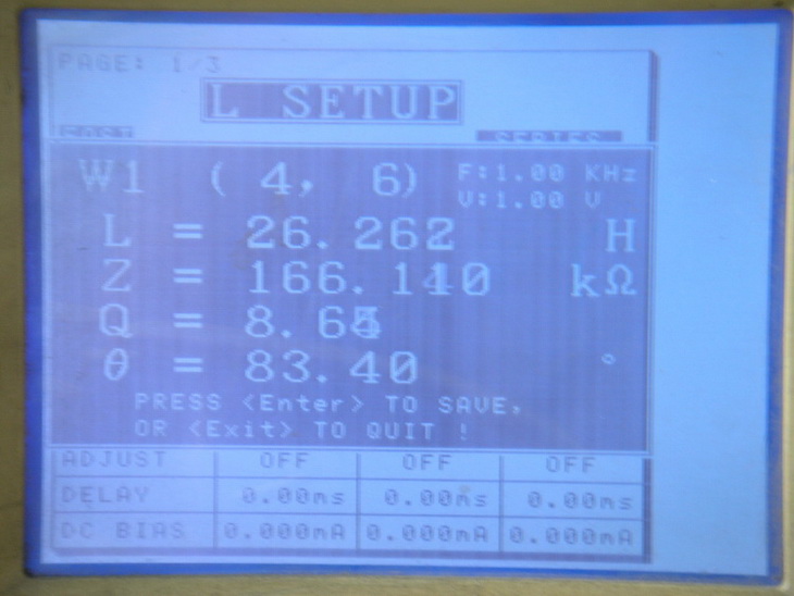

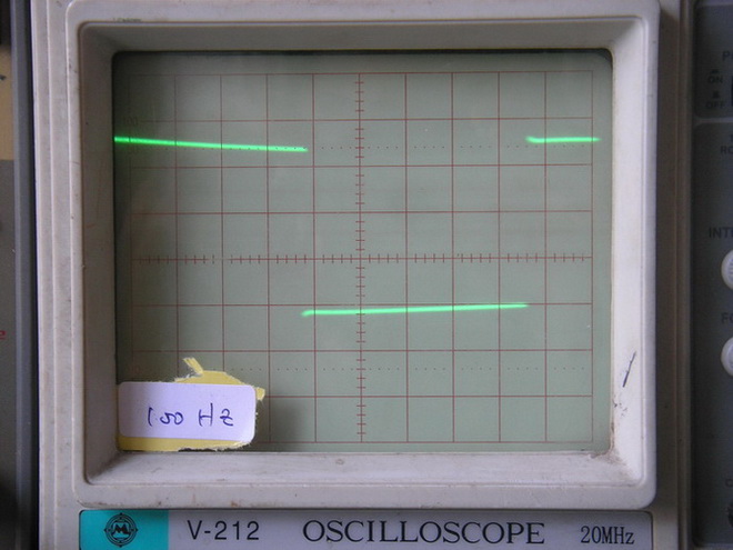

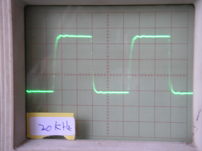

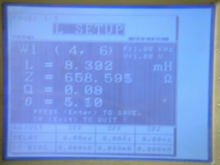

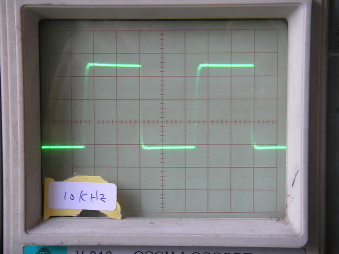

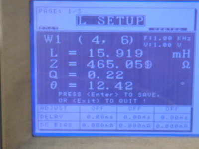

hi all friend,
since I made totally over 30 test sample of Ongaku OPT ( compare to Original one) for data only because original one was too expensive. I test original one & compare to original data ( test menu ) or real Ongaku & finally use the expensive 3M telfon paper for layered material because this 10 ~16K OPT will not easy to make.
I was so happy because finally one was use 0.15mm lamination. + 3M telfon paper with full balance X-winding (full balance x-winding need seperate into two chamber & X-cross connect to lower the capactance).
now test was very good , so Clone Ongaku will come soon & will compare sound quality to original one!
take a look for test result!

hi Gluca,
this is under standard OPT test method to test!.
I use sample method to test real Ongaku,
OPT manufactory method was same as Ongaku, seperate into two chambers, same layers in two chambers, full balance winding, DCR was very close too( because Kondo Ongaku was AG wire, I must considerate into it.
take a look of real Kondo Ongaku OPT!
