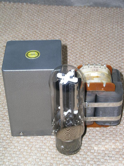

hi,
I made a silly decision already. since I would like to clone a real Kondo Ongaku. but...... is the schmatic in internet was real. some people said kondo ongaku added feedback on later version. What is pri Henry, DCR, capacitance, leakage of the kondo OPT.
so..... how about the Sec??? mH!!!! DCR!!! DCR will effect large on damping for the voice coil of speaker!
so....... I bought my friend's Ongaku for reference. I will post inner photos of Ongaku later for reference. But so..... small secret I will keep it but I really like to know schmatic in internet was real or not!

yes, I bought it in the end from my friend in HKD 320000.~USD41000.
with/ box, all document! He use it only half a year! very new!
I will try to open the secret!
I did over ten samples of the OPT for this 16K already.
I was looking forward use this real kondo amp to tuning for the clone sound!

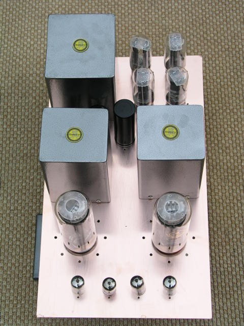

hi all,
I open Kondo Ongaku already.
step by step for it & measure for all point, parts value.
this will easy for me to clone for it.
Probably Poor man Ongaku will coming!!!
take a lok of the inside side of Kondo Ongaku.
when tube amp lighting, I testing & measure the real operation point of the amp.
thx
thomas
thx
thomas

hi Ty,
yes, tunning sound quality must comapre two amp same time, if only copy or clone the circuit but not compare the sound quality of original.
This is not real clone.
hope U will agree.
Now I worry about that the original Kondo caps. I must use different brand of silver foil caps to clone.

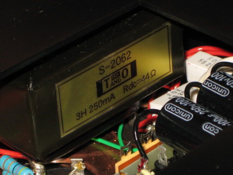

most lucky was........ inner transformers of kondo tube amp was OEM by Tango ISO.
take a look of it!!!
inner of Kondo Ongaku.
photos show the power choke of this amp.

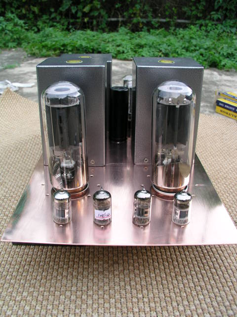

Hi Thomas,
I am ordering copper plates pretty soon for some other projects I am working on and would like to do one for this at the same time. Could you post dimensions for the top plate of the original ongaku? I am particularly interested in thickness of the plate and width/length. Also if you don't mind posting (or sending) a dimensioned cad drawing for the holes, otherwise I have to guess! ;p Keep up the good work, looking forward to hearing your transformers at work!
-alan
