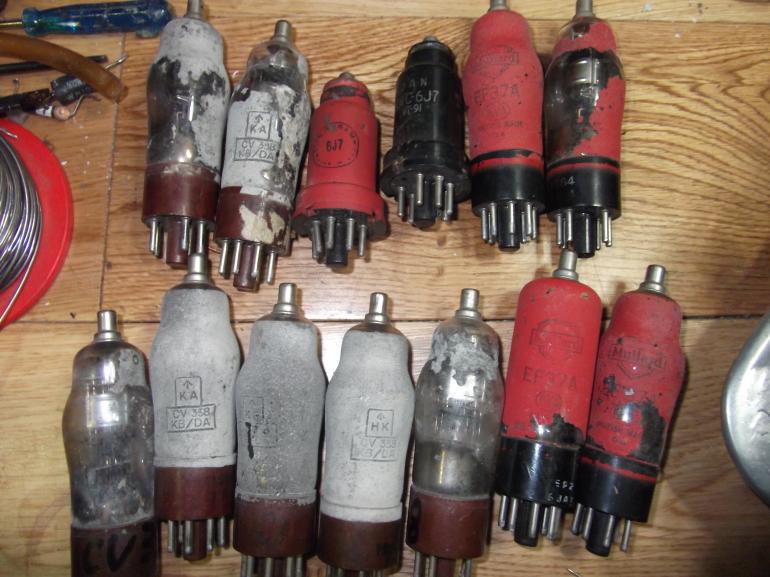

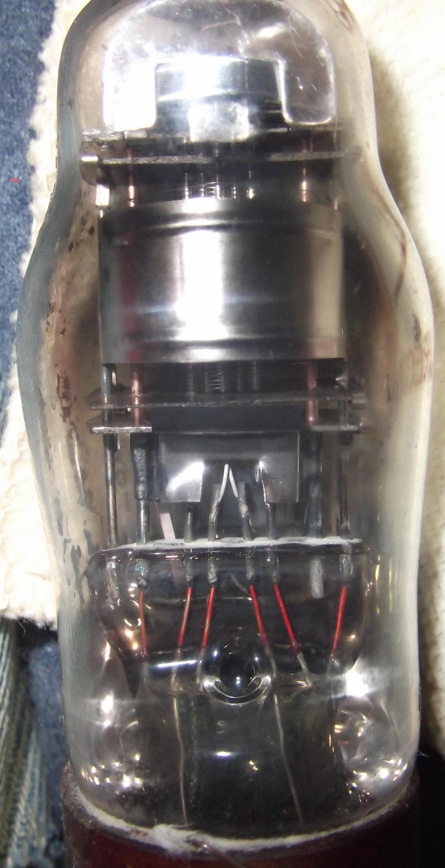

There were very few if any power pentodes in the Enigma machine. The rectifiers would most likely have been mercury arc types. The pentodes it did have in it were almost all CV358s and the rebuild was done with mainly the civilian EF37A as a replacement.
I found one with damaged shielding and polished it up for a shot at the internal construction with a camera😀
I have a feeling that the guy may have been trawling for audio valves. This could be checked by looking at what other projects he has been working on.
