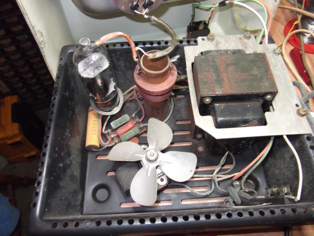

Beam power tube in a Hartley oscillator?
It is a 6DQ6-B beam tetrode and I have not bothered to trace out the circuit as it is very simple and would be easy to follow in the event of a fault.
