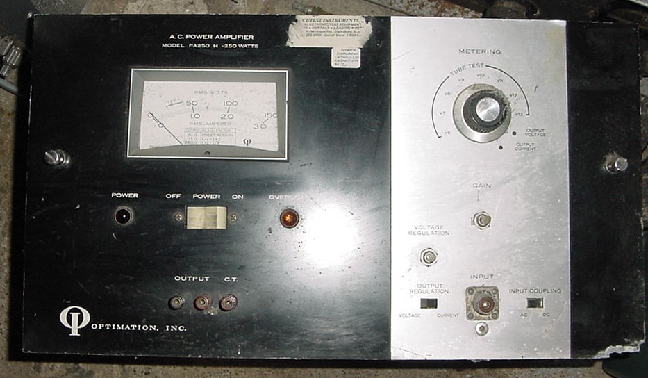

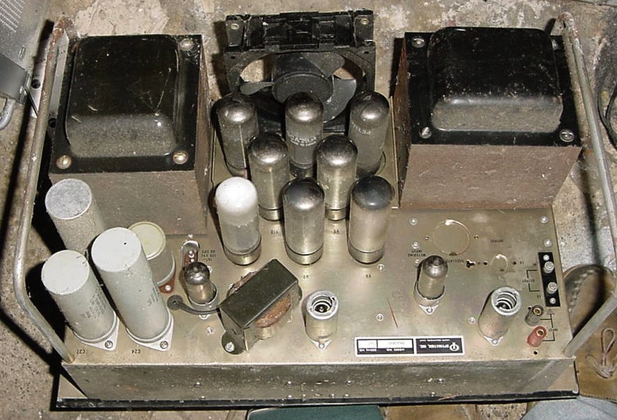

Now, I'll diulge a few of my secret instrument sources for output tubes. The best Hewlett Packard unit is the 716B klystron power supply. Inside you will find six EL34s used as series pass elements. The type 738BR calibrator has two 6550s and a nice wideband output transformer of at least fifty watts. And speaking of calibrators, Optimation made a wideband AC calibration system that used a precision oscillator driving a large amplifier to supply high voltage. It used eight EL34s in push-pull parallel. Some were found with 8417s. These amplifiers actually sounded very good as is for music. The company was taken over by Julie Research Labs, but is now long gone. I have several of these from long ago. Pictured is one of the scrap units I kept for parts.
And I'm sure many of you know about the old Lambda and Kepco high voltage lab supplies that used 6550s and 6L6GCs as pass tubes. And there were other lesser known brands that were good for these same tubes.
