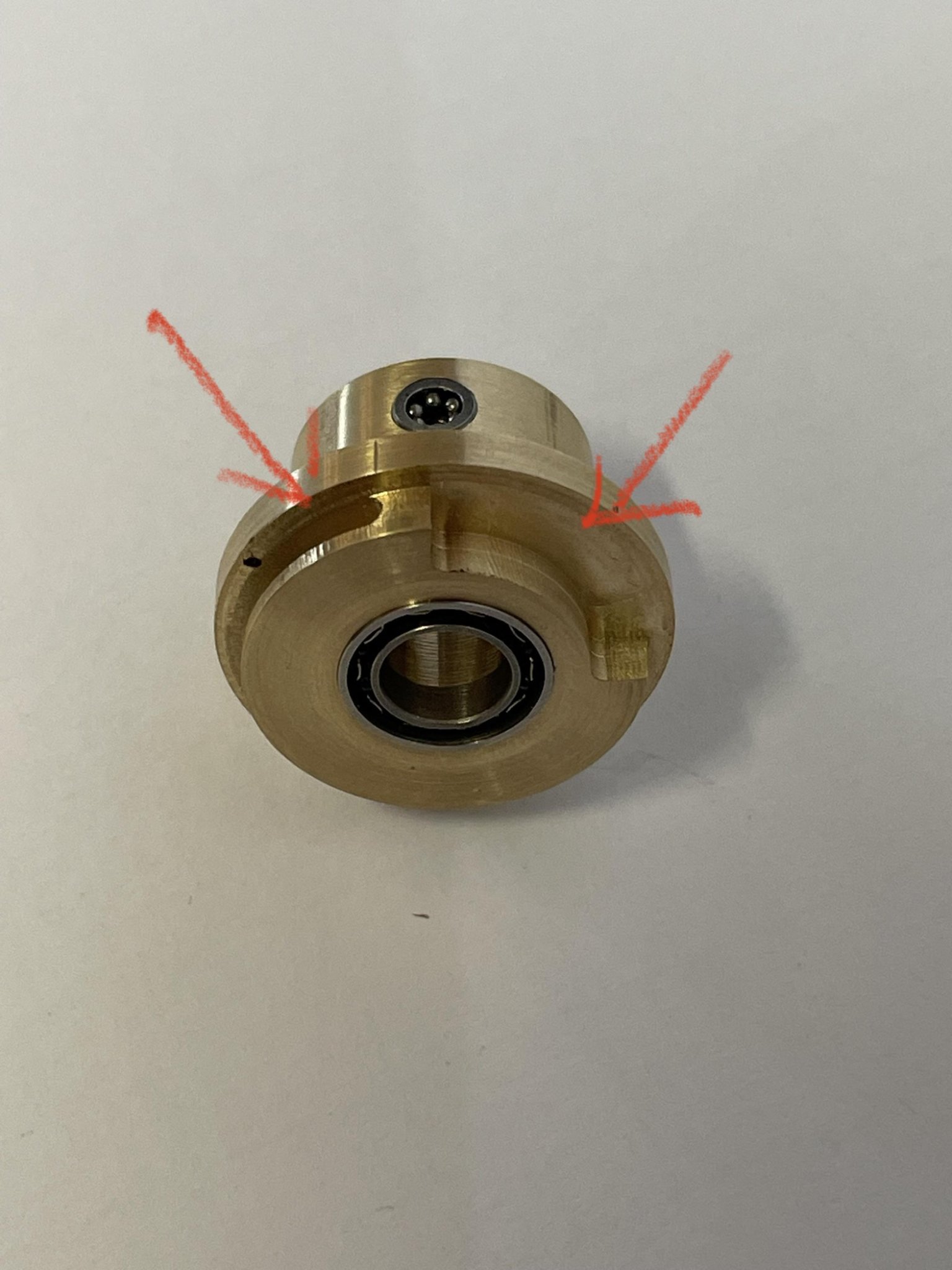

I was scratching my head trying to figure out how you did the channel and recess with stops along the circumference of the carrier.
Is your machine set up as an all in one that allows you to hold work in the lathe headstock and rotate itwhile milling from above?…or perhaps you used a rotary table in the mill somehow?…still the channel has a dead end 🤔
Always trying to learn 😉
hi,yes the lathe has the option to mount the milling machine on the side,the little milling bed is attached to the lathe carcarriage,little jobs like tonearm parts are about its limit as its prone to vibration not having its own table/stand.
i have a rotary table and did the groove with the table mounted upright and then switched it to horizontal to do the stops.

A separate milling machine and a rotary table with chuck is more versatile on either a turret or standalone mill if funds and space are not an issue. I have a Colchester Master 6.5 and a King Rich KRV3000 turret mill with DRO and both of these are capable of holding microns. The DRO allows very accurate PCD holes to be drilled to mate parts. The Colchester is 1967 but can still turn shafts parallel to better than 0.05mm over 300mm.
new improved bearing post made today in en8 steel, much more rigid than the brass one.
it was very hard to get a good finish,in the end i used an insert for aluminium and that did the trick,wet and dry paper did the rest.
