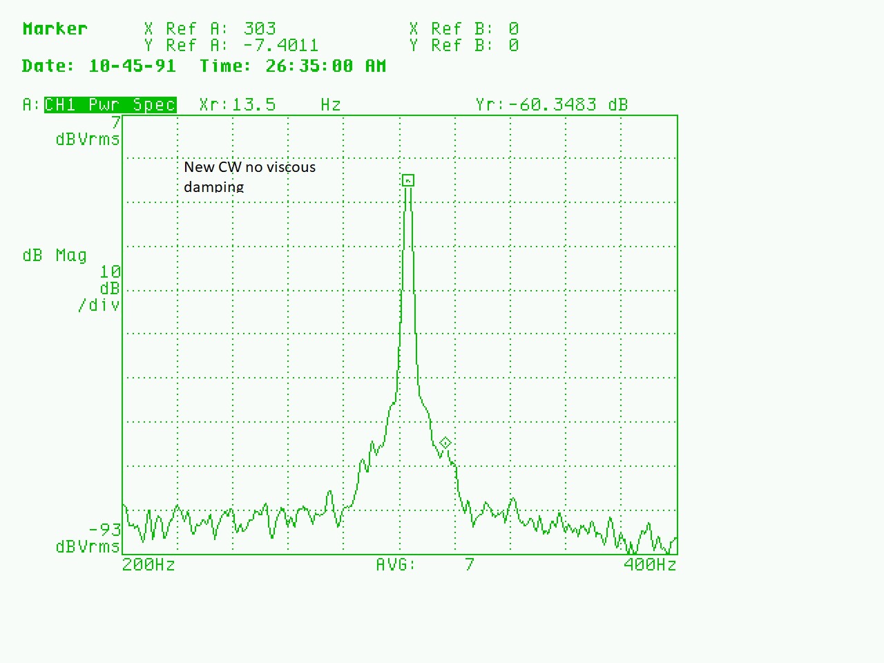

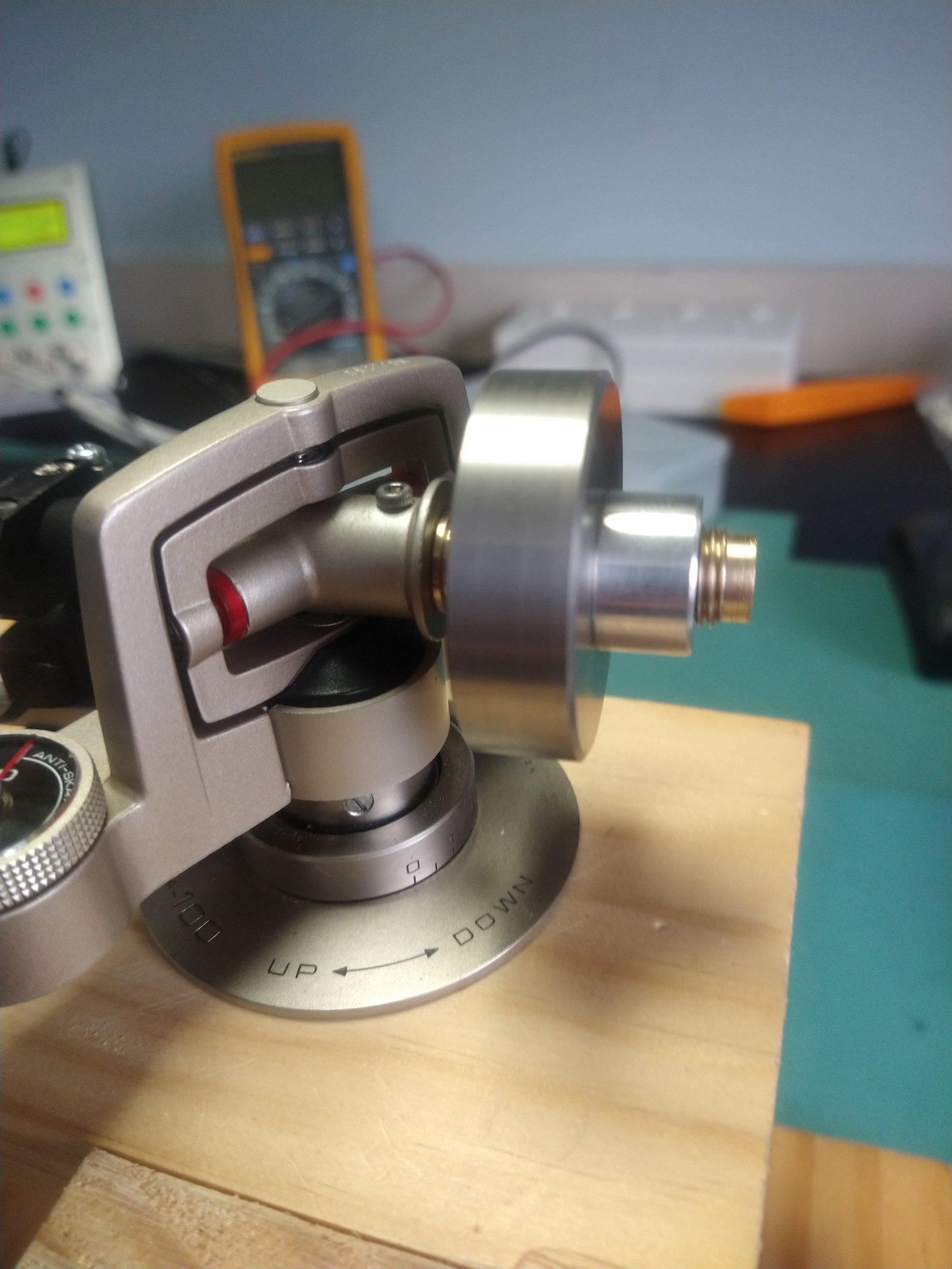

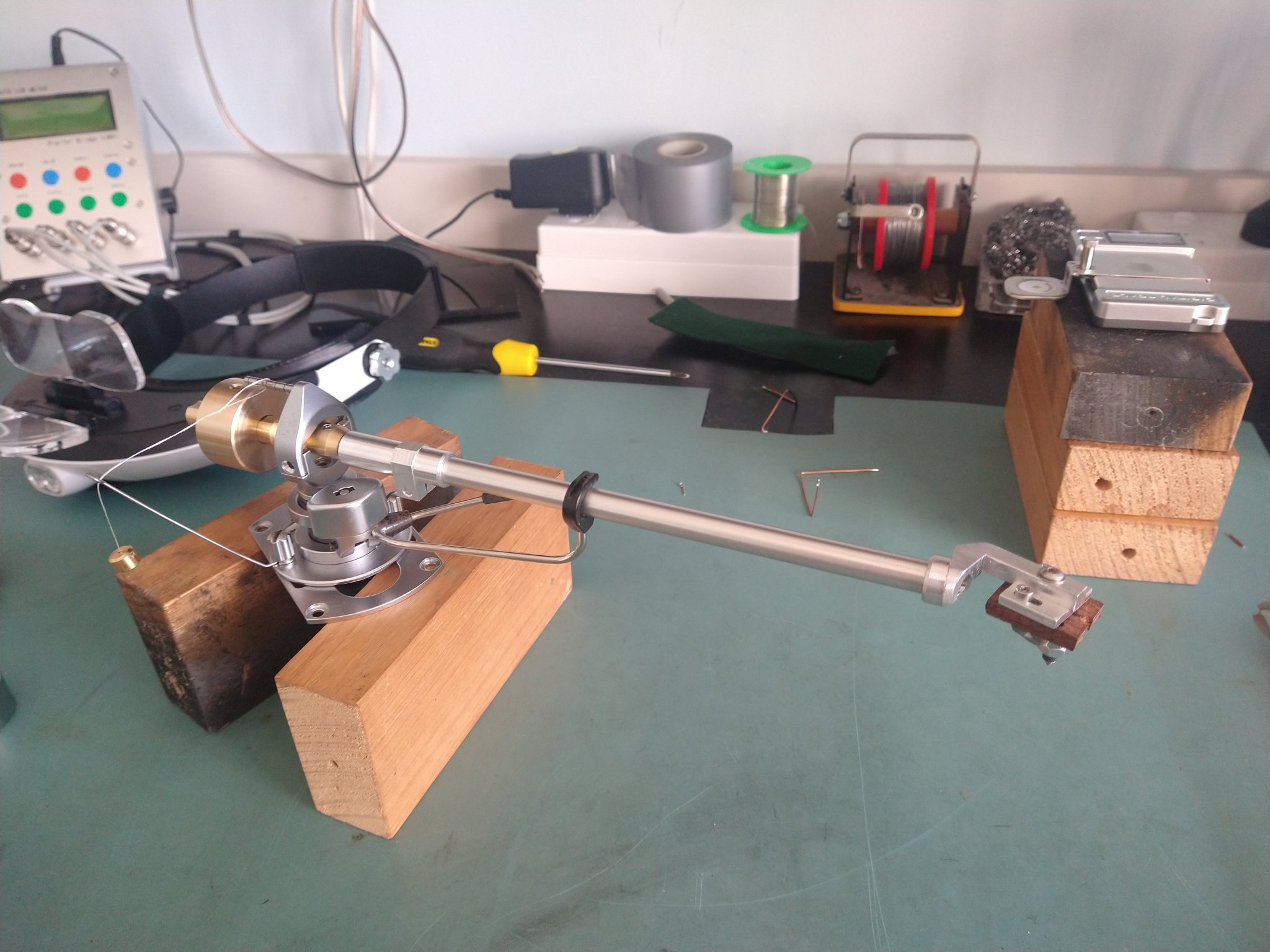

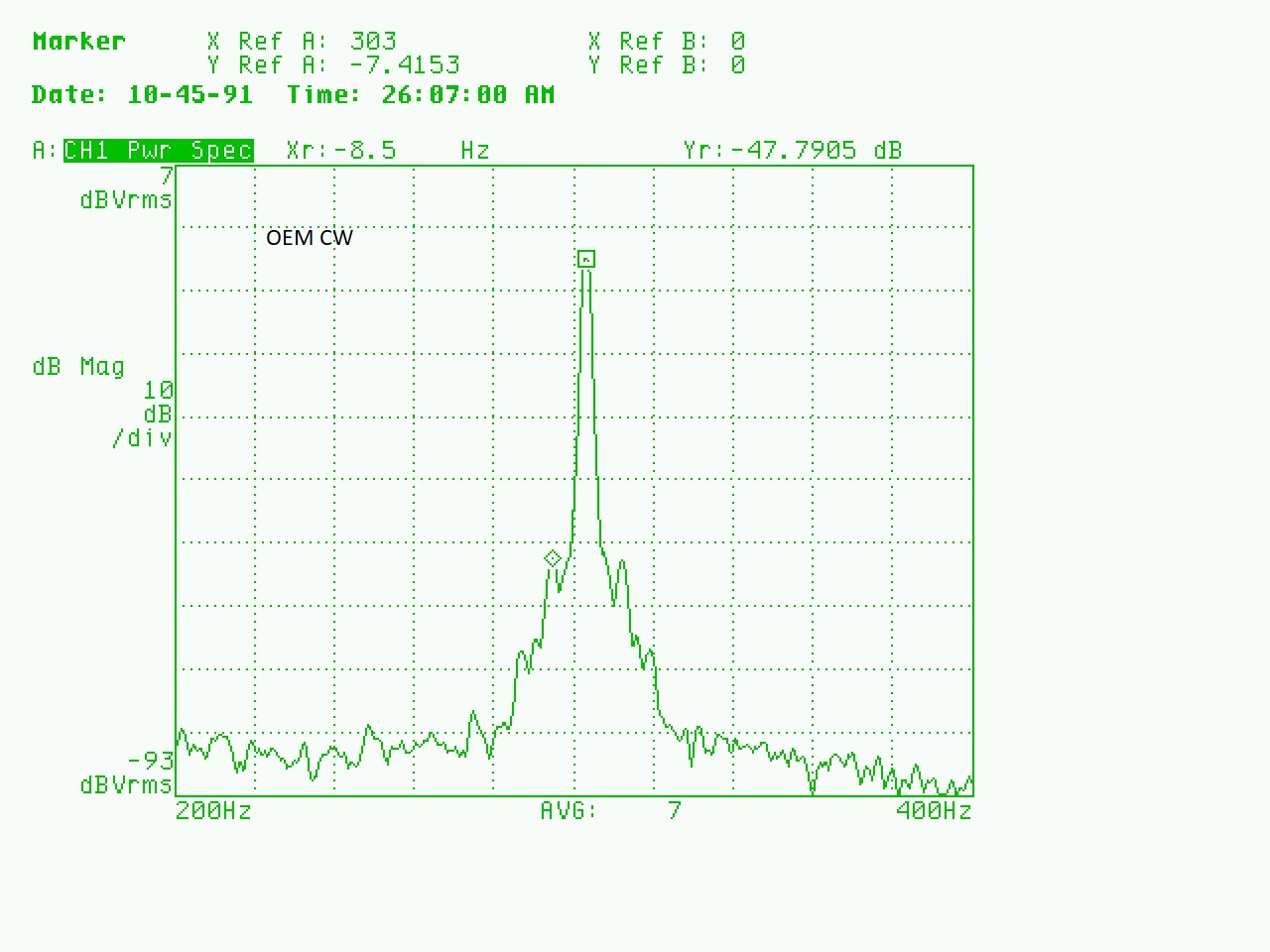

Can I make a suggestion to improve the arm further and it involves making a new rigid counterweight stub with a CW that locks to the stub.
I did this upgrade on my EPA100 and made a huge improvement in detail retrieval.
The 2 plots are before and after measurements with the OEM CW and new setup as in the below pic. CW stub is M12-1.5 brass and the main CW is 316 stainless with either a brass or aluminium locking ring depending on cartridge weight.
That could be am option although the C/W stub is very different to the Technics one. Cheers for the tip though,if i can implement it i will.

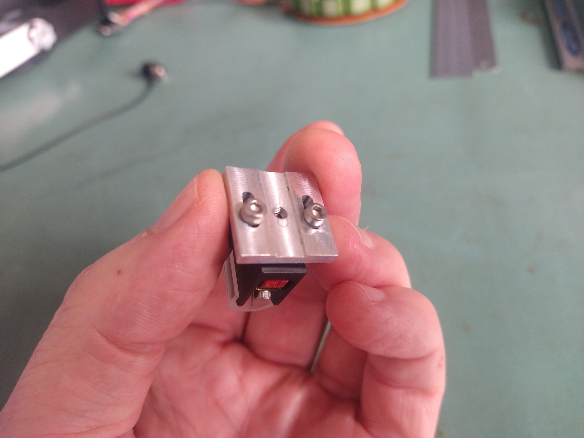

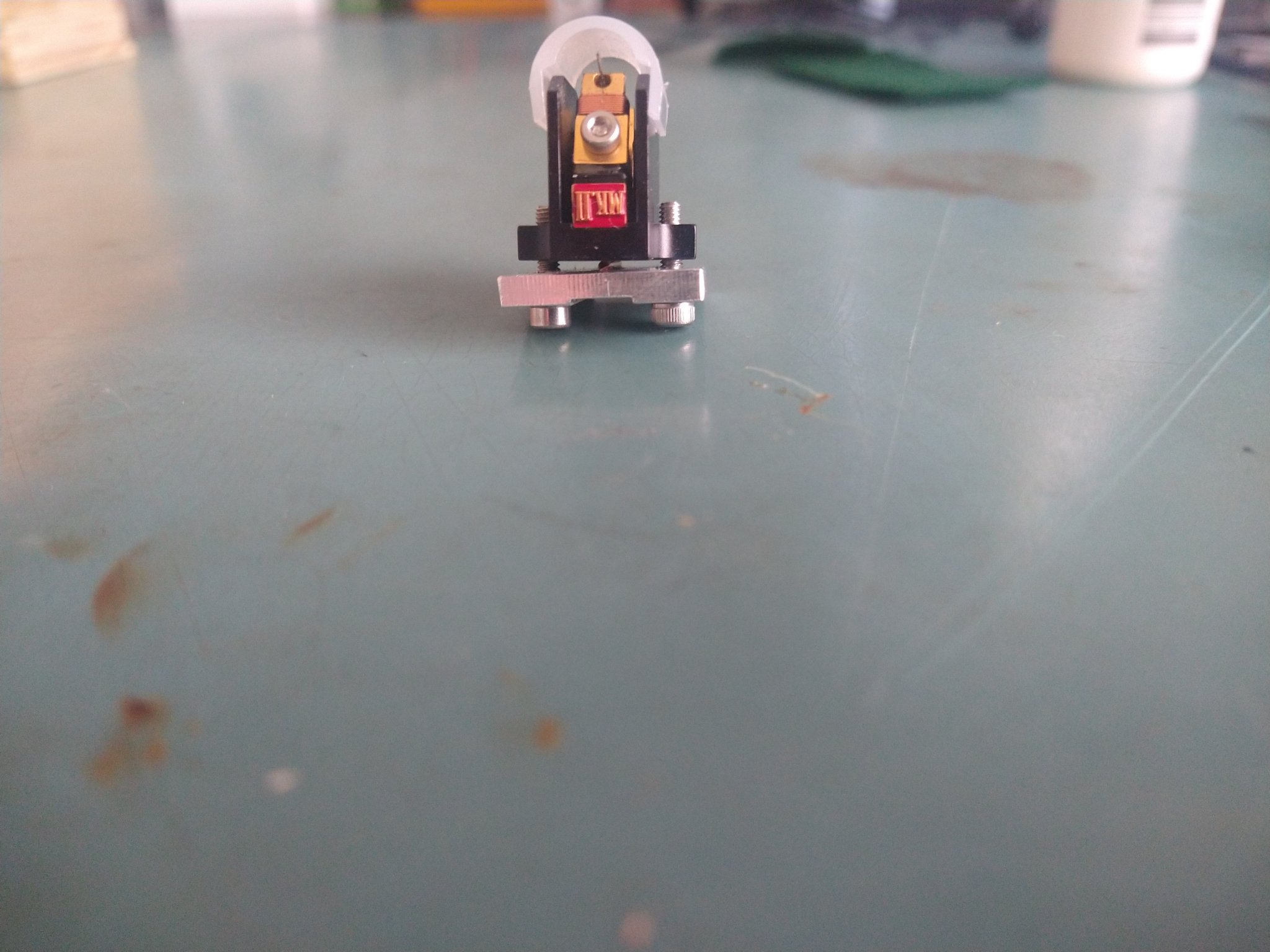

Got to thinking about the HS. If you changed the setup and machined the HS in one piece similar to pic 1 then made carrier plates you would have the same rigidity and facilitate easy swapping of cartridges. Mine is bolted to the arm but you could make yours so it slipped into the wand like the bit already made.
Yours doesn't need the offset that mine has. My HS carrier is 6mm wide and there is a 6mm wide channel in the plates 0.5mm deep so the plate does not swivel on the HS carrier. The front hole in the HS carrier is just to reduce weight.
Once a cartridge is setup in the plate it can be removed and replaced without the need to re-align.

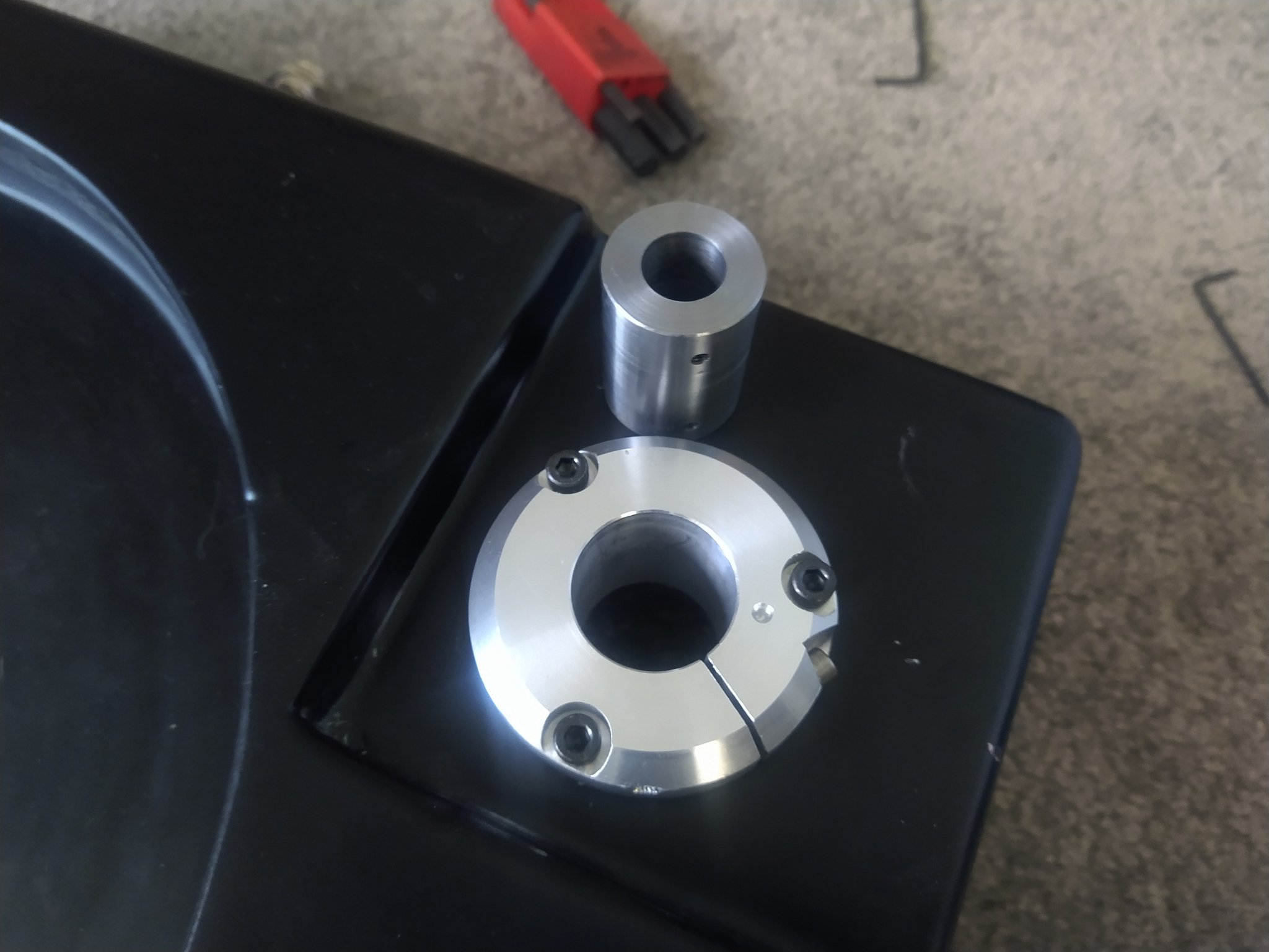

The screw holding a post is a common method of securing the post. IMO this is inadequate for a high performance tonearm. My improved EPA-100 base has a split collet that locks the post rigidly. VTA is adjusted with an M3 bolt.
Second pic is the first iteration without the additional post sleeve. Second pic is the latest with a 30mm sleeve over the OEM post.

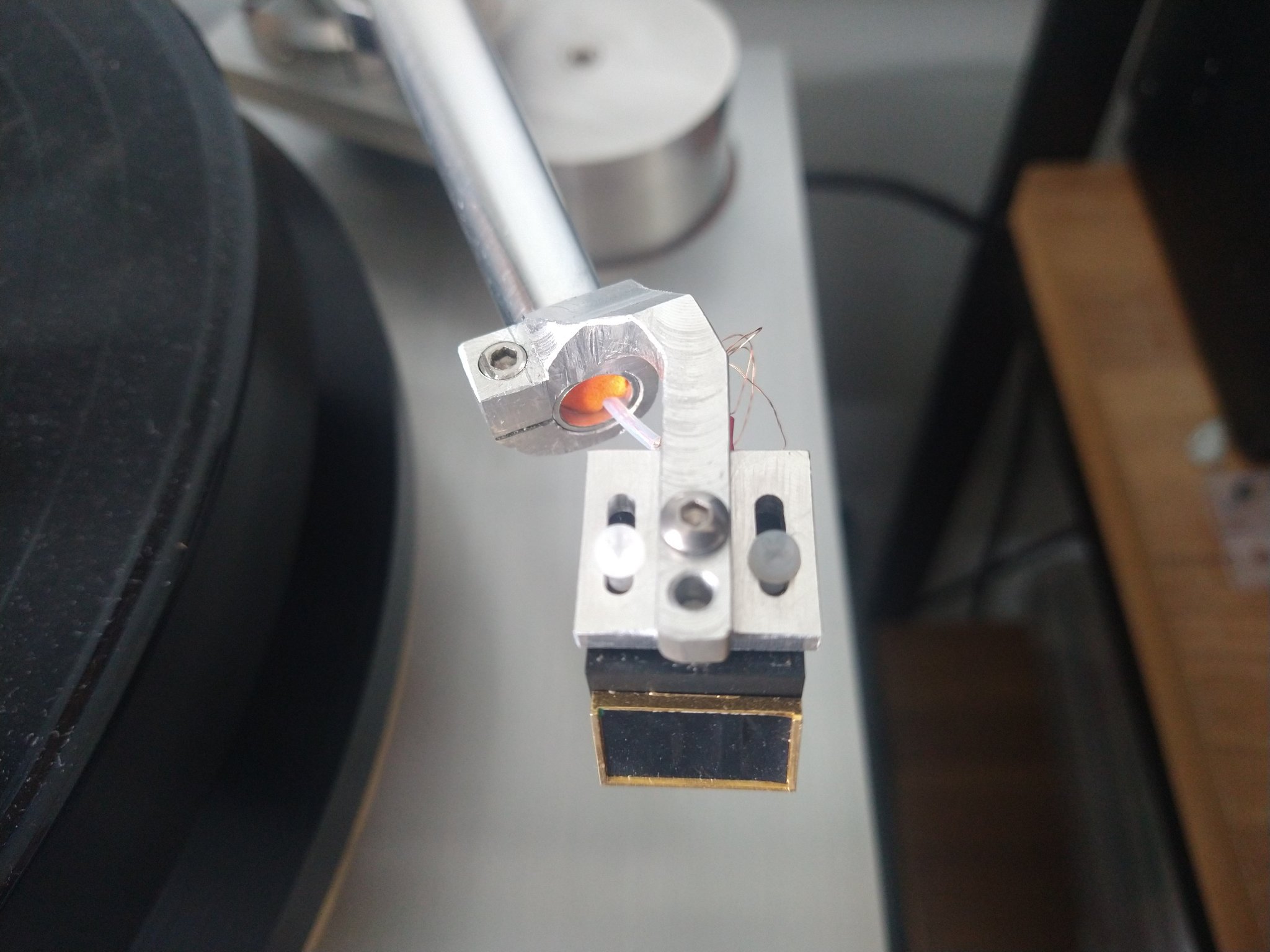

To adjust azimuth I use a bit of 1mm copper wire between the HS and cartridge then use the cart mounting screws to adjust azimuth. All of my cartridges use line contact styli and I have found especially with the MicoRidge azimuth is important.
You can see the wire and the CW rotation of an original Dynavector MC is obvious. Azimuth on this was set with a spectrum analyser.
