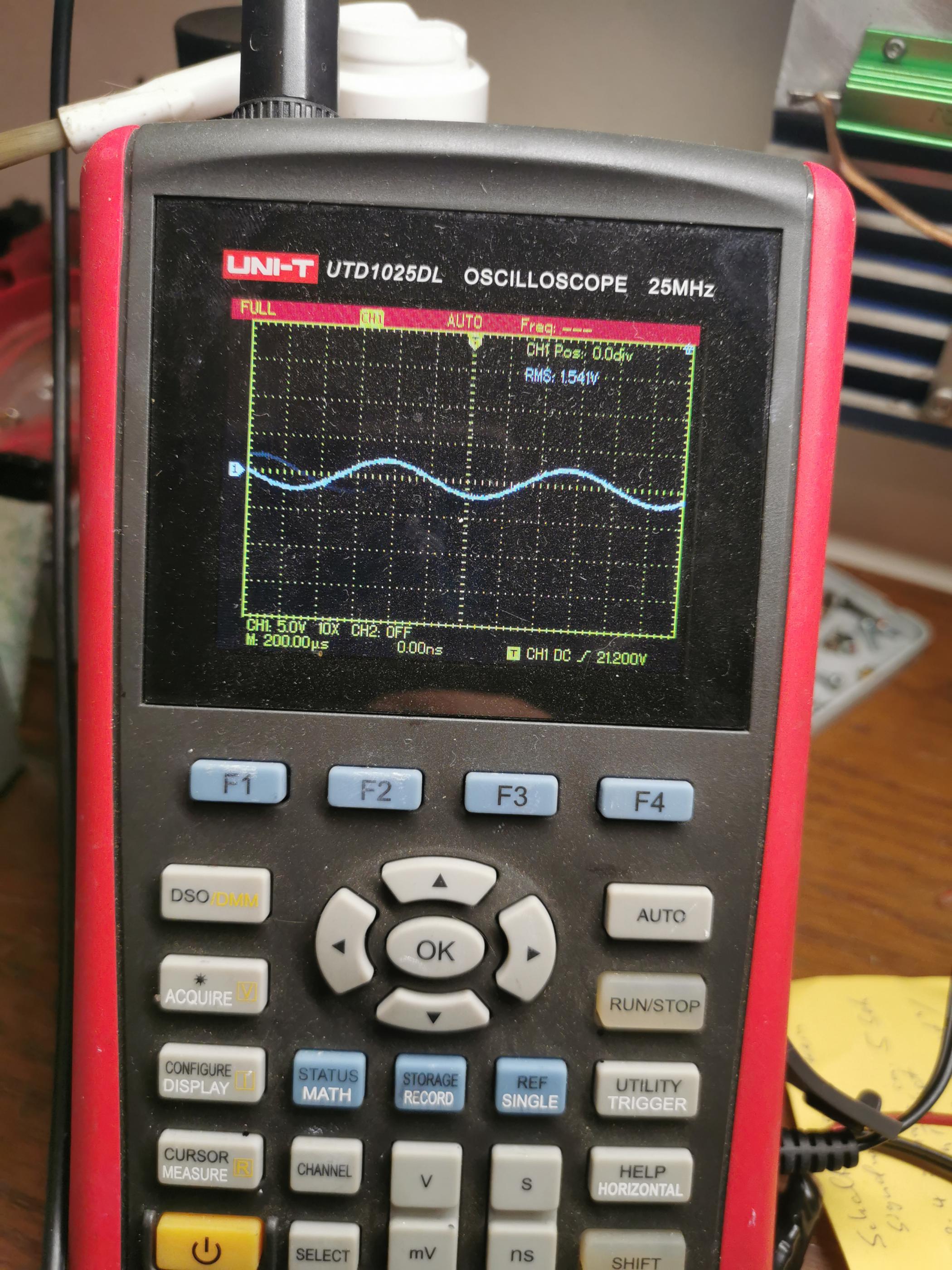

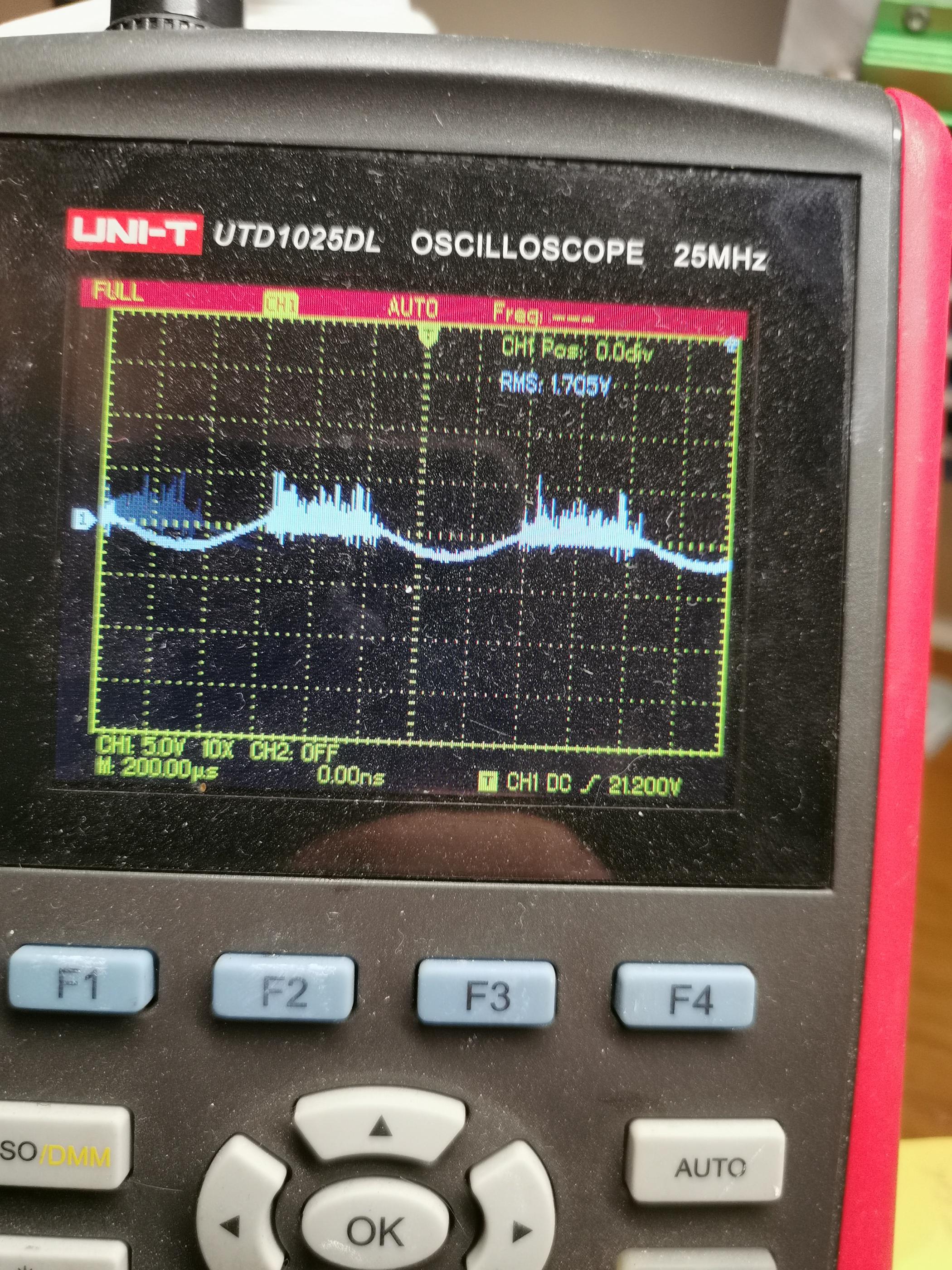

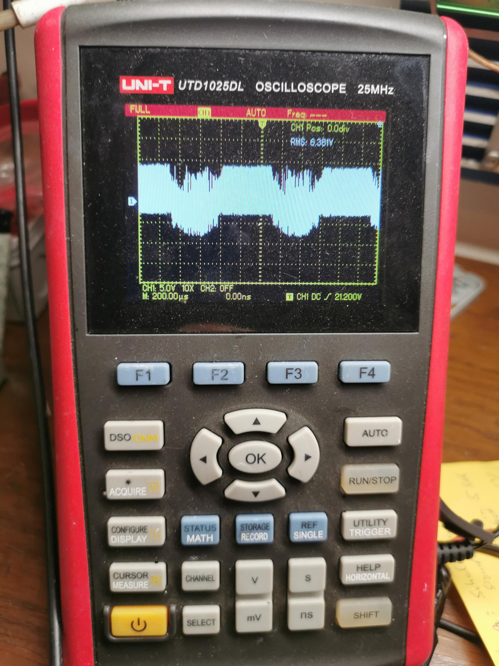

In the diagram I posted, you should only expect to see clean audio up to the terminal of R26 that is connected to C23.
Is audio clean up to that point in every channel?
Beyond that, up to the speaker terminals, you're in the feedback loop and the signal doesn't have to look clean to be OK.
It's on booth channels.

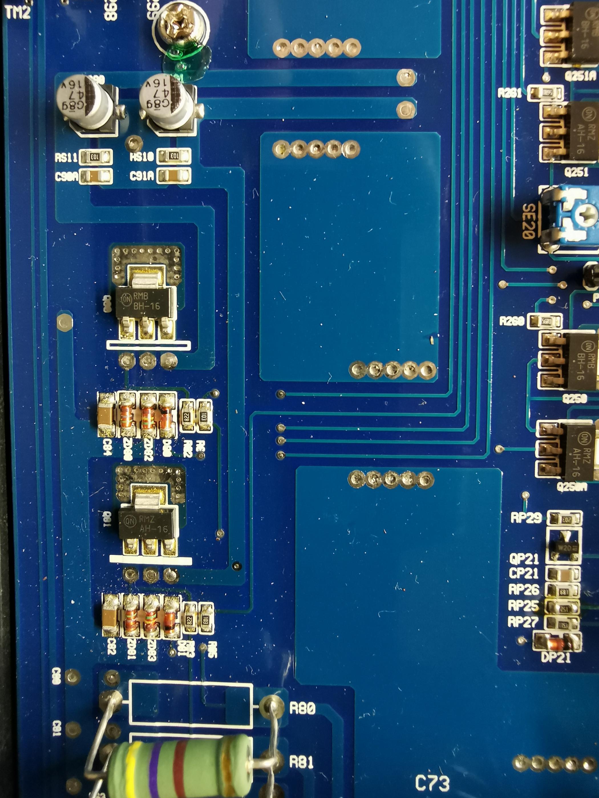

Iam not shure if iam wrong. I checked again the voltage from the bias op amp. If i use secondary center for ground, i have at pin 4 3V and Pin 8 3.2V.
I have two Zener with 6.2V. Each has 6,2V across. So maybe the something is wrong with the positive Side, and the op amp should have 12.4V Across pin 4 and 8...
The left Zener produce the voltage for the pre amp circuit. About 32V , 16V per Zener
The right Zener are for bias .I measure across each Zener 6.2V. .. So maybe there is my problem. The diagram i have from the other amp, doesnt fit to this amp..

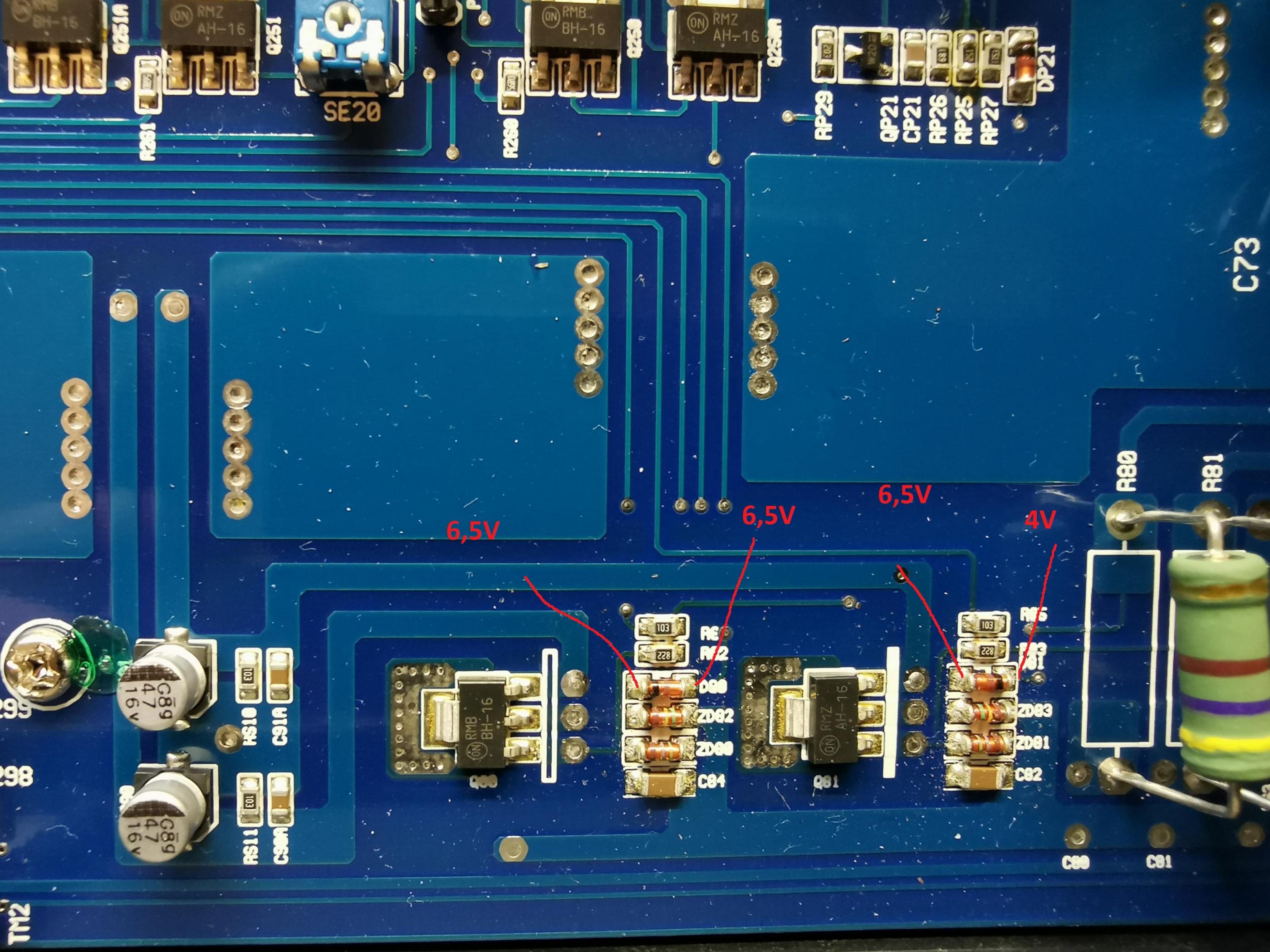

so, here is the problem. the voltage, measured on the left diode, is 6.5V.
if i measure on the cathode, which is connected over a resistor to the transistor, the amp imidiately goes in protect.
The right diode shows 6,5v and 4V, so maybe something is pulling the voltage down.
