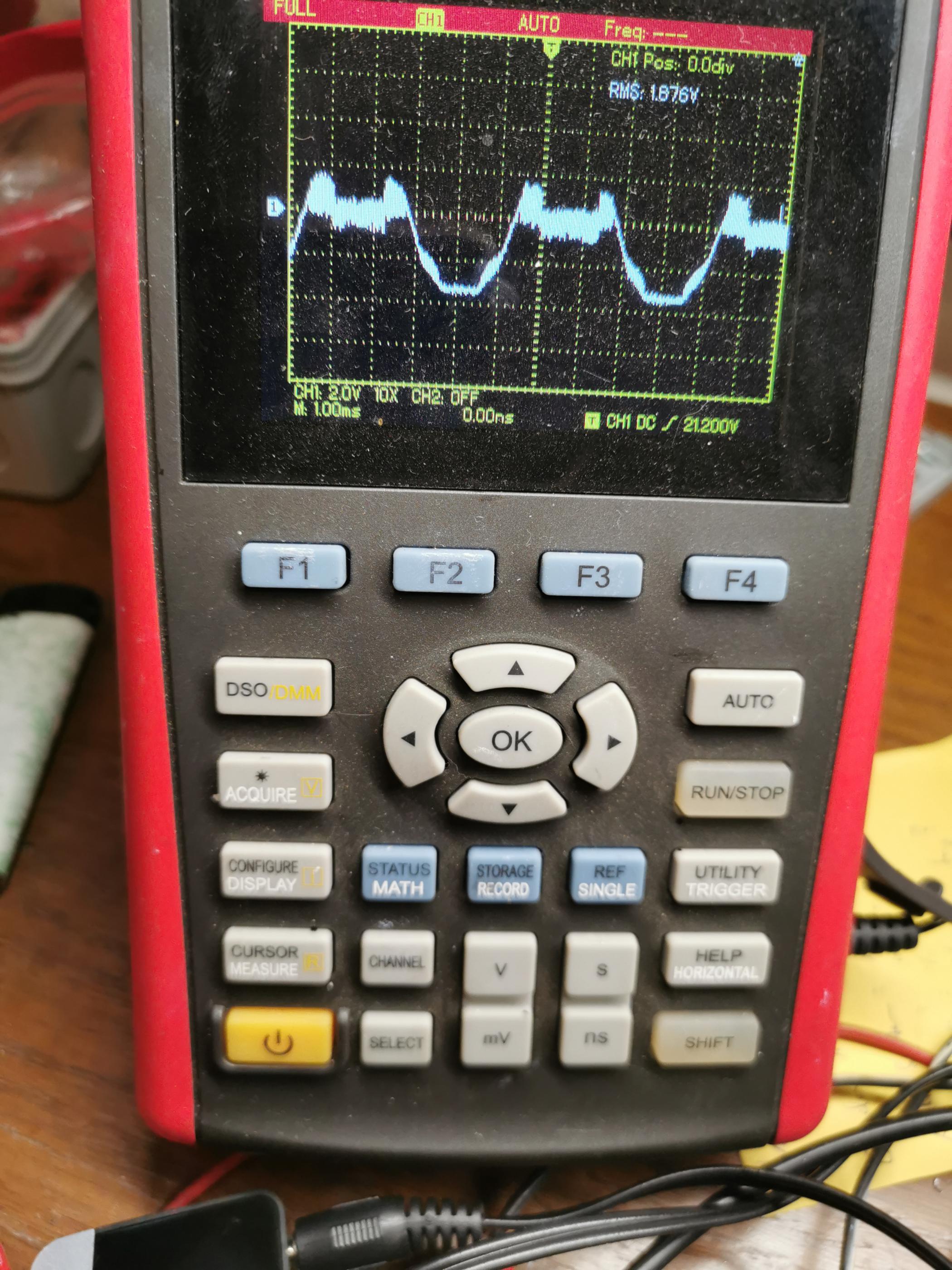

the mosfets for positive and for negativ become a signal, but only the lower half of the waveform is produced.

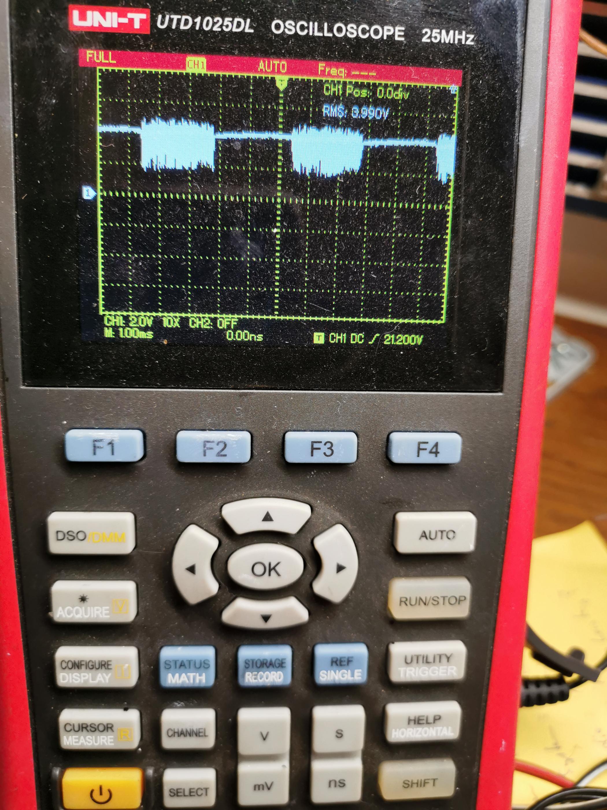

The input is allready the upper half noisy.

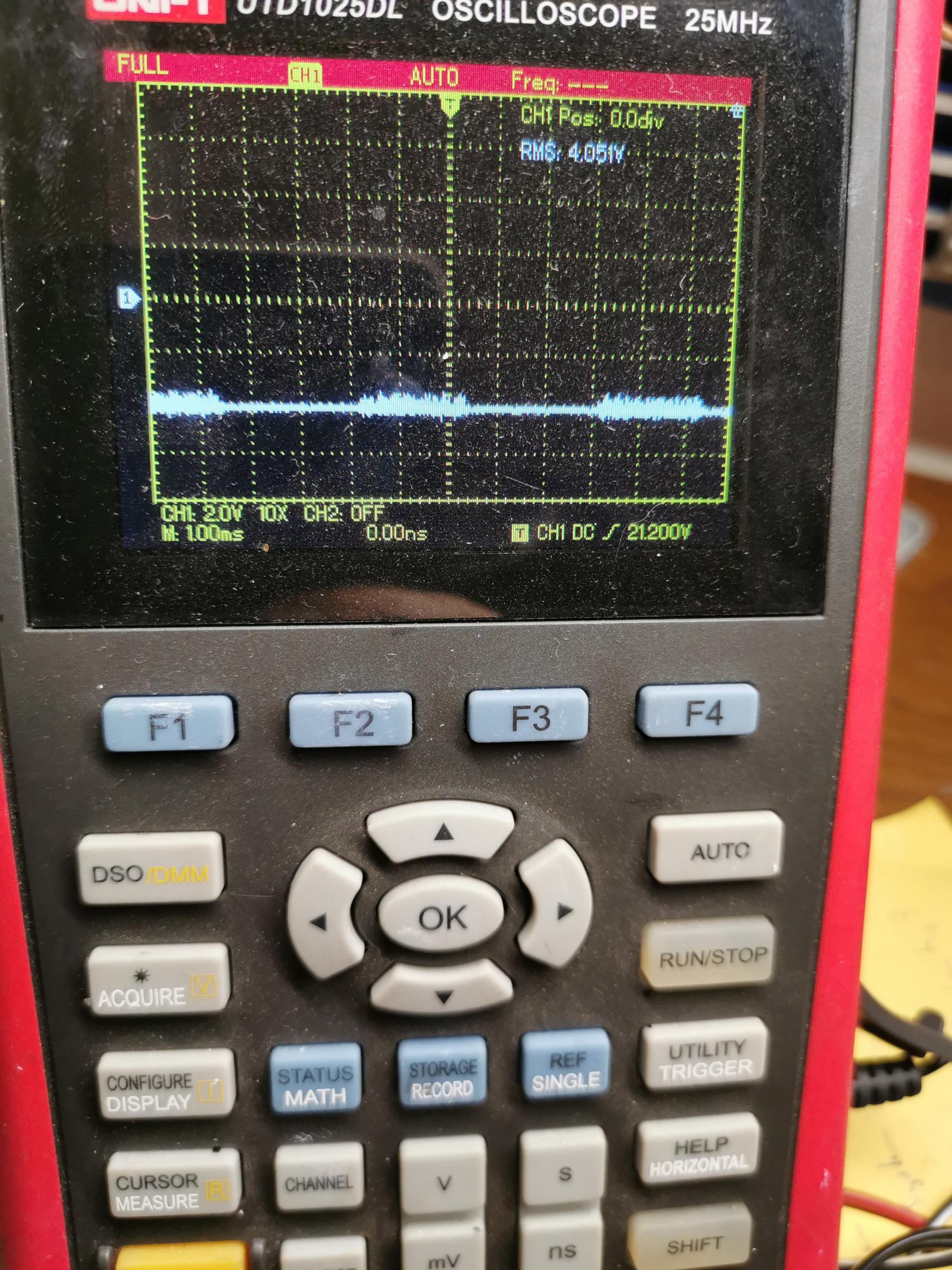

Back to the beginning. The input is allready noisy at the first cap at the rca jacket. If i use the other channel, its clean.
If i connect the load to the other channel, it has the same effect. Upper half missing, and allready at the cap from rca noisy input.

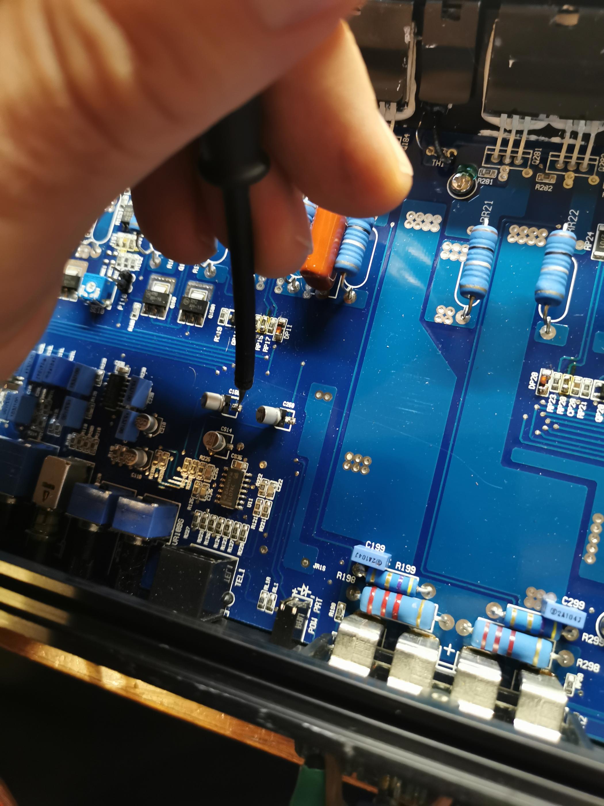

FOUND IT........... Removed the muting transistor... now i have a clean signal.
Changed with new transistor, same again. But the problem comes from the mute circuit...
