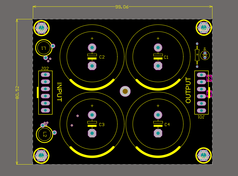

If possible, I would love to know the dimensions of the capacitor PCB - 70x100mm? The height of the ELNA Capacitors - 50mm?
Much appreciated!
The dimensions are 10CM * 8.5CM and the capacitor height is 5CM + 1.6mm PCB thickness + PCB standoffs 3mm

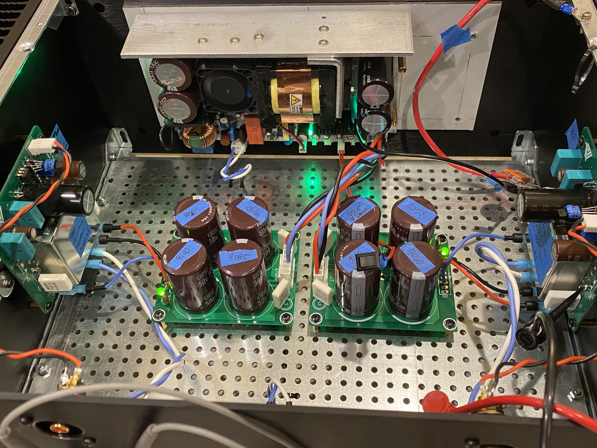

If you have the chassis space, use a cap board for each FH9HVX channel. Keep the total capacitance within the range Sami recommends. You’ll have a quasi dual mono supply. 😉
Here’s a pic as an example of my M2 clone amp, four 10,000uF caps per board.

Hmm interesting. Vunce, you don't have issues with the SMPS630-G going into overcurrent protection with 40,000uF per rail? The SMPS630-G manual says not to use more than 12,000uF per rail (24,000uf total) of additional capacitance.

You can use 6800uF with less height if that makes any difference.
I have a small chassis in stock, I will check tomorrow if the SMPS with the capacitors PCB fits inside it.
I will send you all items needed to complete the assembly for the capacitors PCB.
