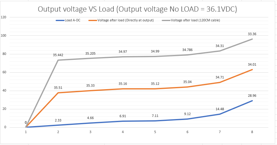

Very good question.
I don't have a chart with output voltage VS load.
But I can conduct some tests when I have some time and post it here.
But let me give you an example, as below from another SMPS (Unregulated)
As you can see, 1.39VDC drop at 14.48A
Thats a diffrent SMPS version.
I am currently building a +-40VDC unit, I will post the graph in a few days

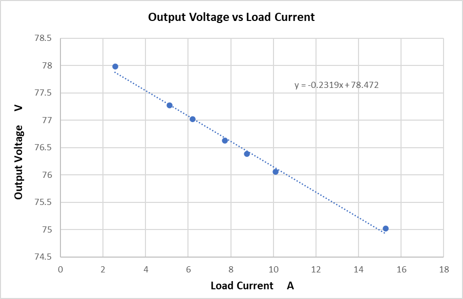

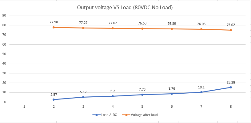

Yes, correct for the SMPS1K-PFCR2Yes, but you said yourself in post #284 9~10V drop at full load.
Not ?
Patrick
I dont understand your point
Should be very grateful if you could show us a plot of output voltage vs output current for the SMPS1K-PFCR2 & COBRA-S1 & COBRA-S2.
Patrick
Patrick
Patrick
I will do that once I understand why you want it?
That's an unregulated SMPS and voltage drop is there.
I feel that you are here to disturb my thread for some reason.
No sir, I have no plans to use any SMPS myself.
I am merely trying to understand how I should read SMPS specifications.
Let's say someone wants to use a SMPS for a Class AB amp, for example.
And the particular amplifier does not have great PSRR, any power supply modulation will affect performance.
So I think it is only reasonable for people to know what output impedance they can expect, regulated or not.
Take SMPS1k +/-55V for example.
Full load at 1200W means a touch over 10A at full load.
If the output voltage then drops by 10V, that means a PS output impedance of 1R.
Which the amplifier designer would need to know to see how he will deal with that.
Or whether he should choose some other power supply.
Or he should allow for the 10V drop and put a 45V regulator downstream.
It is not unreasonable to ask for information, don't you agree ?
