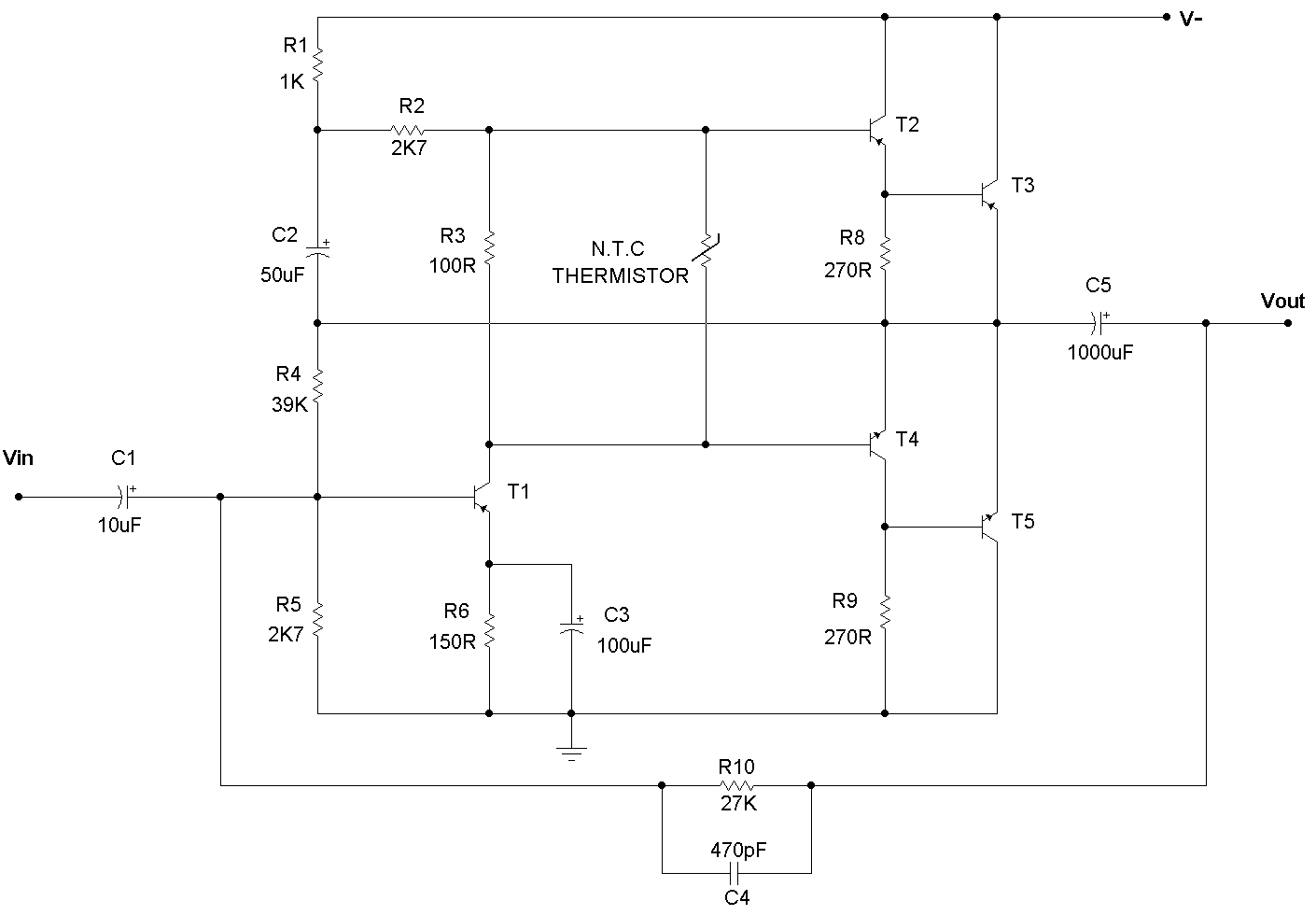

The Lin topology hasn't got an LTP.
LTP version is sometimes called modified Lin . My friend Ijaz lived in his town . I wished I had known . Maybe we could have visited him . So stupid I should be there and he was a few doors away .

The topology discussed by D. Self in his book bears no resemblance to Lin's topology. The latter is a single gain stage design, while Self's is a double gain stage design that is due, in fact, to Thompson.
I use VAS in my books just because it colloquially implies what the stage does better than TIS does.
That is unfortunate, really, as "VAS" does not in any way describe what the stage does.
What the second stage in the Thompson topology analysed by D.self does, in fact, is take a current from the input, transadmittance, stage and deliver a voltage at its output. It is, therefore, a transimpedance stage, or TIS.
This is the nearest you will ever get to a H C Lin circuit . How so ? When Harold Leak was accused of steeling the Tobey and Dinsdale design he is reported to have said it was they who should say sorry to HC Lin . I think there is some truth in that .
The last Leak designs grafted on a LTP . Hence modified Lin . The rest is history and the Sinclair Z30 comes into it somewhere ( and RCA as was Naim ) . The Gogny of 1967 also .

The Lin was simply a common emitter stage driving a unity gain output stage (see figure below); nothing at all to do with the two stage design pioneered by Thompson, which consisted of an LTP transadmittance stage driving a transimpedance stage which in turn drives the unity gain output stage.
Sometimes it is really hard to make simple points of fact on this forum.
Point taken . I never found a real life amp that had the circuit . I am sure some existed with famous names ? This was one I thought qualified as something like .

The Gogny is the oldest design I know of that resembles the generic design . I will look out for this modified Lin statement again . He was involved in early op amp design . It is just possible he is the originator ?

The 1970 Sinclair . Perhaps the missing link ? In the old money at 89/6 d ( £ [ 89.5 x 5] /100 ) . A TDA 2050 kit costs about the same today ( $7) , perhaps $70 to 100 now money . Said to have inspired both Naim and Arcam . People fitted 3055's as the outputs were fragile . Some modern outputs might get them to work well . 3055 was a lot slower than the Sinclair devices I beleive ? Naim used BDY56 . I think some will say the Brits liked this design the most . The RCA which it is said to be based on looks different . I would say the book has it's origins here with Sinclair ? One could be forgiven for saying we have been talking about it for 43 years ? I do seem to remember the RCA of circa 1968 was connected with Mr Lin ?
The Naim is not the same by a mile . It is more like the Sinclair than the RCA some say it copied . Rumour has it as a design by Alan Mornington West and might have run along side the Quad 405 ? Rejected and became a Naim .
The Gogny was for driving a ribbon drive unit I think ? 50 watts into 0.8R if memory is correct ? The fuses serve as emitter resistors in the text ( again if memory is correct ) ?
