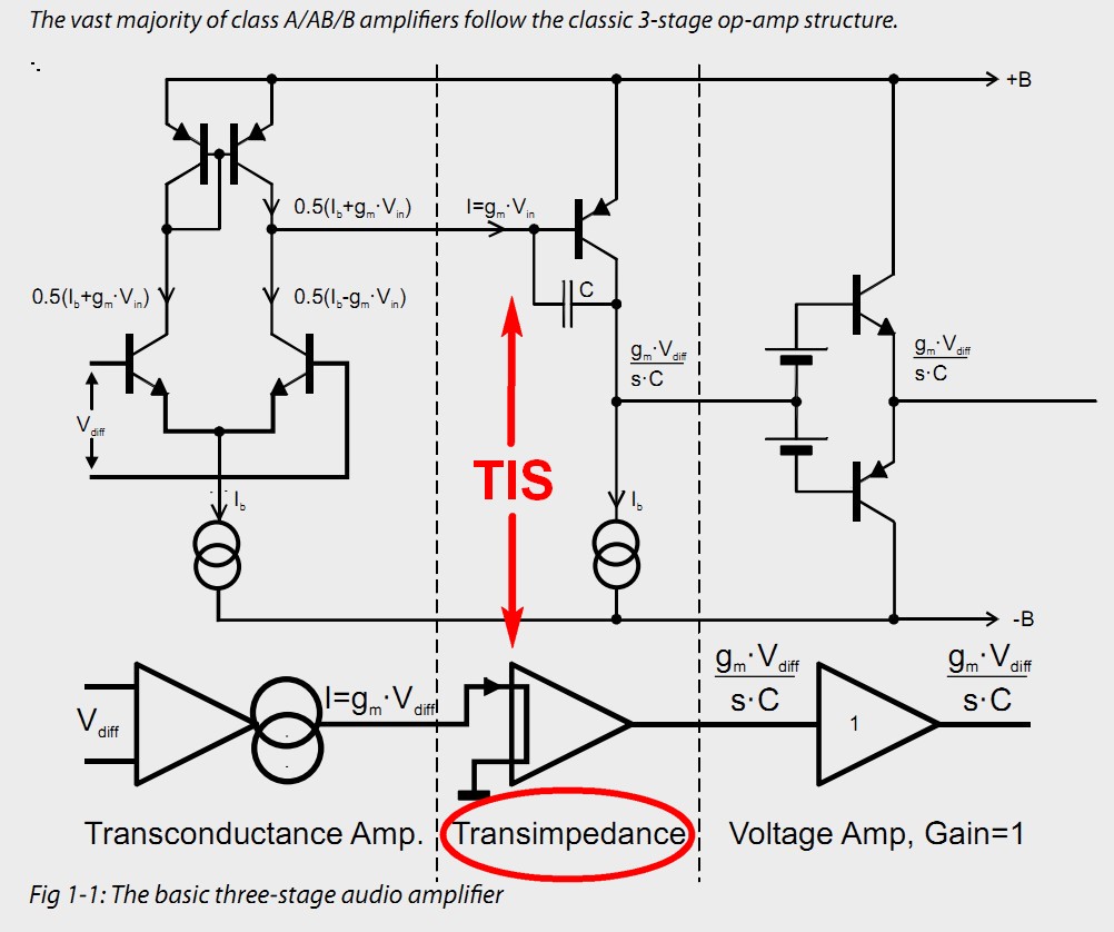

Only snag is it isn't a "VAS"; it is, in fact, a transimpedance stage (TIS).
If it doesn't embarrass Mr Self it is the only book that gives us a standard to work from . It even gives us a common language . I use VAS as that's how the book says it ....
Maybe you don't care what Mike called it, but also Bruno Putzeys calls it a transimpedance stage:
I'm a beginner at this, but how did a VAS become a TIS ?
In the LIN (spelling ?) topology the LTP produces a changing current at the collector of both devices. The collector of interest has a resistor in series with it. This resistor converts the current signal to a voltage signal. The voltage signal drives the VAS transistor and the VAS transistor produces a fluctuating current at it's collector. The VAS load is a high impedance and it converts the current to a voltage. So from my understanding - transistors/FETs/Valves take a voltage at their control inputs and produce a changing current at their outputs. But when you include the load, their outputs become voltages again. I always include a load in my definition of the 'stage'. A VAS is a VAS is a VAS.

Bigun: "TIS" is the traditional term for "transimpedance stage", and precedes the use of "VAS". However, I have older texts that refer to the stage as the voltage amplifier, it was just not formalised that way until later.
"VAS" is as far as I know Doug Self's invention, and it does describe what the stage does overall inasmuch as it produces the full voltage swing required by the output stage (at least in LIN and similar designs).
I use VAS in my books just because it colloquially implies what the stage does better than TIS does. My opinion only, and as respect to Doug who's influence is far more reaching than many here may wish to recognise.
