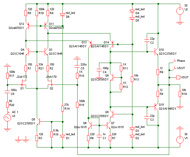

Luxman preamp C02 circa 1983 , at least for the topology.
What about the compensation capacitor "Cdom"?
Shouldn't we call it "Ccomp" ?![]()
We could call it Douglas . It is only right .
The only snag is shunt compensation to ground increases the non-linearity of the stage it compensates.
Don't see that in practice, or I'm not sure what you mean. All else being equal the input error signal is identicle, and without the symmetry you can't recapture the base current error of the second stage (in the two stage case) without a Hawksford cascode or equivalent.
I have built discrete single stage amps with vanishingly low THD (Ccomp to ground).
Not even close, that's an ordinary folded cascode tied to V- on the output side. The term and patents appear well prior to the 1983 date.
Where did i say that there was no prior art.?.
The question was about a discrete design , indeed.
To say that it s not close is somewhat exagerated.

Ok. With GNF it's a TIS and if a ZGNF it's a VAS. I can sort of live with that.
But, that pesky Cdom, even with ZGNF still seems to me to be a TIS . . .
You usually don't need a Cdom in a ZGNF amp, since the (so called VAS) Trans Impedance Stage (TIS) is loaded by a R, but as you say it is still a TIS.
Yes, on reflection you are right. But who in there right mind operates an amp without feedback. Nuts. 😀
