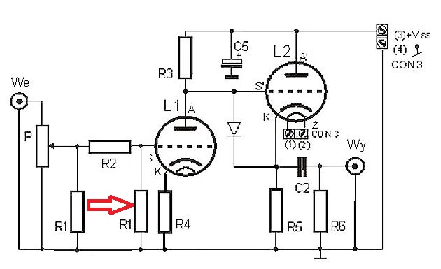

the operating point aspect may be easier to grasp by starting at the output and working backwards. the output stage has a lot of current gain and slightly negative voltage gain. from the large k series resistance we can infer that the designer has assumed that the load will be hi-z. the output stage will present an even higher-z to the previous one. thus the previous stage will not need to source much current--nearly none. the allows for the use of both a reasonable plate supply voltage and a large anode resistor which behaves more nearly like a current source than a lower value would thus improving linearity. the high bias point allows for a reasonable anode supply voltage despite the large anode resistor. of course if the operating point is pushed too low (ie: even higher negative bias) linearity will degrade. so what we have here is the designer finding the sweet spot where he can exploit the cathode follower and its assumed high-z load to present an extremely light load to the previous stage and that allows him to pick an operating point that is very favorable in terms of linearity while keeping the plate supply voltage within reason. paralleling lowers the characteristic internal plate resistance of each stage which furthers the designer goal of making the anode feed closer to current source behavior. IMHO it is all very clever. the more traditional approach isn't all bad, however. all this hi-z, low current stuff has its price in terms of not supporting ill-mannered loads too well and increased sensitivity to external noise sources. both because of that aspect and the low PSRR of a pure single-ended design, this circuit will be quite sensitive to weaknesses in the PSU.
Now armed with all this it is easy to see that the 6922 design a few posts back is not really an AN7 clone. It's actually a good and relatively standard-design 6922 setup (except for the diode which would be replaced with a shunt neon bulb or removed as made needless by dint of a PSU soft start). see, e.g.: http://www.augustica.com/designing-6922-cathode-follower-ezp-17
Now armed with all this it is easy to see that the 6922 design a few posts back is not really an AN7 clone. It's actually a good and relatively standard-design 6922 setup (...)
I never claimed that my approach is really a "clone", I only stated that is inspired by Kondo M7 and Klimo Merlin. And my setup isn't accidental, it allows me to drive almost any power amp, be it tube or solid state.
Schematics here:
P-100k black Alps
R1 - 820k
R2 - 1k
R3 - 8k2/2W
R4 - 150R
R5 - 15k/2W
R6 - 220k
C2 - 0,47uF Audyn True Copper
C5 - 47uF/250V
The diode function requires a commentary. This circuit suffers from the problem that on start up, the grid of second halve will immediately rise to HT potential while the cathode is still cold and tubes conducts no any current. It causes arcing between the electrodes, and rapid destruction of the valve. This problem can be easily resolved by connecting an ordinary rectifier diode (such as a 1N4007) between grid and cathode. At start up, this will keep the cathode within a few tens of volts of the grid. Once hot, the valve will bias with the cathode at a higher potential than the grid and the diode will be reverse biased, off. It will be present only as junction capacitance (few PF) between cathode and grid, wchich is negligible.

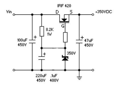

Simple mosfet regulated anode power supply:
(in my preamp zener diode is 180V, not 350V)

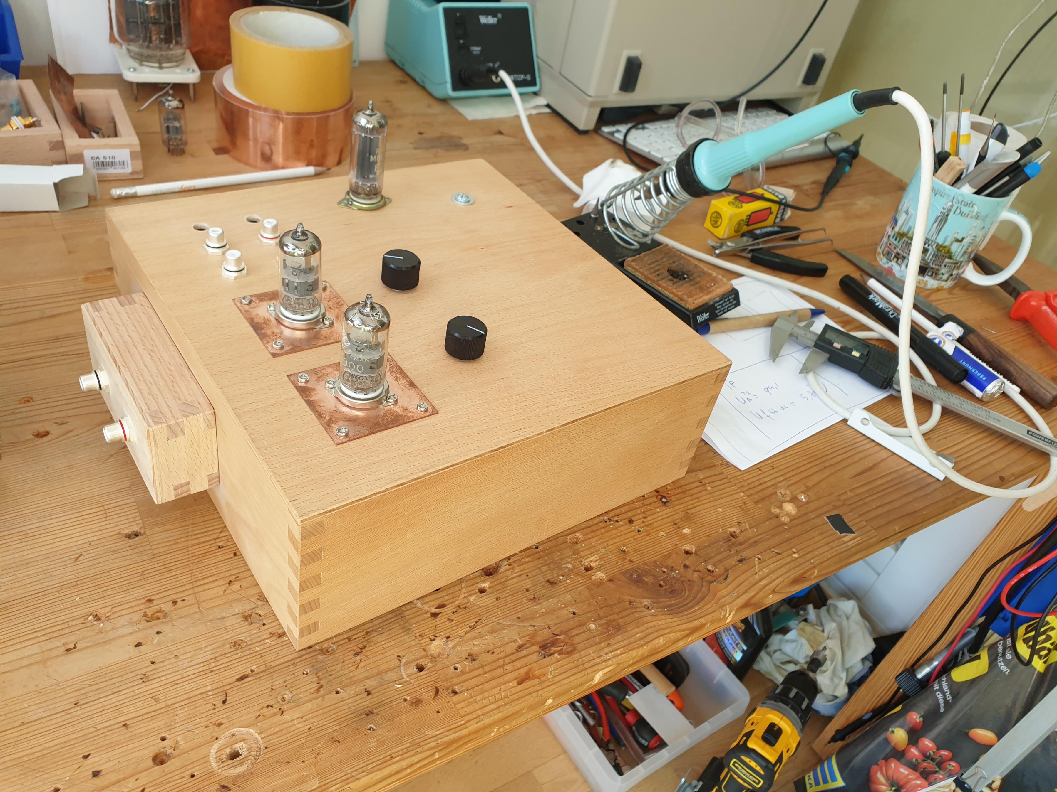

I'm currently building this setup with ecc2000 tubes.
I came across your post after googling the arcing issue I had 😉
I also discovered that this dc coupled Kfollower isn't really intended for audio but for Gitar as it seems to compress the upper wave of a sinus. I will digg into that a bit deeper.
Here are some photos of what I work on.

@McGyver
I wanted the edit my post as I had something more to say, but that didn't work.
First, thanks for sharing your design.
Second, I use same values for Ra and Rk2, I currently have a bias of 1.6V for both triodes.
May I ask why you choose for different Ra Rk2 values?
