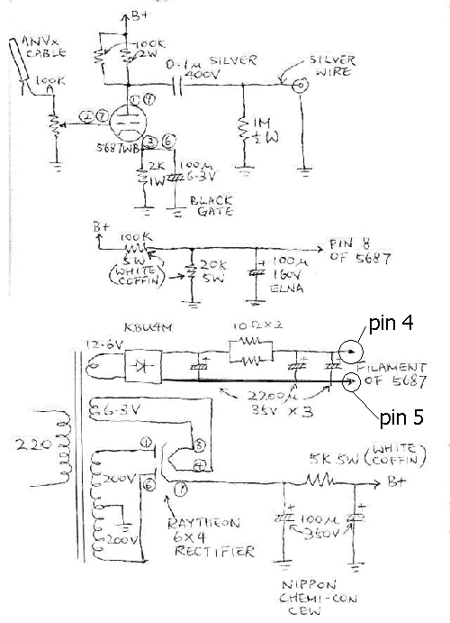

Toward the top of this thread is a schematic posted by Bee696 using a 5687. That's a great design, and very easy to implement. You might start there. Some depends on what you'll be driving w/the preamp. If it is a low Z in SS amp, a lower Z out preamp is likely needed. If you're driving most tube amps, output impedance of the pre isn't as critical. If you're driving a 100k input amp, and reasonable length interconnects, I'd suggest the 5687 without paralleling the two sections, as was shown in the bee696 schematic.

hi, i'm thinking about to build a pre according to the schematics posted here by Bee696.
Just one question to the tube gurus here: it's not very clear where to connect the rectified 12.6 V for the heater. Do i have to wire 1 end to pin 4 and the other to pin 5 of the tube? if i wire like it like this, i get on the heater vith the center tap at about 1/6 of V(B+) volts and
6.3 V + 1/6 V(B+) on pin 4 and 6.3 V + 1/6 V(B+) on pin 5???

Connect the 12.6 V to pin 4 and 5 and connect the bottom of the 100k (or the top of the 20k) of the voltage divider to pin 8. In this way your heater is 20/120 x B+ above ground (should be about 40 volts cause B+ is about 240V).
kor952 said:Connect the 12.6 V to pin 4 and 5 and connect the bottom of the 100k (or the top of the 20k) of the voltage divider to pin 8. In this way your heater is 20/120 x B+ above ground (should be about 40 volts cause B+ is about 240V).
I think you meant pin 9.
No, pin 8 is the heater centertap of a 5687, unlike most of the 12A?7 types that use pin 9 as heater centertap

but just to be sure that i understood right: is this right?
i mean: let's call A the upper node at the 12.6V, and B the lower node on the same line (A is the node between 2x10 ohm and + of the 2 2200 uF capacitors; B is the node at the - lead of the 3 2200uF capacitors )
A --> pin 4
B --> pin 5
B+ --> pin 8

A is OK, B is OK but pin 8 should not be connect directly to B+ but to where the schematic says 'PIN 8 of the 5687', this is the output of a voltage divider, the input of this voltage divider is connected to the B+.
As i am about to build a new preamp i have been browsing old threads for interesting clues and ideas.
I was quite surprised by the circuit bee696 posted. Why run a 5687 at such a low current? Signature AN sound? Very strange.
Indeed it is strange to run the 5687 at 230-240V (including Ra) with an Ia of about 2.75 mA. But I tried all kind of preamps last year 5687 with lineoutputtransformer Ia varying from 9-18mA, 417A with lopt, 26 and 27 with lopt, but I like this one very much. I use the single tube/channel version and not the two paralleled tubes version of the schematic you mention. The single tube version is from about 1994, the parallel version is younger. I also did built the M7 Tube with all 6072A tubes, this one also sounds very nice but has 6dB more gain. I am not the only one....an audio friend of mine also did built the M7 Line and he likes it very much. Be aware to choose high quality parts for best results.
