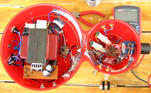

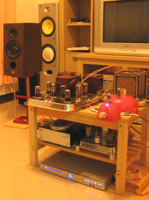

Hello! Every one, ( and sawad-dee krub K.bee696 )
My project of Audionote M7 -->àÊÃç¨áÅéǤÃѺ Audionote M7 Project: á·è¹»ÃÕáÍÁ»ì¨Ò¡¶éÇÂàÁÅÒÁÕ¹
The sound so good good , but I reccomment Paper oil coupling CAP for sweet sound !!!!!
thank you[image][/image]
