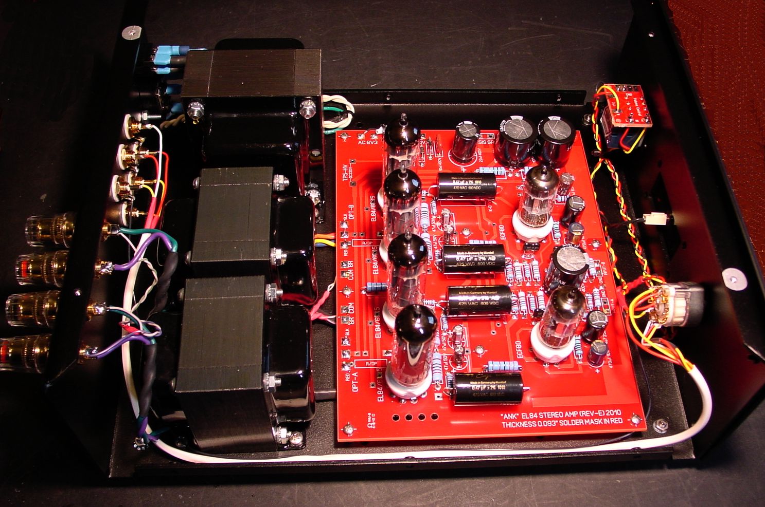

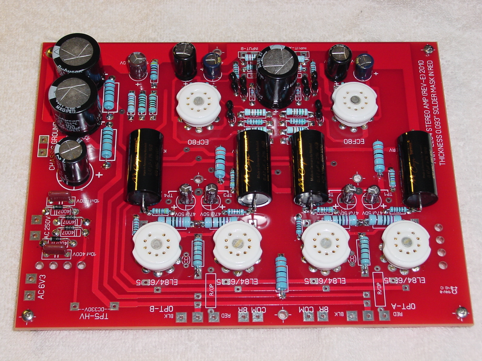

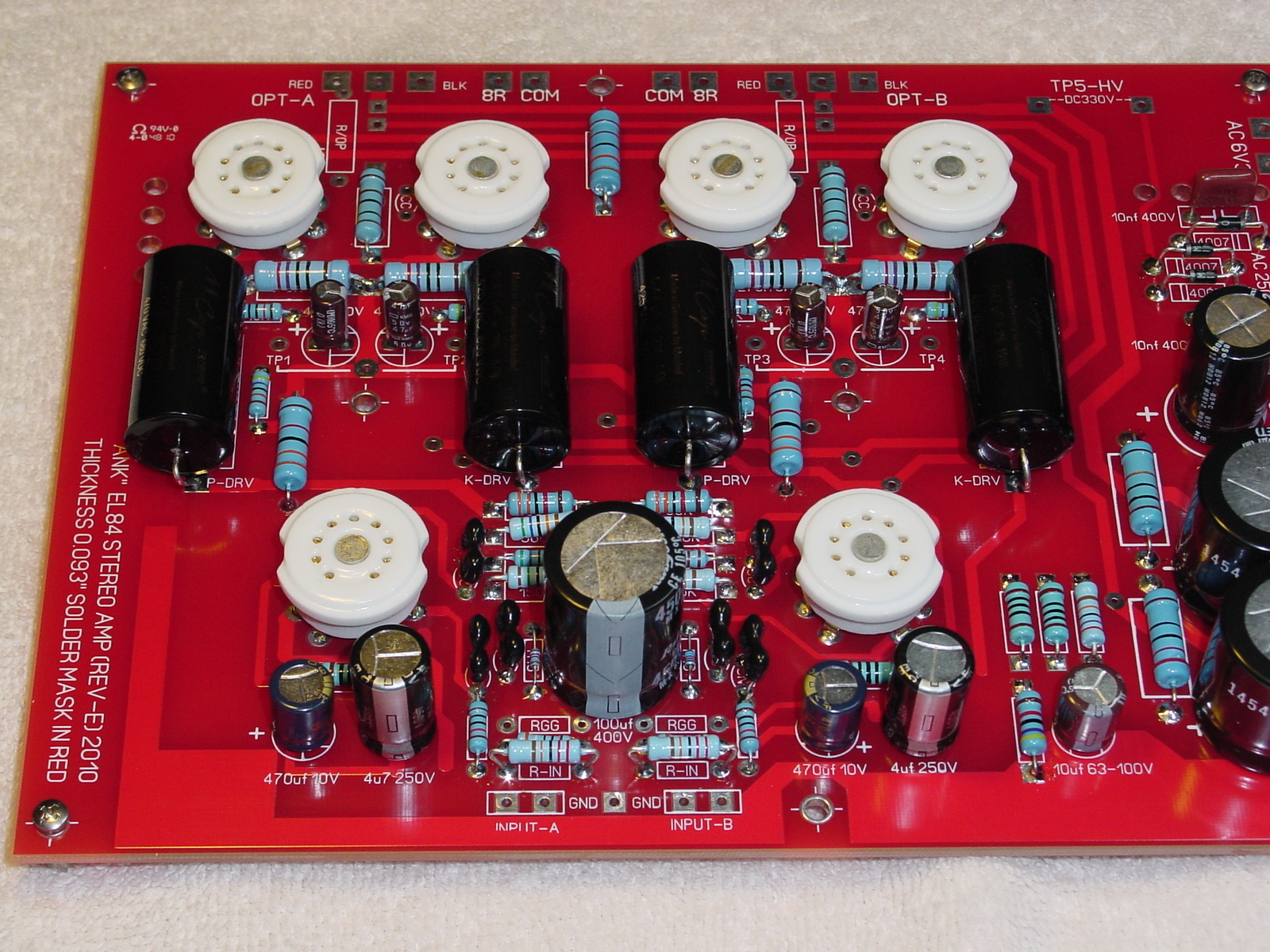

Received my EL84 tube integrated L1 kit from Brian Smith of Audio Note Kits Canada this week--only regret is the lack of time to build. Nevertheless, wow, what a nice package! All high quality parts very well packaged and well laid out. Can't wait to get to the listening point.

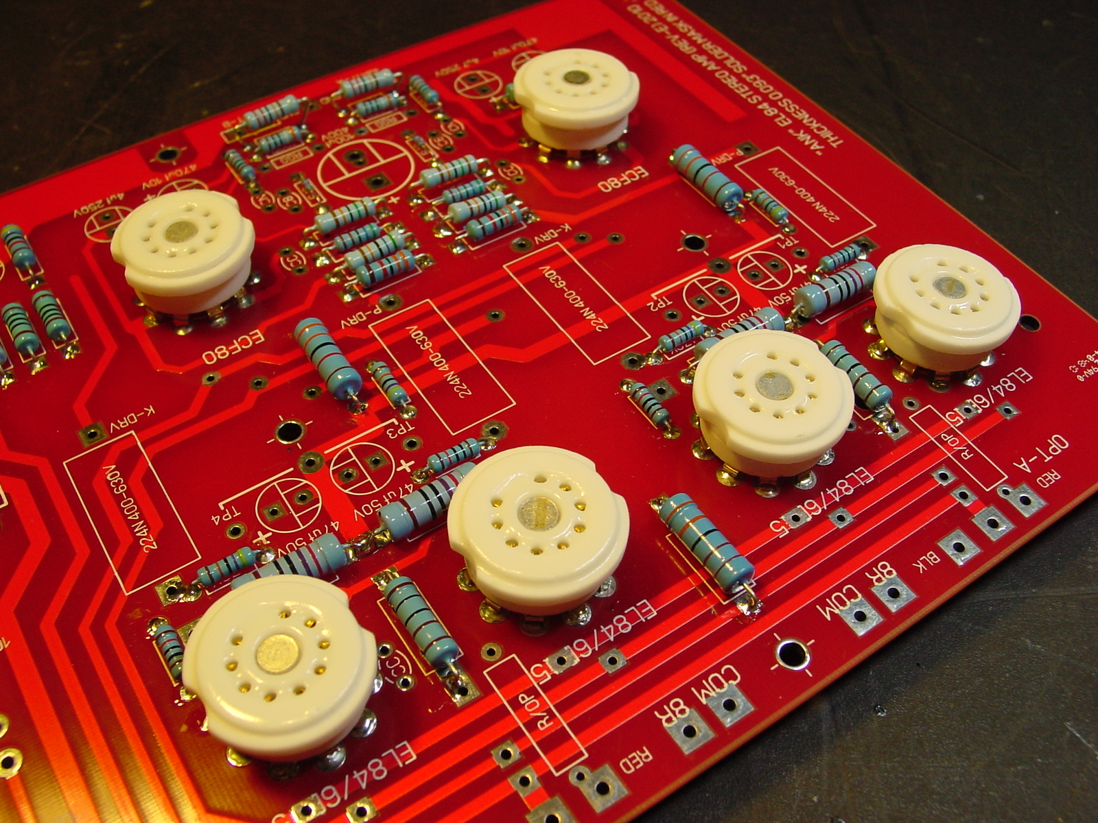

For now, I have populated all the resistors on the 3 mm PC board.
Thought you all DIYers would like to look over my shoulder as I build it.

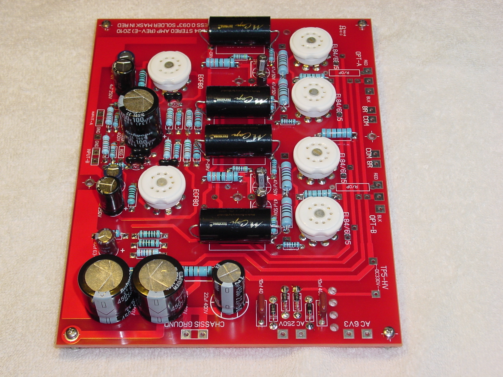

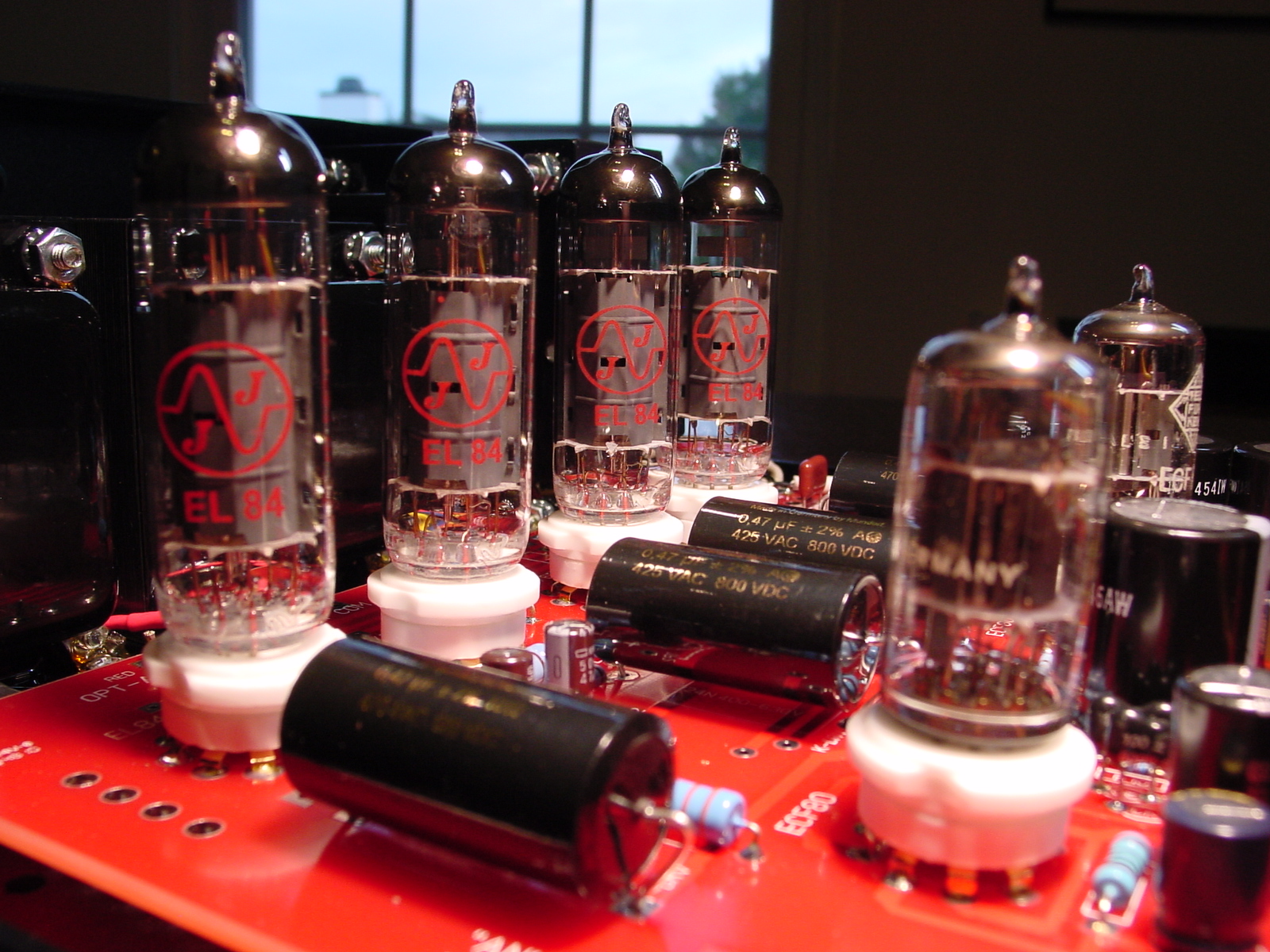

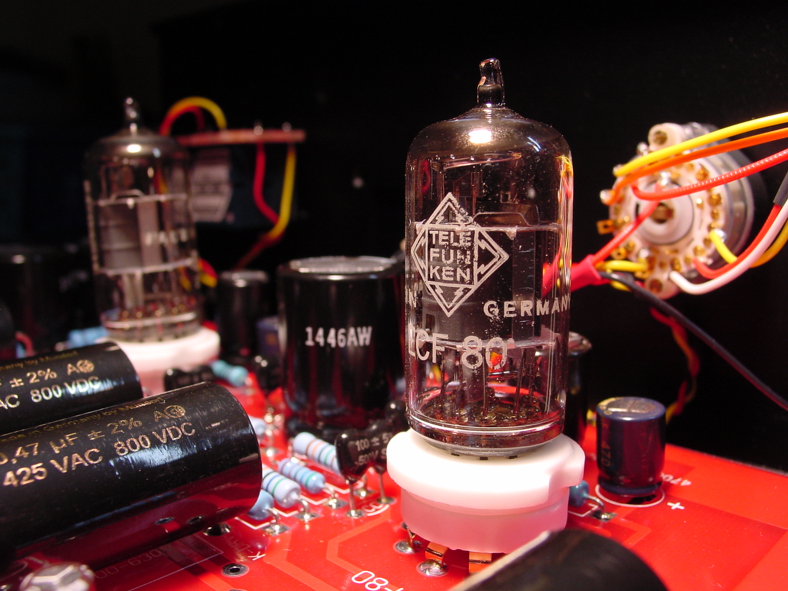

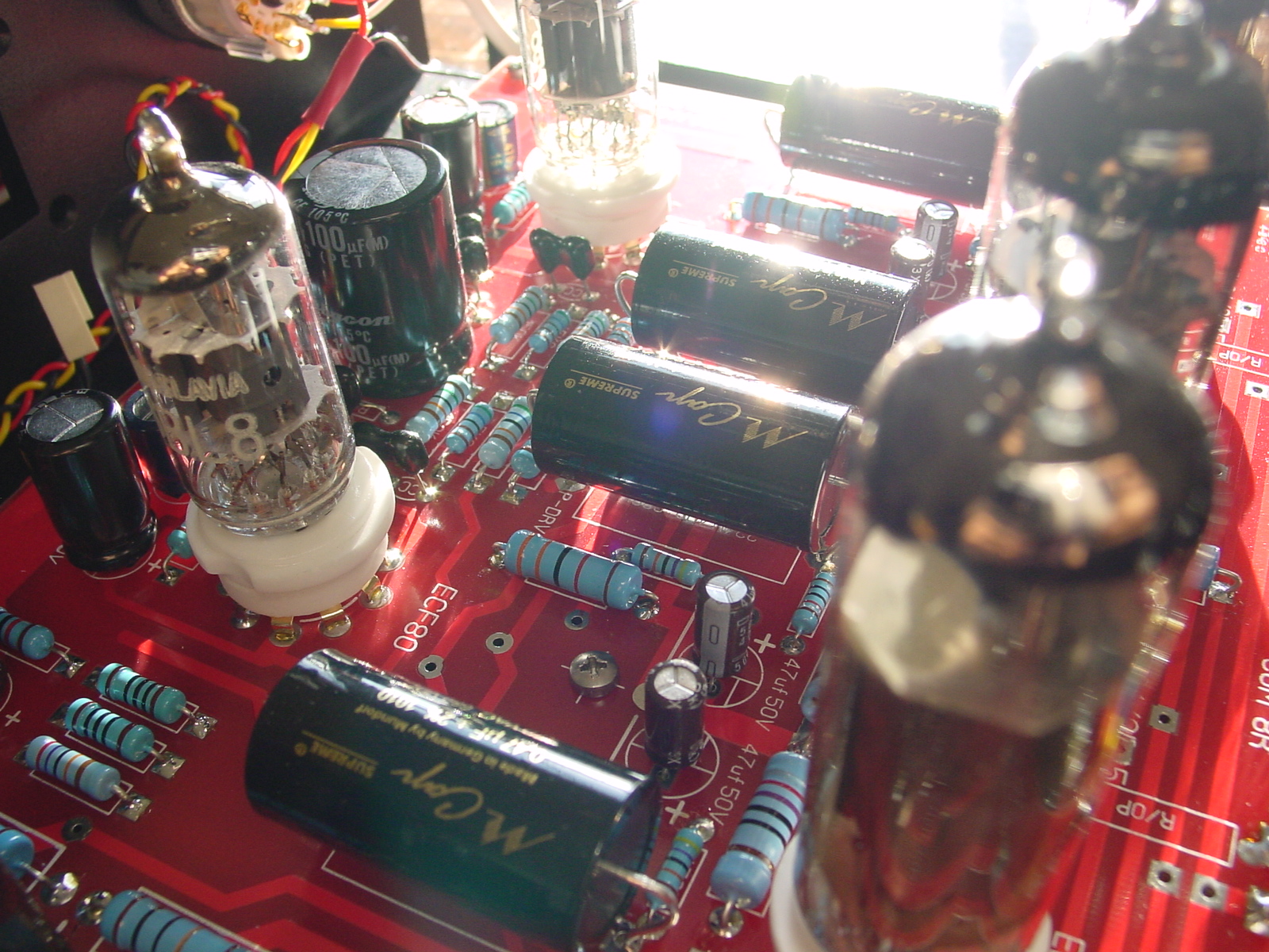

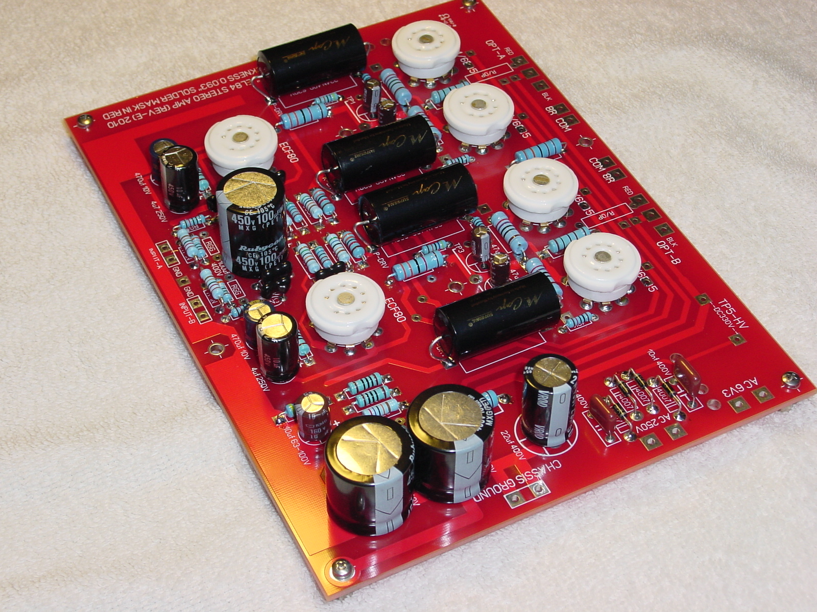

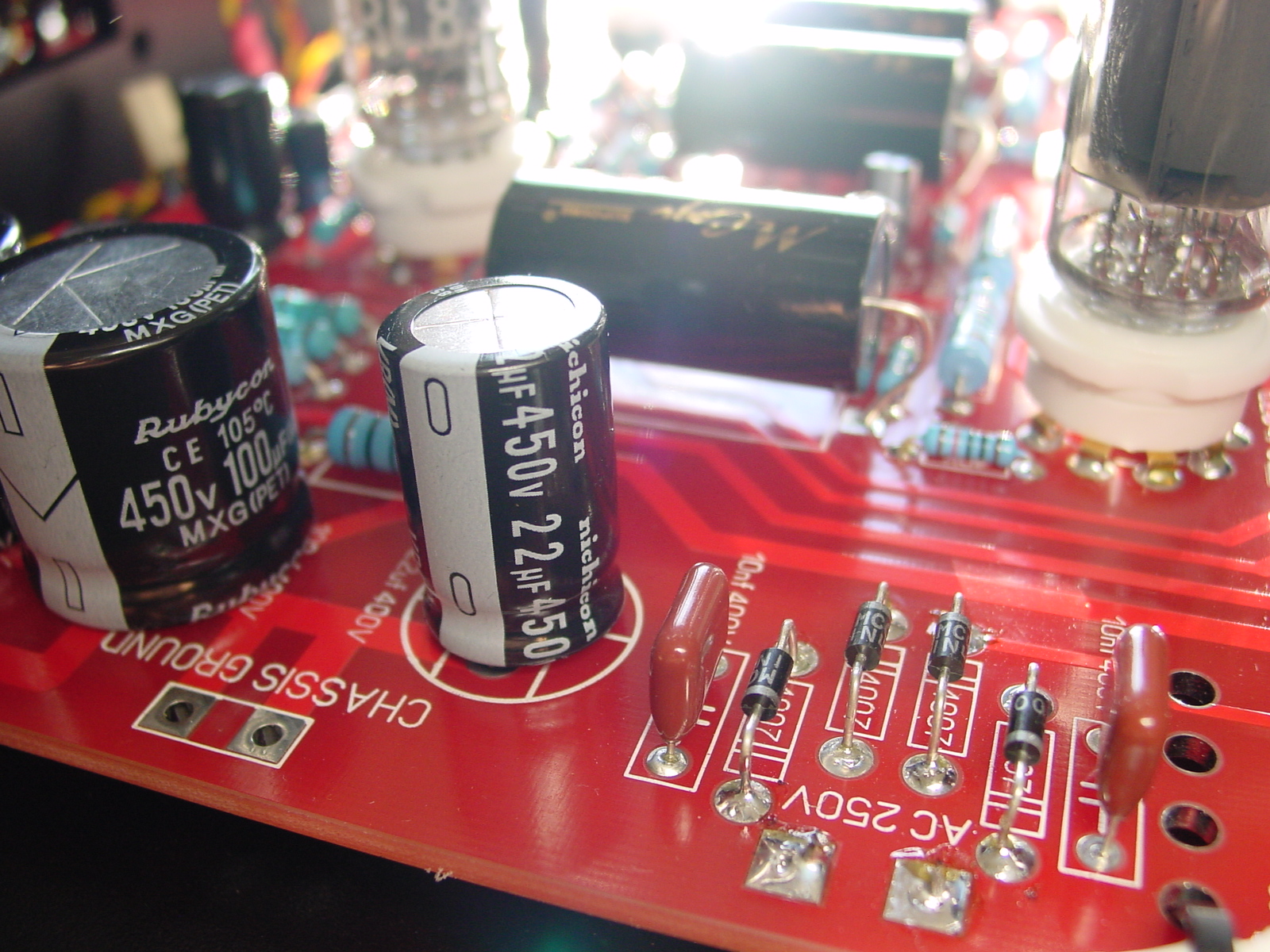

OK, I was able to squeeze in putting on the tube sockets, nice gold plated pins, then had to go out for dinner.
Later the Rubycon electrolytics, then the silver micas, and the power supply components were installed.
Last were the venerated Mundorf M Cap Supreme couplers, $17 each, but well worth it.
Now the board is totally populated. Let see how far we get tomorrow.

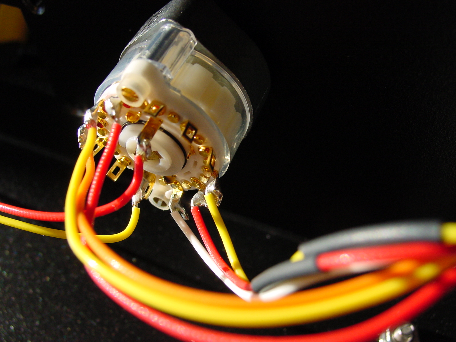

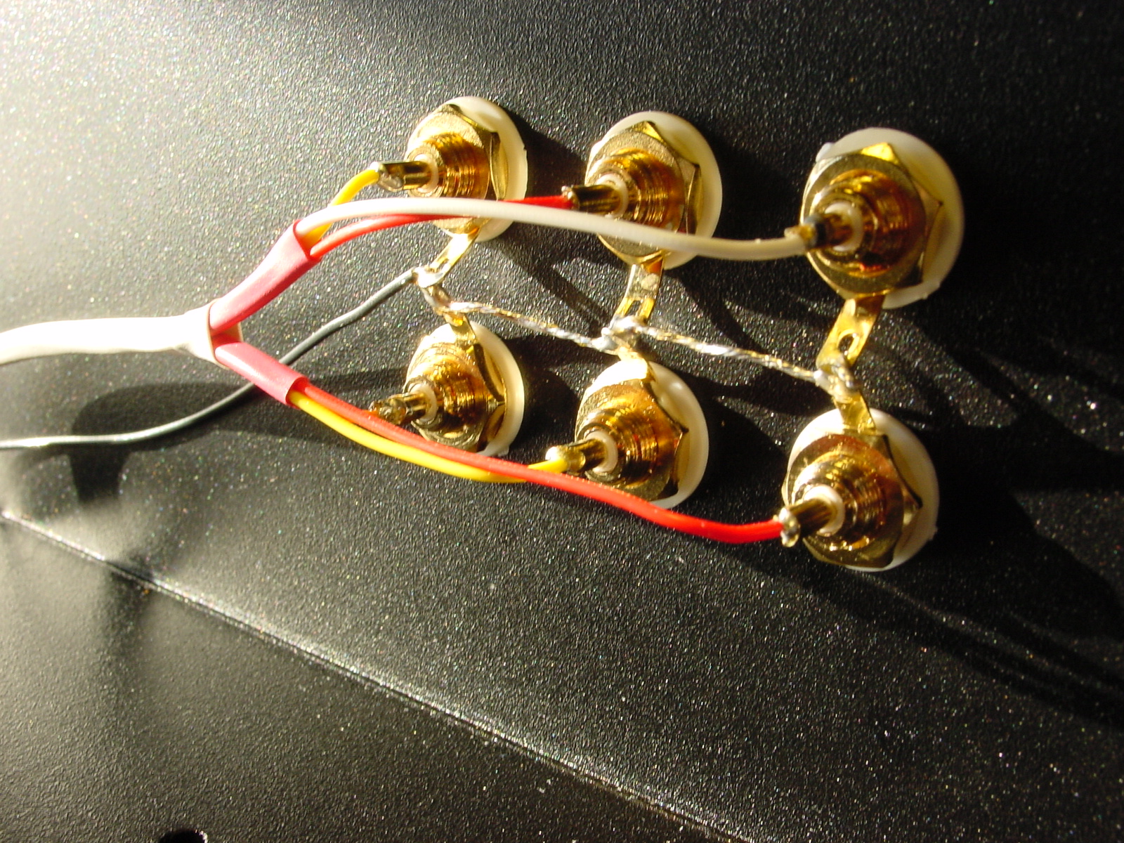

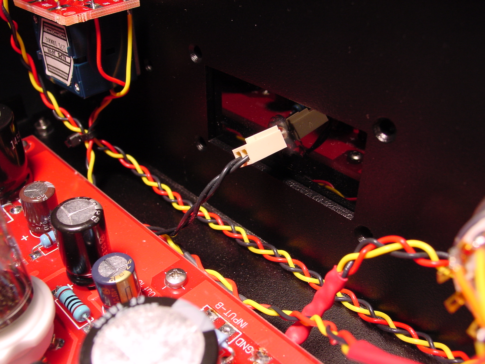

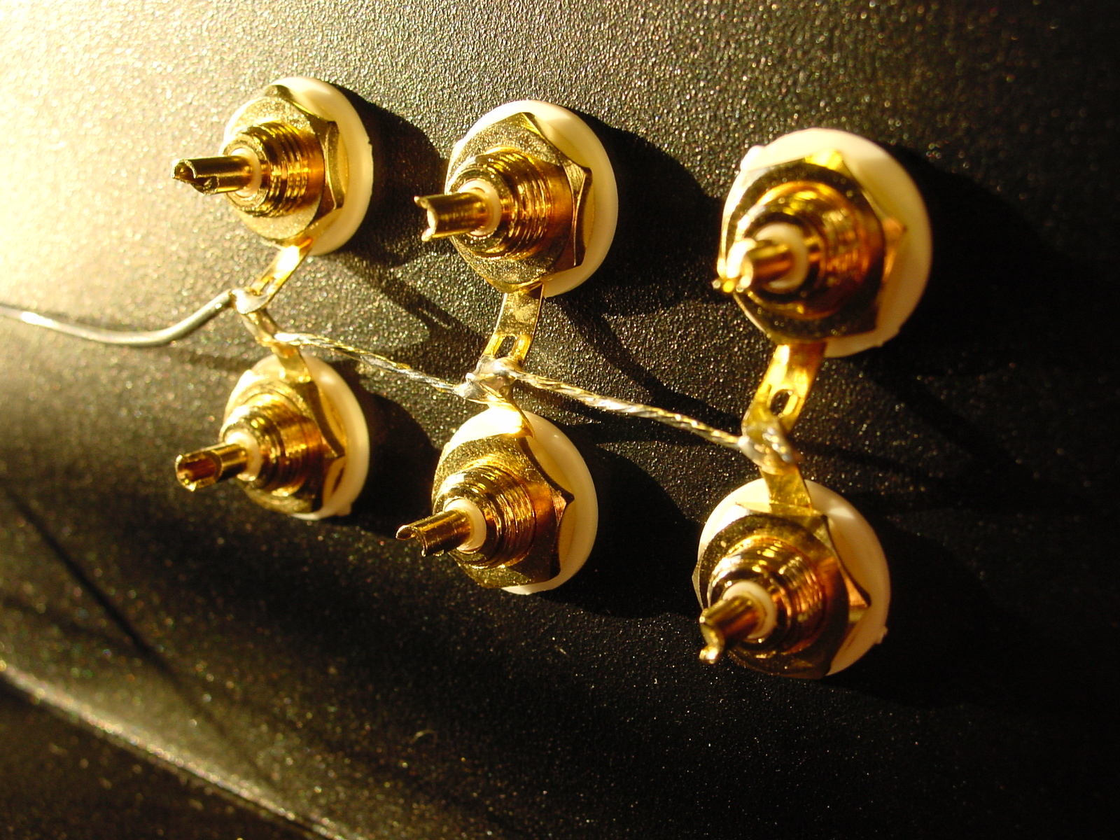

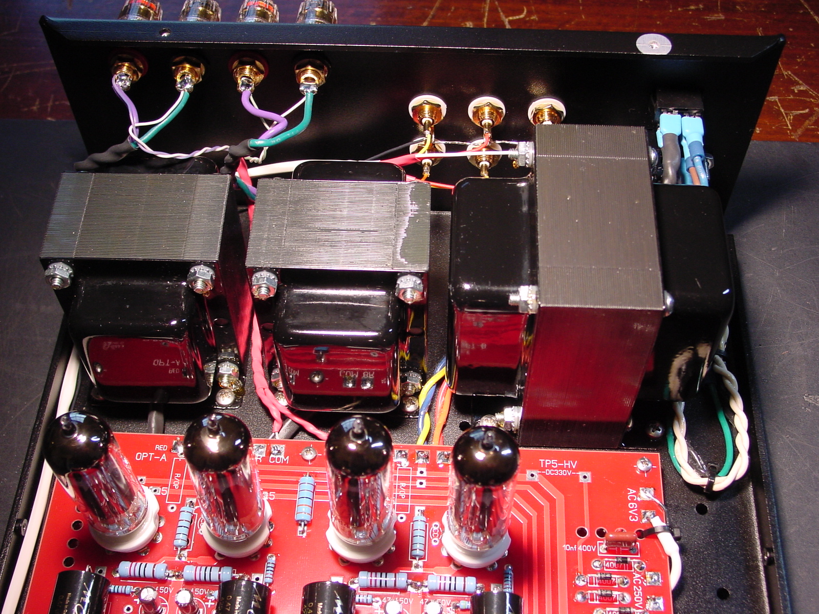

Just wired the inputs:
Thanks for the detailed pics!Just wired the inputs:

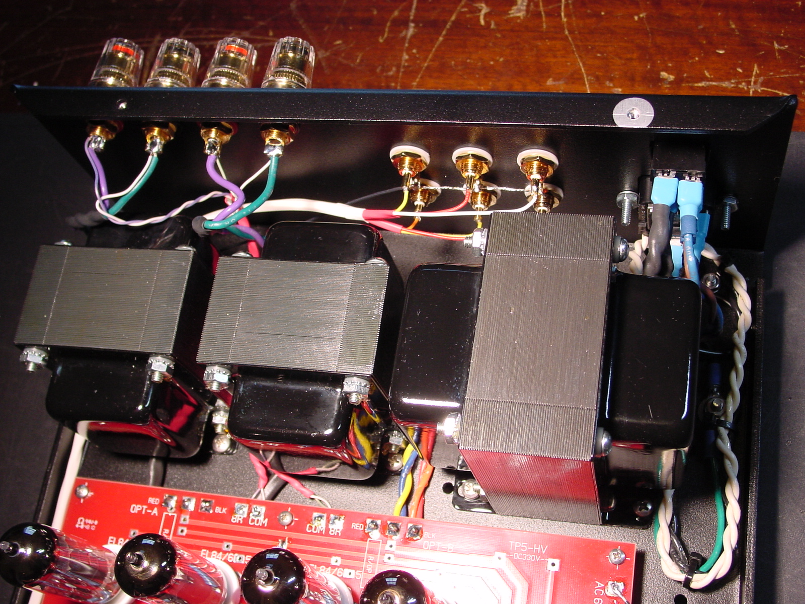

It looks like the input cabling (between jacks and selector switch at front) is unshielded. Two 3-conductor cables (R,L) and a separate ground/common conductor?

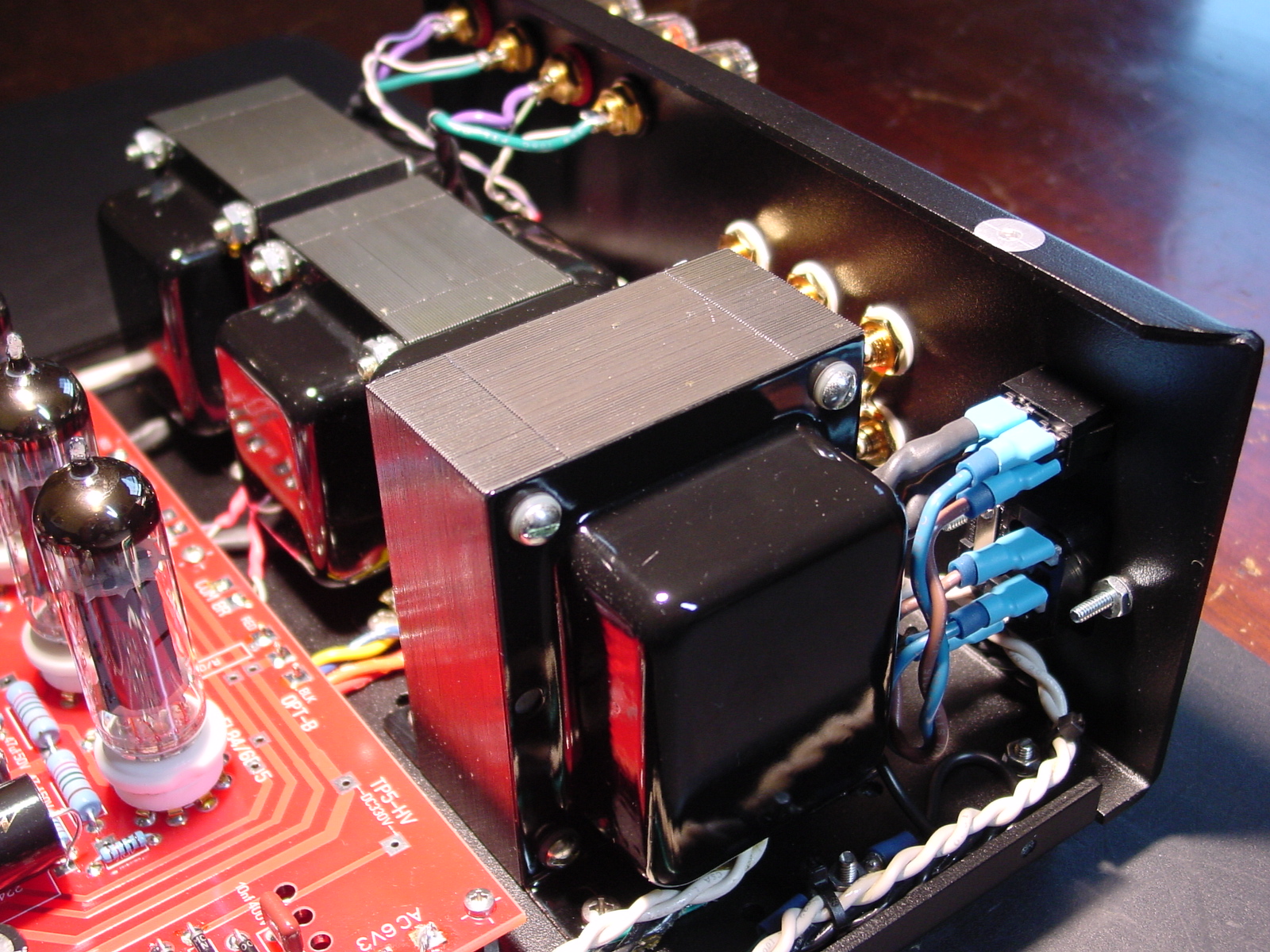

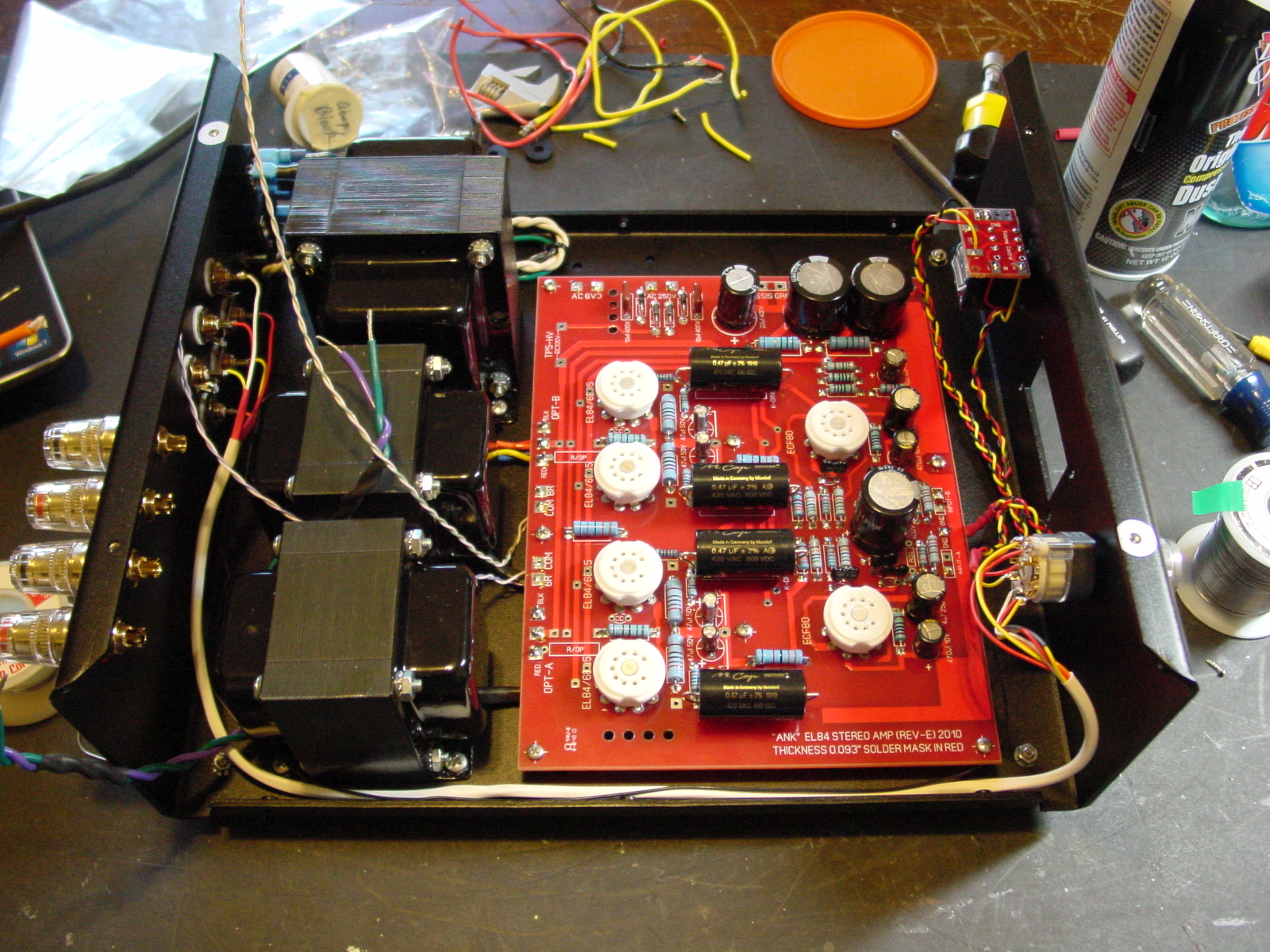

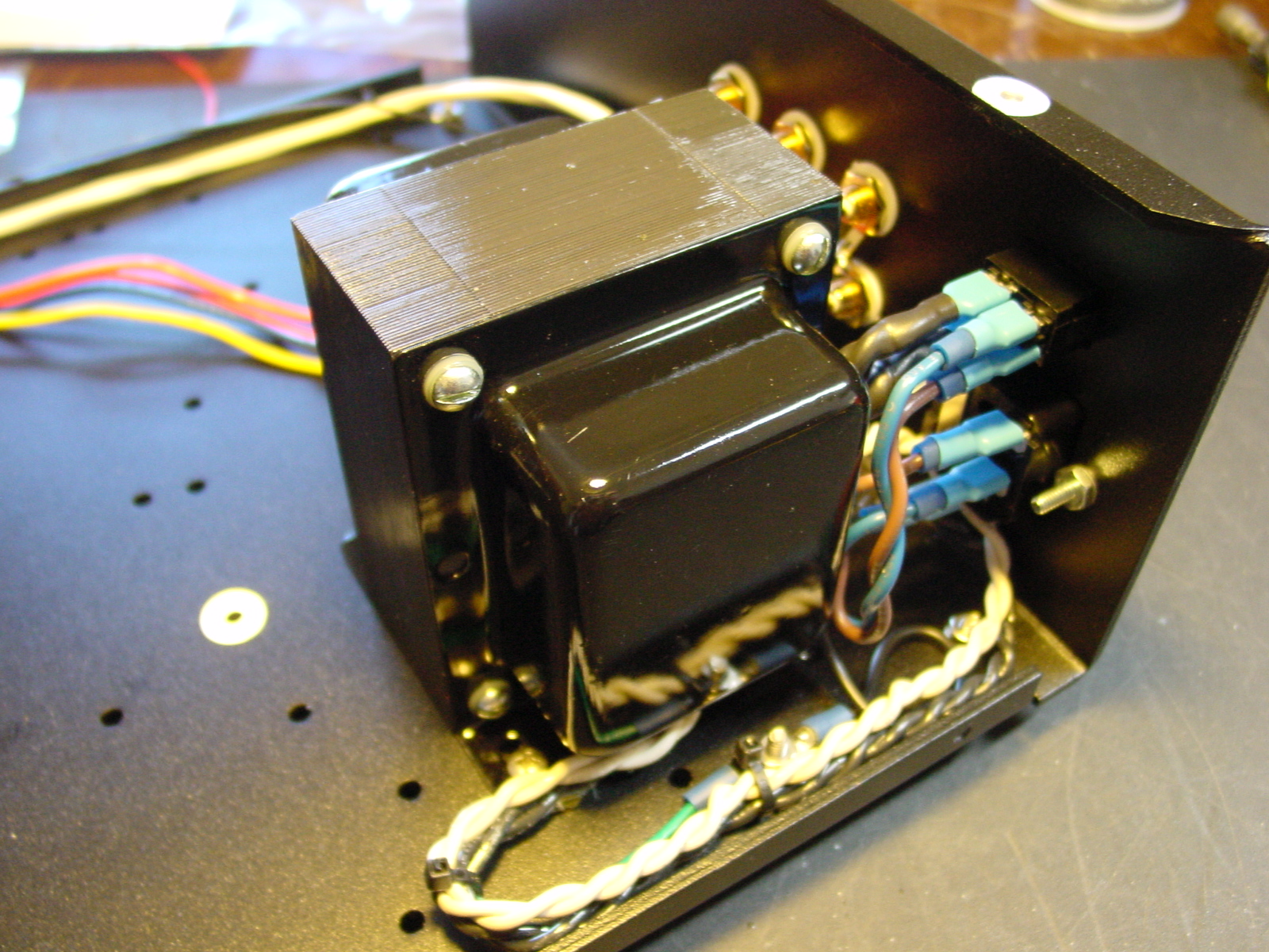

Yes, unshielded individual silver plated copper teflon coated, six cables in white heat shrink. I decided to braid the rest since it looked like I had enough.

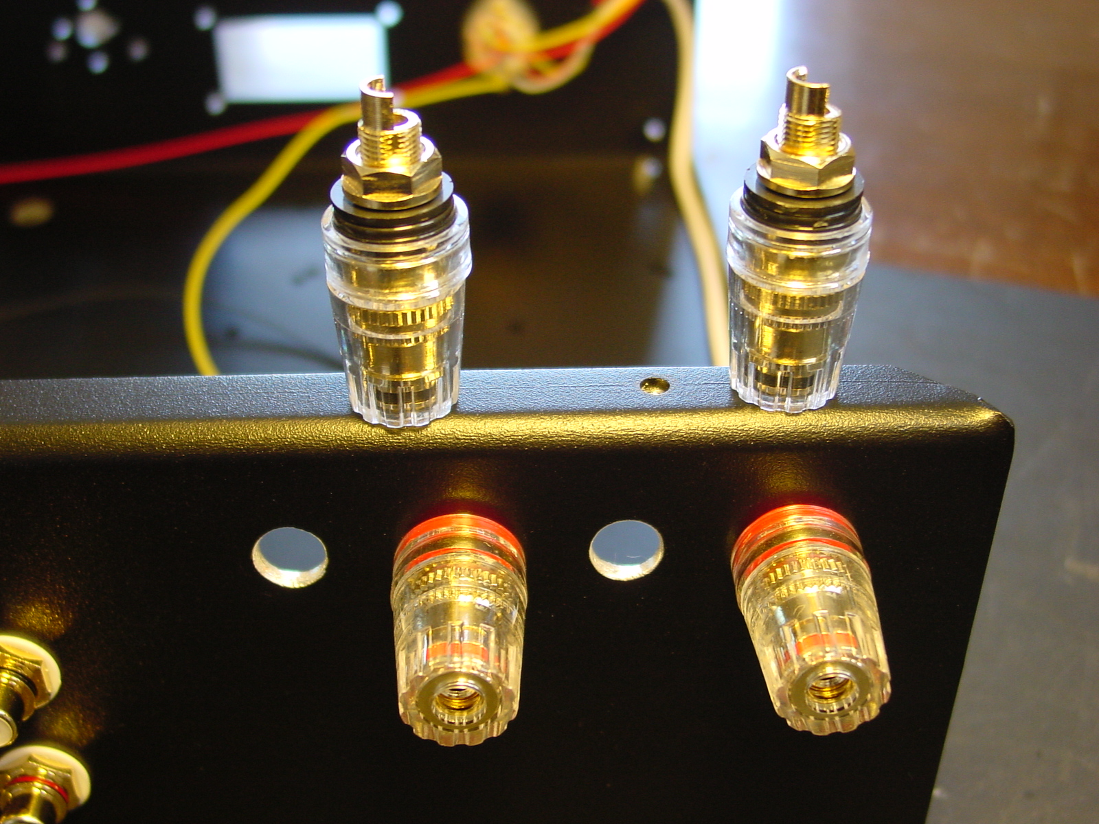

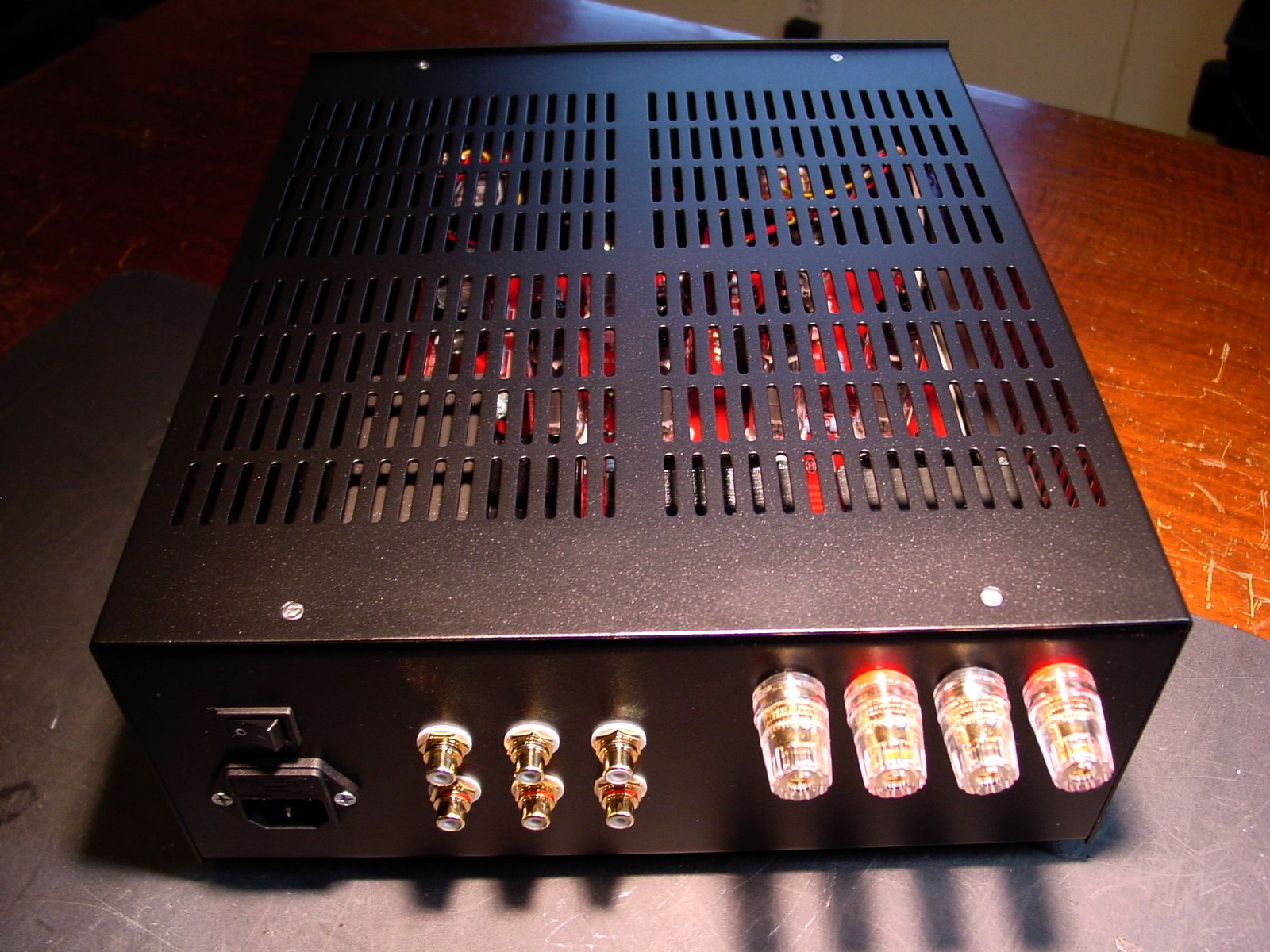

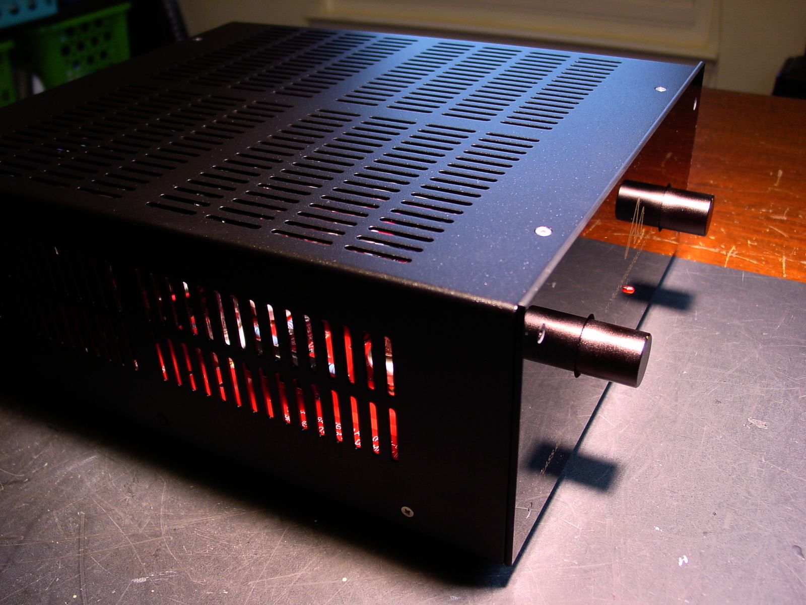

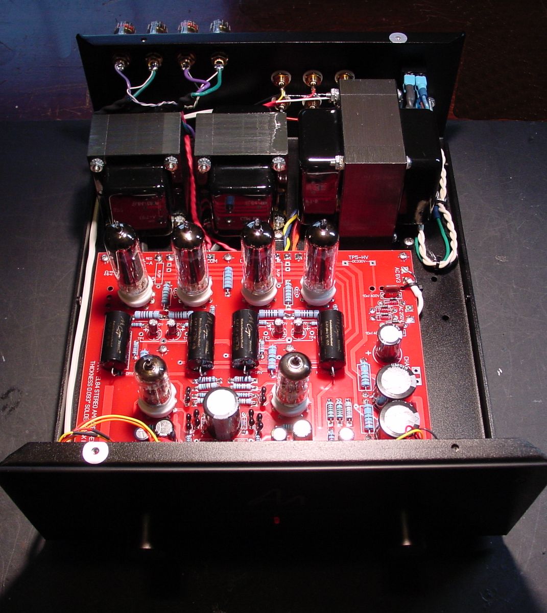

Here are more pictures showing progress. I like the binding posts that I normally use more, so I had to drill bigger holes for them! But worth the risk. Lots of metal on the floor, this is thick aluminum. No harm done...

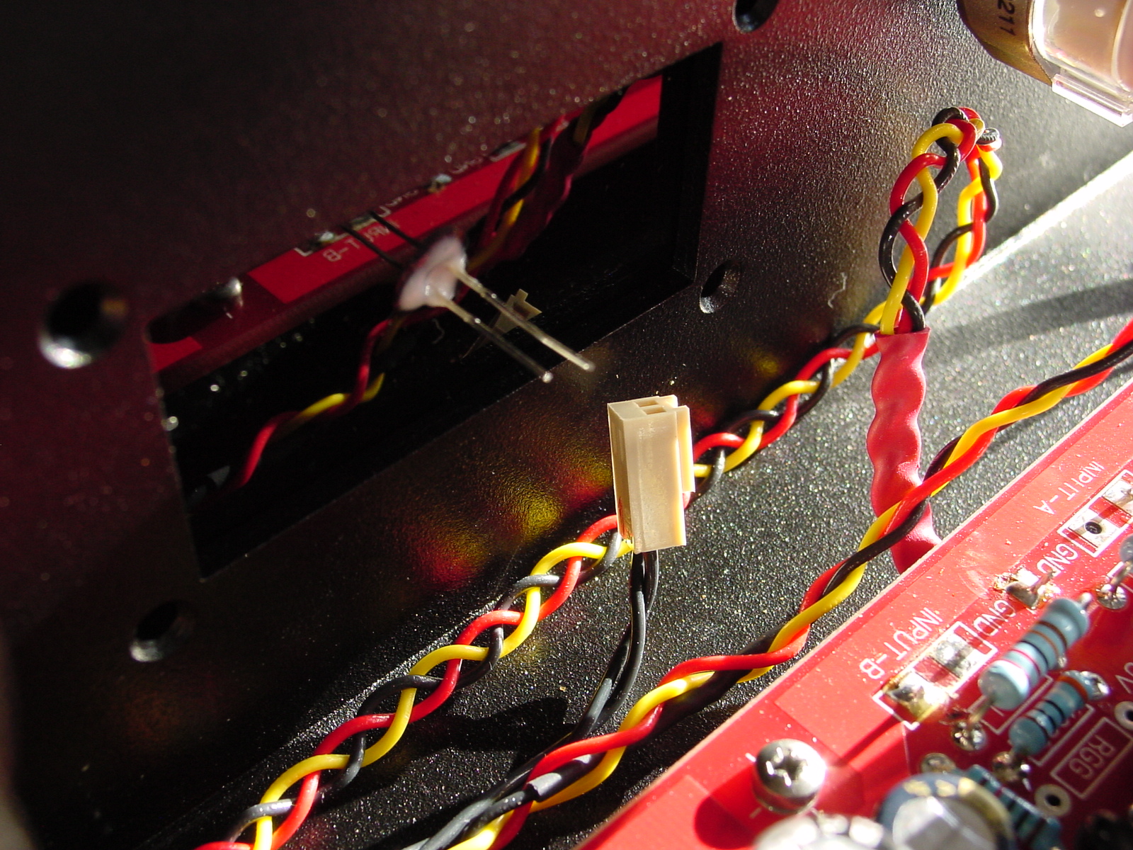

Almost ready for the cover...more tomorrow.

I was under the impression that earth should shield the signal cable for lowest noise? Comments on that, guys?
I think you are right. I normally braid the signals with the ground (see pic). More progress and final touches like glue the LED to the faceplate.
That's what I usually do, but if AudioNote can get this amp to be quiet without shielding, perhaps it is not so important?

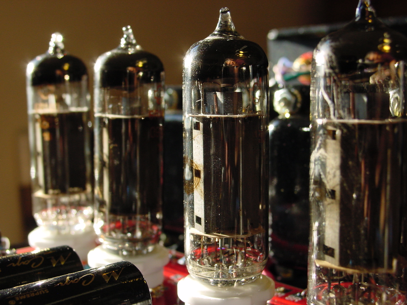

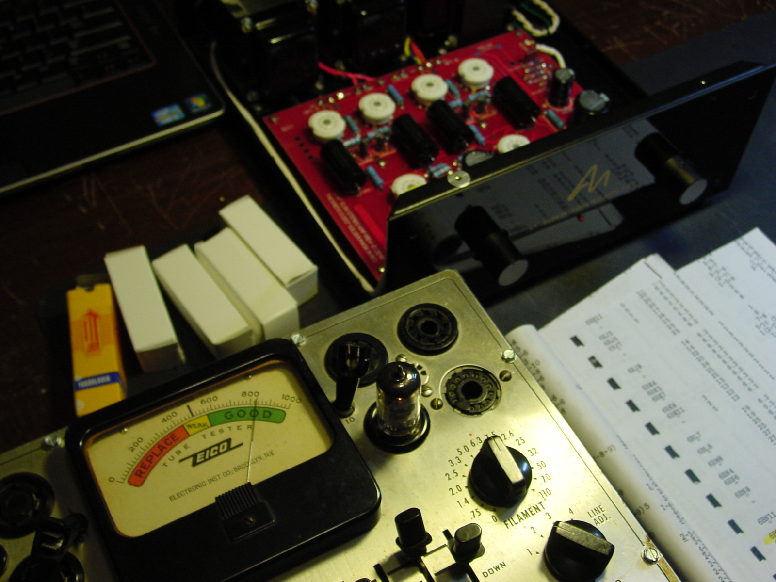

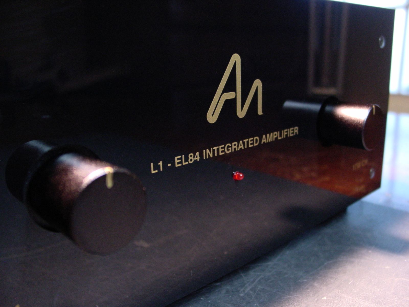

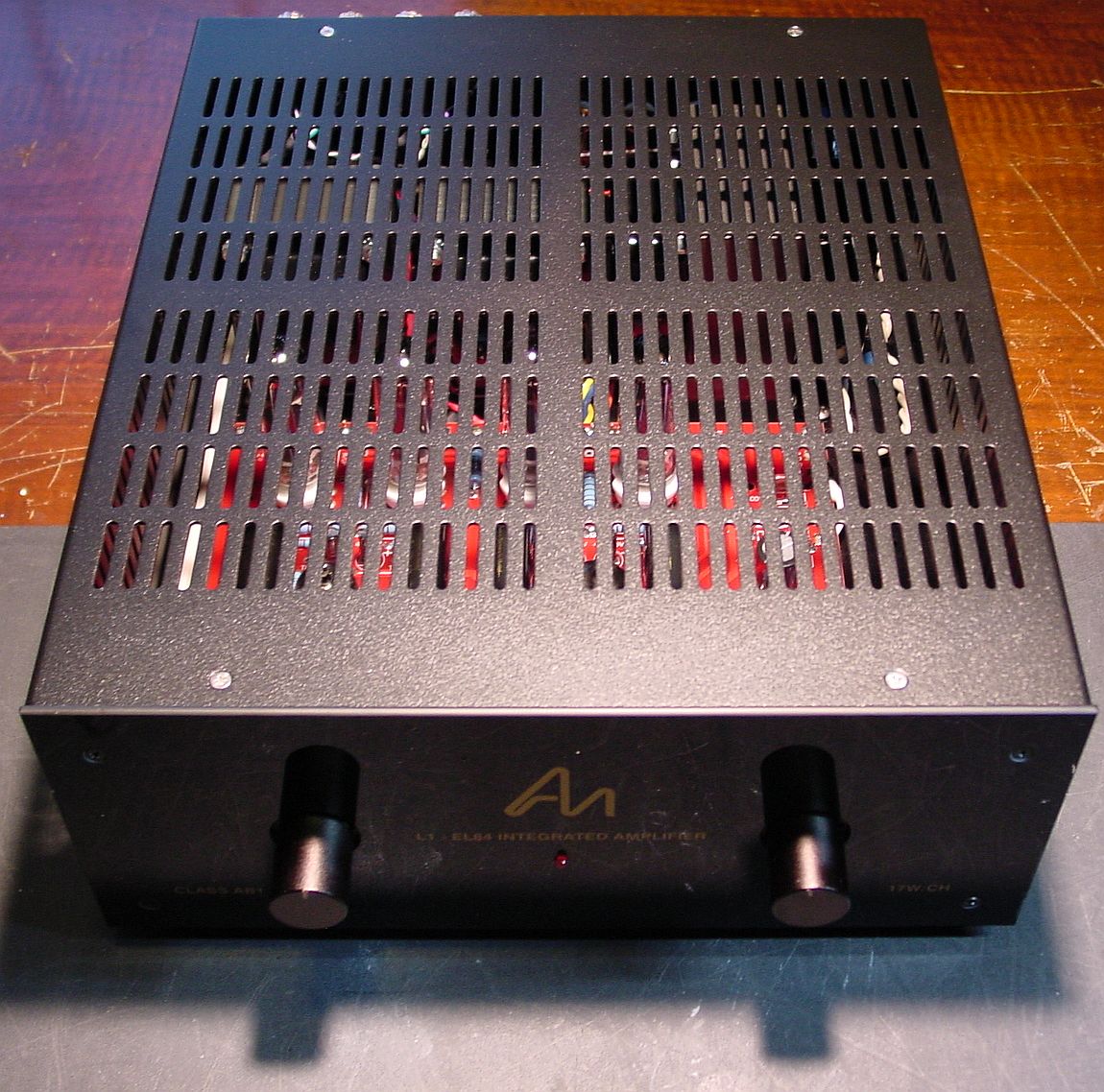

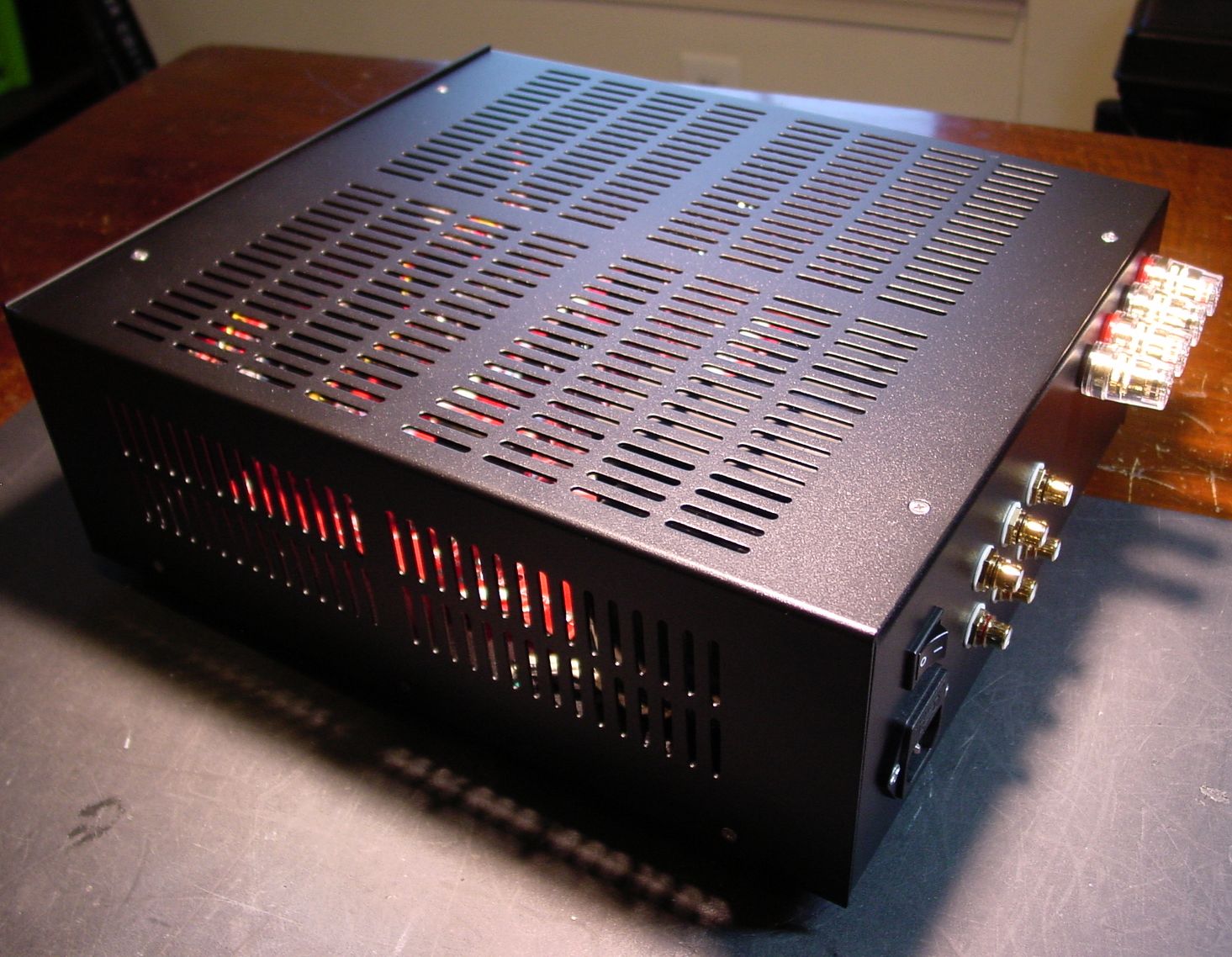

The L1 integrated is finished. It is well worth it. It is the best sounding unit in the house. Tons of detail and imaging. Lots of depth. Extremely quiet, you can't hear a thing when it is on. Bass is amazingly good. I was going to clean up while it was playing but I ended glued listening.
The matched quad set of JJ tubes and NOS Telefunken tubes are working their magic.
Enjoy the pics and hope someone follows with an L1 build.

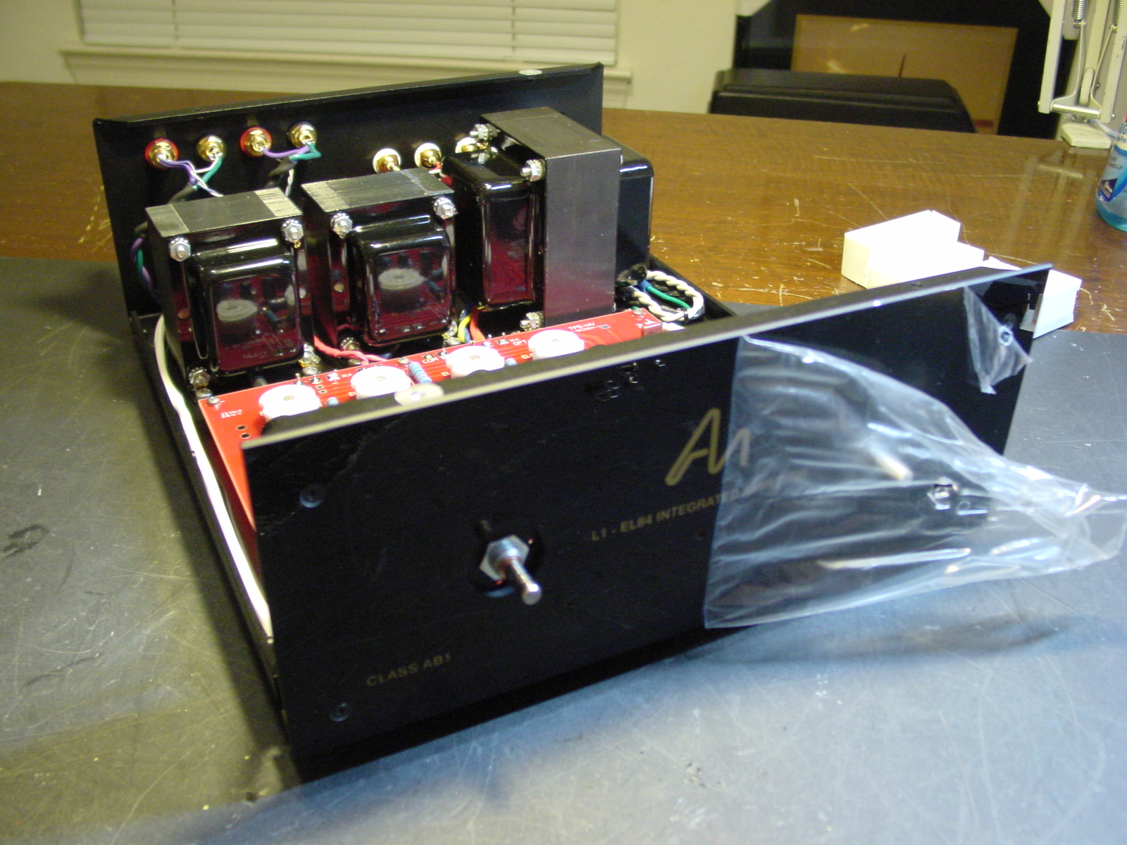

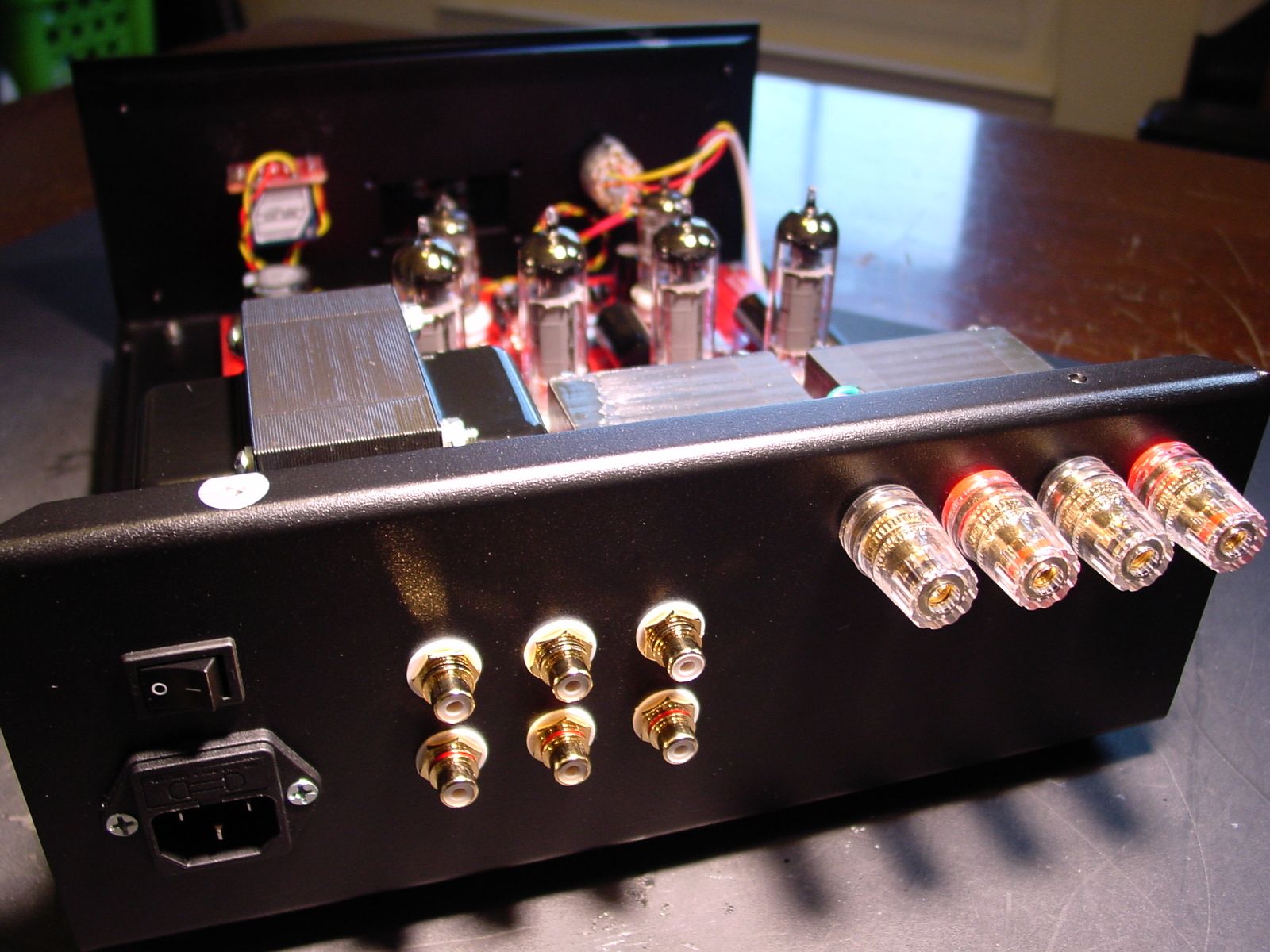

Here are some with the cover on... and the AUDIO NOTE KITS site.
You can't be too thin, too rich, and your amp can't be too quiet

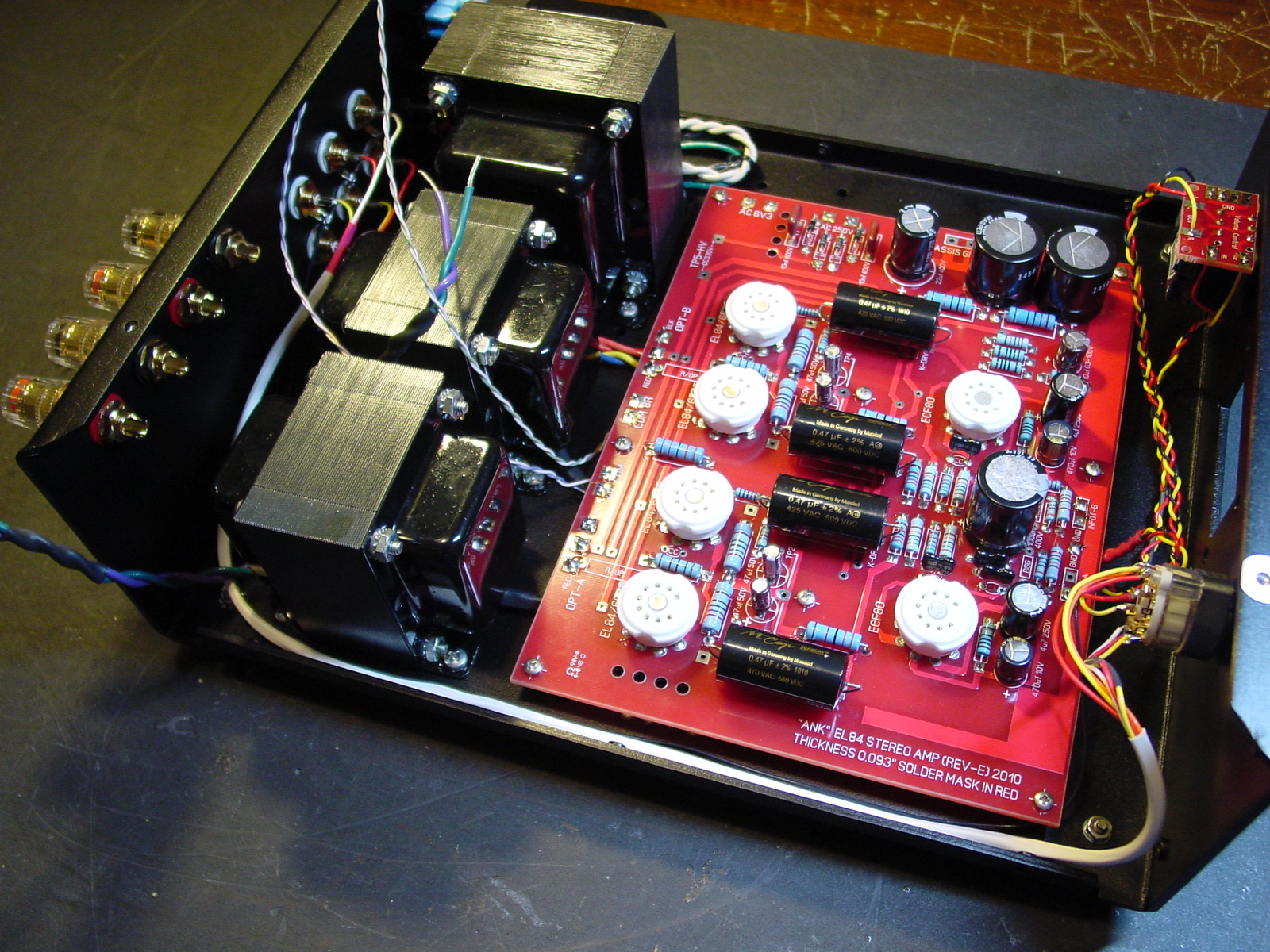

Nice pictures, but I don't understand the internal layout...why place the input terminals close to the mains input and mains transformer and the let long cables run to front?
Looks over performance?
Very, very possible. But then, as a manufacturer, you want your product to look tidy for cabling...
