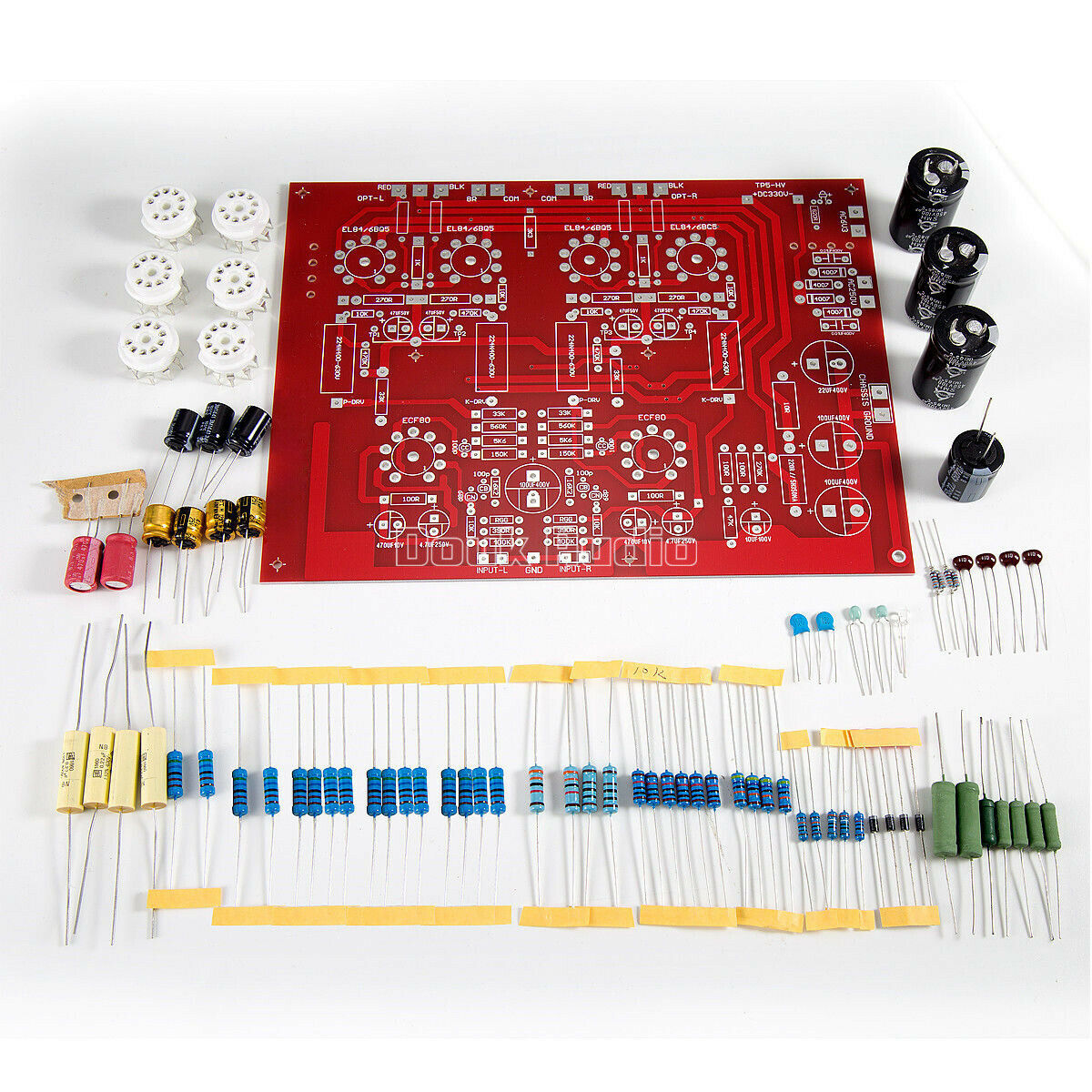

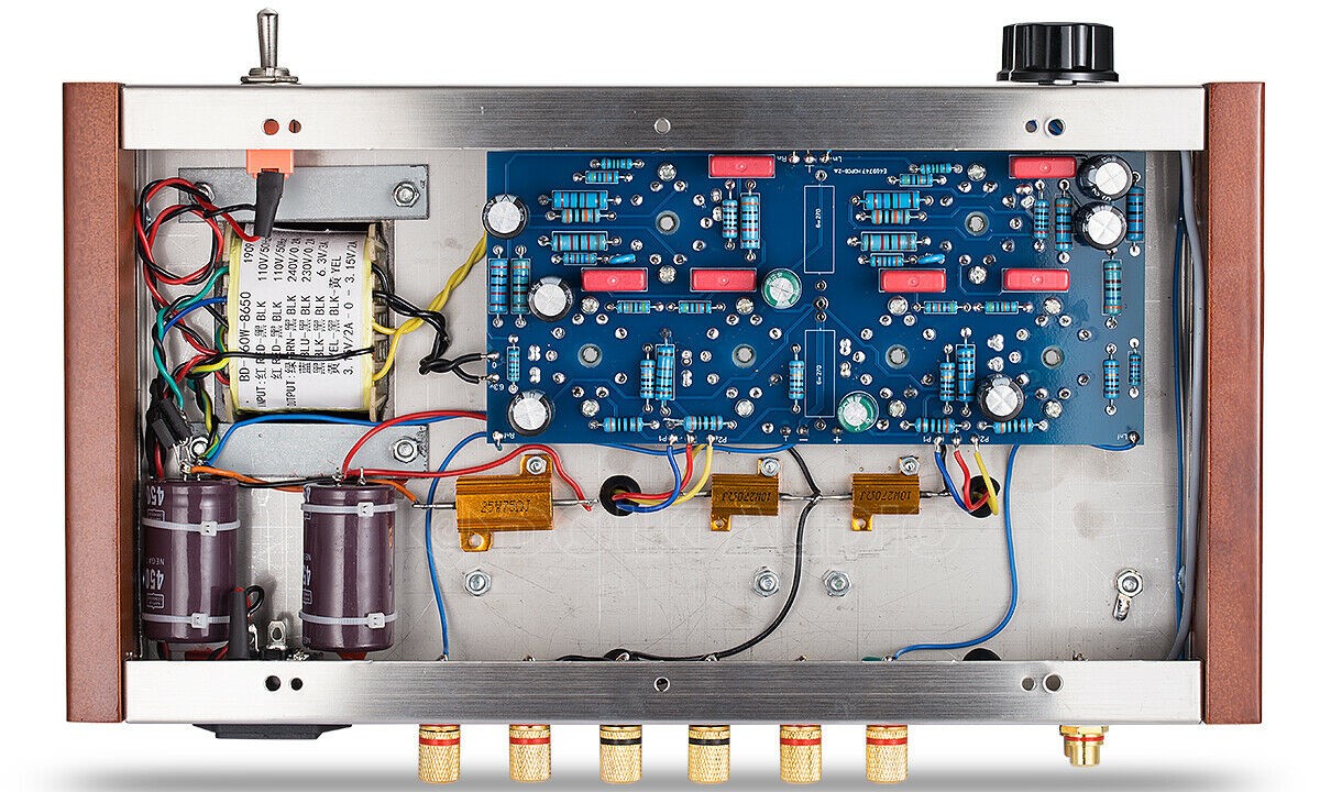

Very nice build. The Mundorf caps are part of the kit aren't they as are the JJ EL84s?
How about the NOS Telefunkens?
Thanks for all the pictures and information. Think I may pull the trigger on one of these.
Yes, the Mundorf are part of the kit and they use very high end parts and may use better resistors than what they had back then. I may have acquired the Telefunkens somewhere else though...Very nice build. The Mundorf caps are part of the kit aren't they as are the JJ EL84s?
Don't think you will regret pulling the trigger.

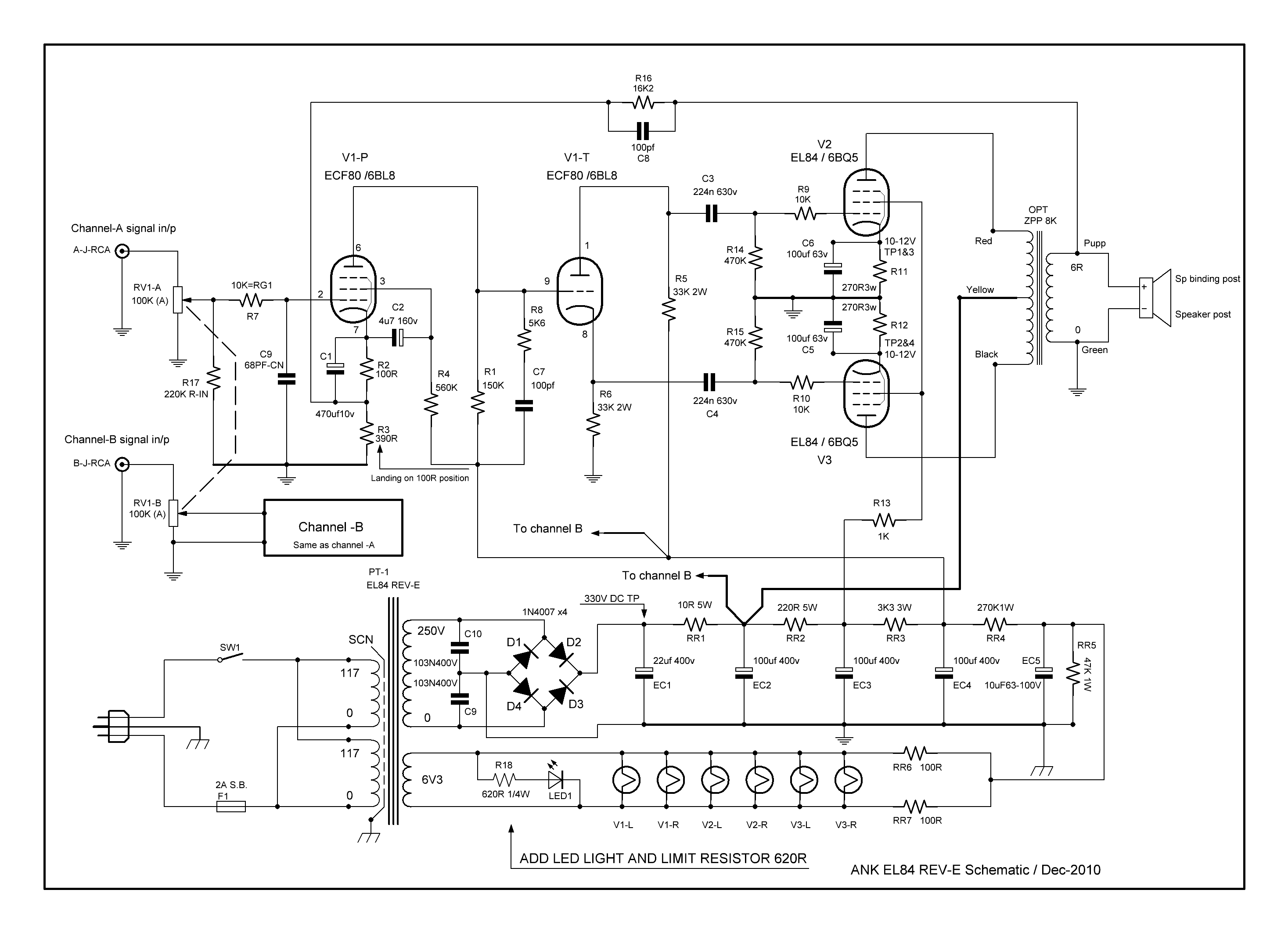

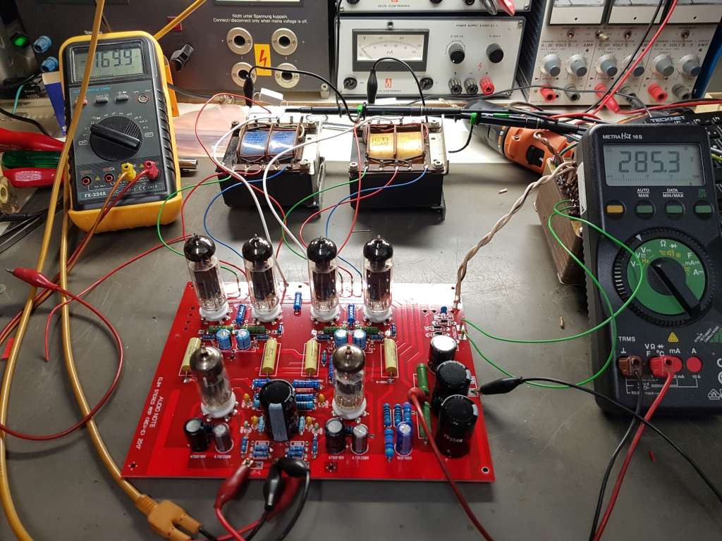

I bought and populated (as at the origin) a clone of L1.
having several pairs of opt at home, I did not buy the audionote opt.
so I'm going to assemble it on a bread board and see what it gives.

I chose a different way.
I bought the L1 pcb clone and populated it with good components.
I will try to respect the original kit as soon as possible because Audionote is far from being a beginner in this area.
I also do not like Chinese opt, it can be good but then you have to put the price, I prefer to use ops that I know, in this case Supersonic.
ditto for power supply, they planned wide in terms of power, I also chose this way.
ditto for the tubes ,i have many lots of el84 , 7189 and ecf80 .
you have the chance to be in the usa and to be able to buy Hammond and Edcor for a reasonable price as well as good quality 7189 or EL84, it would be a shame to deprive yourself.
when it's 100% Chinese, I do with it and I adapt, but then it's a shame not to do something nice and beautiful.

I built a L1 clone for a friend of mine - it sounds very good. Having everything
on one (large) PCB has it's advantages, but I think what Jim (oemcar) is doing
makes it much easier in terms of enclosure design.
Look forward to the new board.

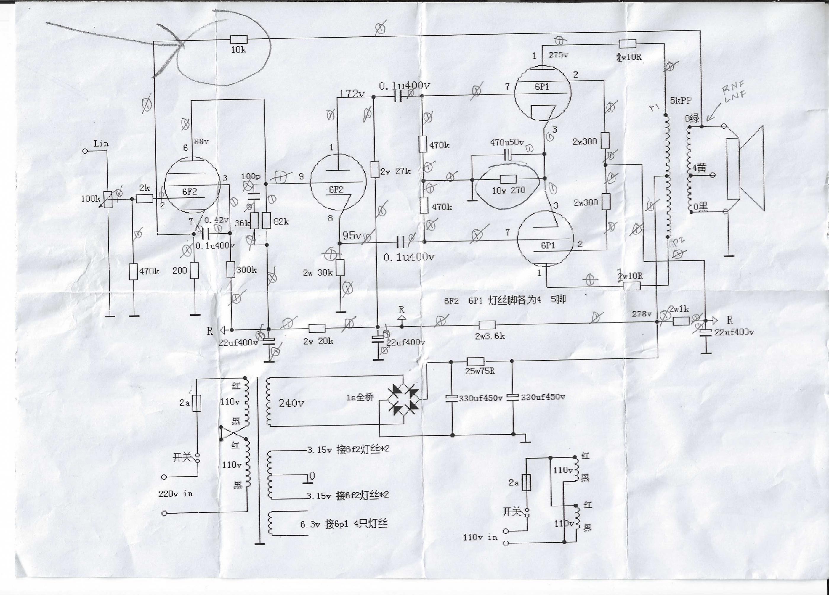

The 6BL8 concertina uses 33k resistors in the cathode and plate (correct, same value).
The 6F2 concertina uses 27k in the plate and 30k in the cathode.
The signals from that concertina are slightly unbalanced.
That will cause the 6P1 push pull pair to have a little 2nd harmonic distortion, but the global negative feed back will cancel most of that.
It would be interesting to do a listening comparison, to both the unbalanced and balanced concertina versions.
A single resistor change allows that.
If you have the 33k 33k amp, change one of those to 30k.
If you have the 30k 27k amp, change one of those to match (two 30k, or two 27k).
Have fun listening!
Have fun listening!

_"If you have the 33k 33k amp, change one of those to 30k.
Have fun listening!"
I have 33k+33k
I will try in this configuration and change one of the two to see

indeed, I could see during my research and through different diagrams that sometimes it was balanced, sometimes not and sometimes there was a balancing pot, which suggests that others are posed the question before us 😀
Unless the tube draws grid current,
Unless the tube has filament to cathode leakage,
Unless the tube has way too much filament to cathode capacitance,
Then, matched resistors in the concertina cathode and plate, plus matched resistors in the next stages grid resistors, and if the next stage grids do not draw grid current, there will be perfect balance of the amplitudes of the two phases of signal.
Why is it that some wives tales always want to go contradictory to math and physics?

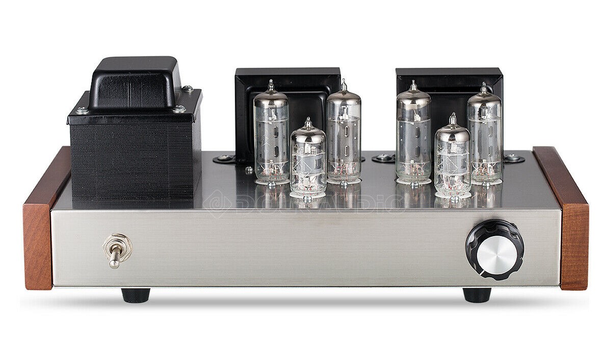

the child uttered his first cries and it is remarkable !!
yet assembled in bulk in a box "to see what it gives" it is perfectly silent and is really very good.
I think it can be wired in UL, I will try after

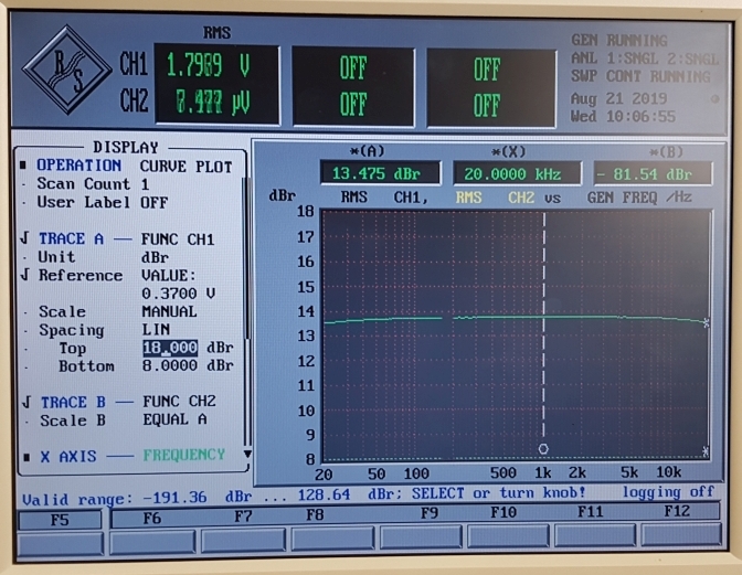

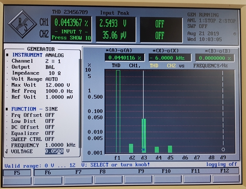

Hello ,
I build this clone last year and measured it . I use TFK EL84 with round plates and E80CF from Valvo .
Kind regards , Alexander .
Wow!
Those graphs are impressive! What wattage would you estimate these measurements taken at? Looks like 5W load resistors in place of speakers? does this have affect on graphs?
