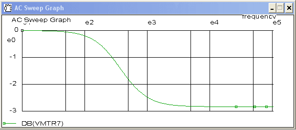

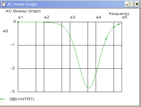

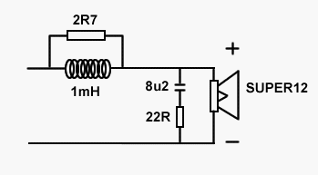

Step 2 - Shelving Filter
A Contour Filter attentuates all the highs to the same level of the woofer frequencies.
The Spice graph shows the electrical behaviour with a 7 ohm resistive load.
LMS Gated Sweep from 1K-20K shows actual acoustic response of filter. As predicted by Spice, attenuation is about -3dB.
Filter Values are 1mH+2R7.

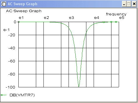

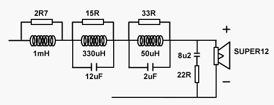

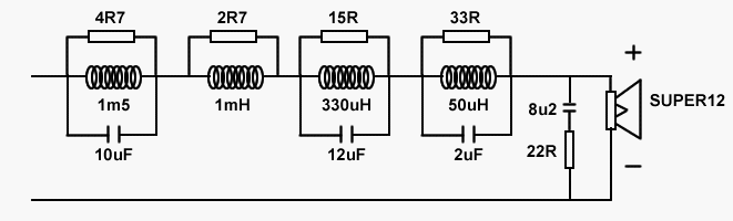

Step 3 - 2K5 Notch
The most serious peak is attacked first. A fairly deep (-10dB) Notch centered at 2K5 is applied. Width of the Notch Filter is adjusted to attenuate the adjacent frequencies. LMS Sweep confirms sideband attenuation.

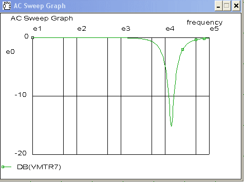

Step 4 - 14K Notch
Time to add some icing. A -15dB Notch at 14K reduces the cone breakup to a more acceptable level. Component Values are 50uH + 2uF + 33R
During listening test, I detected a peak somewhere near the 1K region. Certain piano notes are slightly emphasized. Very irritating to listen to.

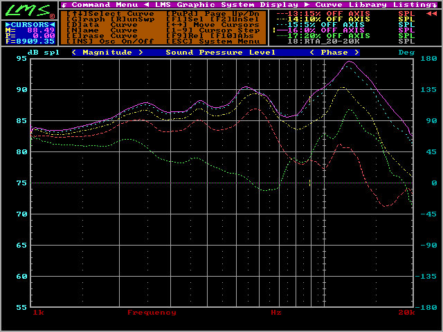

A more accurate statement would be that the notch filter reduces its visible contribution to the frequency response. The break up mode is still there.
dave
Hi dave
Thanks for your input. You are absolutely right, the cone breakup is still there, just not so severe. I contemplated on using a 3rd - 4th order LP at 10K but decided to notch the frequencies instead.

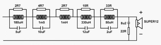

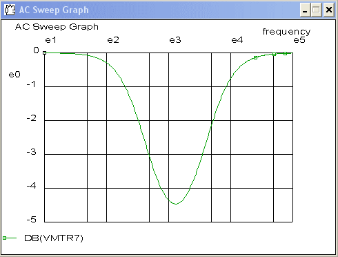

Step 5 - 1K2
Unlike the previous filters which are sharp and narrow, this filter is quite broad with only -5dB attenuation at 1K2. Values are 1.5mH + 10uF + 4.7 ohms. Speaker sounds much better now. Vocals don't sound nasal and piano sounds more natural.

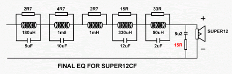

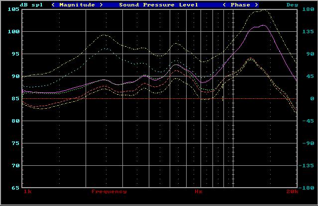

Final EQ
There is still one final adjustment. I do not listen at 1 Meter. My normal listening position is about 10 ft. At this distance, the balance is off. Vocals are slightly recessed and losing some of the highs. Sounds a bit like background music.
To bring it back up to what is in the actual recording (I use a pair of Grado SR80 and AKG K240DF headphones for referencing), I tweaked the zobel to "lift" the vocals and highs. The correct balance snapped in at 15 ohms. Final Zobel value is at 15 ohms + 8.2uF.

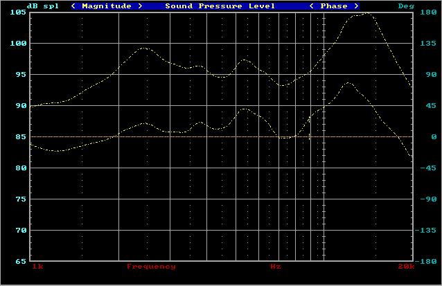

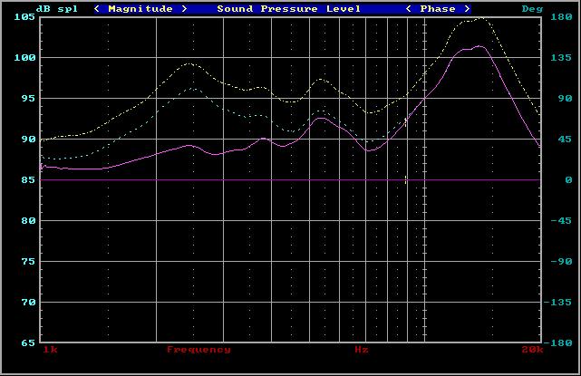

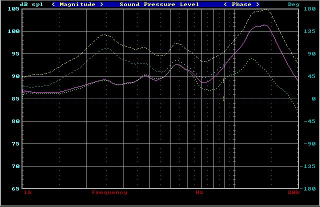

In the LMS plots, we can compare the Raw Super12(without any EQ) to the the one with Full EQ applied (lower plot).
Massive improvement in sound quality.

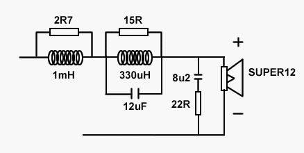

Some quick questions from the peanut gallery..
To lift the vocals couldn't you remove the shelving filter rather than change the zobel?
Would changing the inductor in the 15k filter from 50uH to 25uH lift the 8k dip without leaving a peak at 10k?

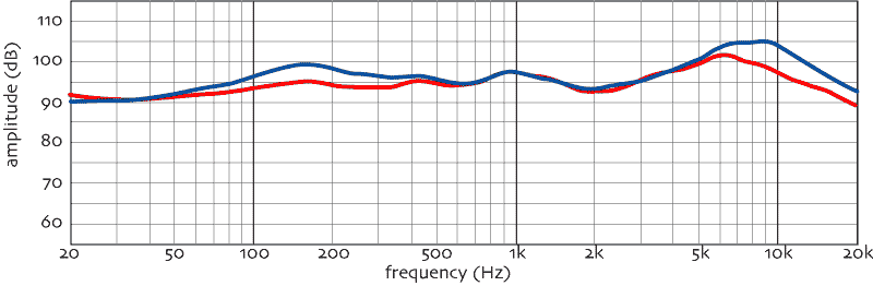

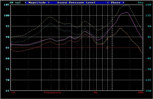

I took the liberty of redrawing your graph to better compare before and after.
dave
dave
I am afraid not. If the shelving filter is removed, all frequencies ahead will not be attenuated. This will be much too bright. The zobel is more elegant, it allows me to tilt whereas the shelving filter is "lift all" like in a preamp tone control.
If you prefer to leave the zobel unchanged, then adjust the shelving filter. It only requires a slight lift, maybe 1dB up.
You can use this EQ circuit as a starting point and make improvements from here. It doesn't solve all the problems but at least the Super12 now sounds quite decent. Even likable at times.

Many thanks for taking the time to redraw the graphs. They don't look that much different but audibly, the improvement is quite good. Perhaps some owners of this Super12CF can offer their views after applying the EQ.

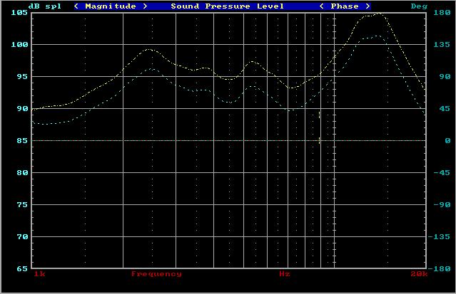

It depends on the listener. All these plots are taken at 1 meter. The top plot, the one that is on-axis, the speaker has been adjusted for my listening distance of 10ft. If the mic is placed at 10ft, the response will look more like the yellow plot.
Some listeners are fine with flat response at 1 meter. For me, at 10 ft listening distance, a speaker with a flat response at 1 meter sounds very dull. The falloff in the highs are too much.
From the plots, we can verify that as long as it is not more than 10 degrees off axis, the response maintains its shape, only the highs fall in level. So, depending on one's listening distance and hearing abilities, one can simply rotate the speakers slightly for the highs to suit his taste. As long as it is within 10 degrees, there are no drastic changes. It is the same as on-axis, just more or less highs.
