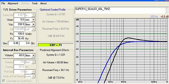

Audio Nirvana Super 12 Cast Frame measured T/S
The Super 12 just came in for testing. Results of T/S are below. Measured with LMS, Delta Mass (20g added weight). Loaded in a 60L Sealed Box. Bass response is adequate for most music.
Regards
Mike
Regards
Mike

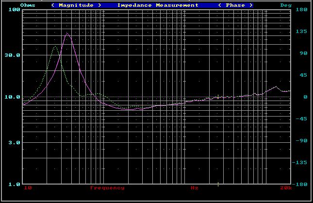

Iam newbee in testing, Why do you add 20 grams mass to the cone??
Gustavo
P.S.: Maybe this 60 litres box is small, do you know the max cubic volume for this SUPER12CF ?
I am newbee in testing, why do you add 20 grams mass to the cone??
When you are testing a driver to determine the complete set of T/S parameters, you need to make two impedance curves.
The first impedance curve is the driver alone from which you can derive the Re, Lvc, fs, Qes, Qms, and Qts parameters.
You also need to estimate the driver cone's Sd using a ruler, typically it is the calculated projected area using the diameter taken at about 1/2 of the surround width.
Then you need to make a second impedance curve after either adding mass (typically small masses, I use US five cent coins because they are 5 gms each) or adding stiffness (mount in a small closed box of known volume) to shift the driver's fs by about 25%. Then based on the frequency shift, and the known added mass or stiffness, you can now calculate BL and Vas. This is done automatically by most testing software. Or it can be done with pencil and paper if you are measuring a driver the old fashioned way with an O-scope, signal generator, frequency counter, and volt meter.
Most books on speaker building will show you how to do these measurements. D'Appolito's book Testing Loudspeakers will tell you both how to make the measurements and theoretically why you are making these two measurements.
Automated testing software/hardware readily available to DIYers make these measurements easy, accurate, and quick. Woofer Tester, Praxis, ARTA, Sound Easy are just a few good examples. You don't need any special training, just follow the directions to get good results.

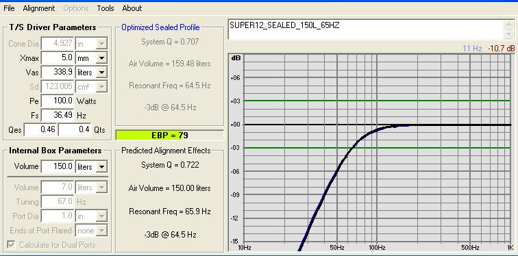

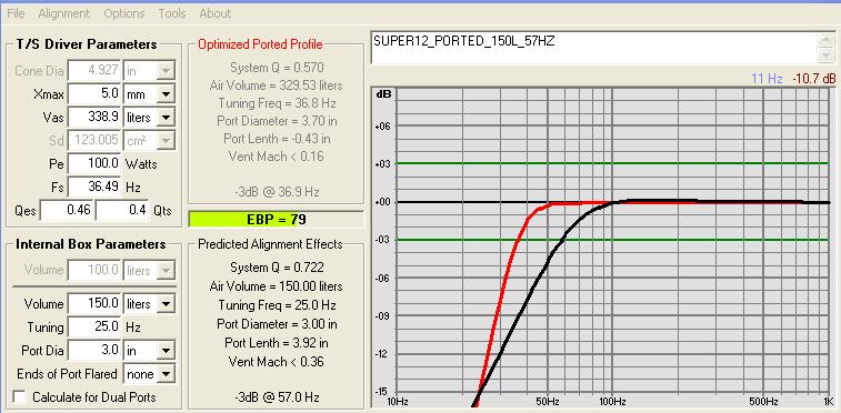

You can see from the Free Air Impedance Sweep that Fs is 35Hz. The green plot is when 20g weight is added to the cone. Fs now is lower at 25Hz. With these readings, LMS calculates the T/S.
This is the first step because I don't depend on manufacturers' T/S. Some can be grossly different. Once with the actual T/S, it is easy to model the type of loading.
Based on a 150L box, a Sealed Box F3=65Hz. When loaded in Vented Box (Bass Reflex), F3= 57Hz. If you want lower, you can go down to F3=37Hz with a 329L Vented Box. That's a very big box for home use.
Personally, I wouldn't load the Super12 in a BR. According to their specs, Xmax = 1.0mm. Much safer in a Closed Box.
I could prefer a sealed box, it is more easy to tuning than a BR. What do you think about a 419 litres sealed box for three Super12CF?

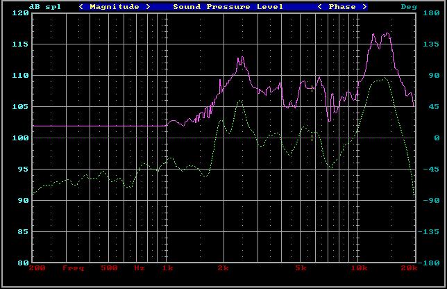

Below are the FR sweeps done at 0.5M_1W. Top plot is a 300 point precision Gated sweep from 1K-20K. Lower plot is without gating from 200Hz, smoothed 1/6 dB.
This confirms my initial listening test. The highs are definitely not well integrated. Quite shocking to see a response like that.
Looks like the tweeter starts at about 1K5 and ends at 7K5. Beyond that, its cone breakup.
Frankly, in its present state, its quite unbearable to listen to. Sounds like a raw extended range PA 12".
I'll see what can be done to minimize these irregularities passively.
