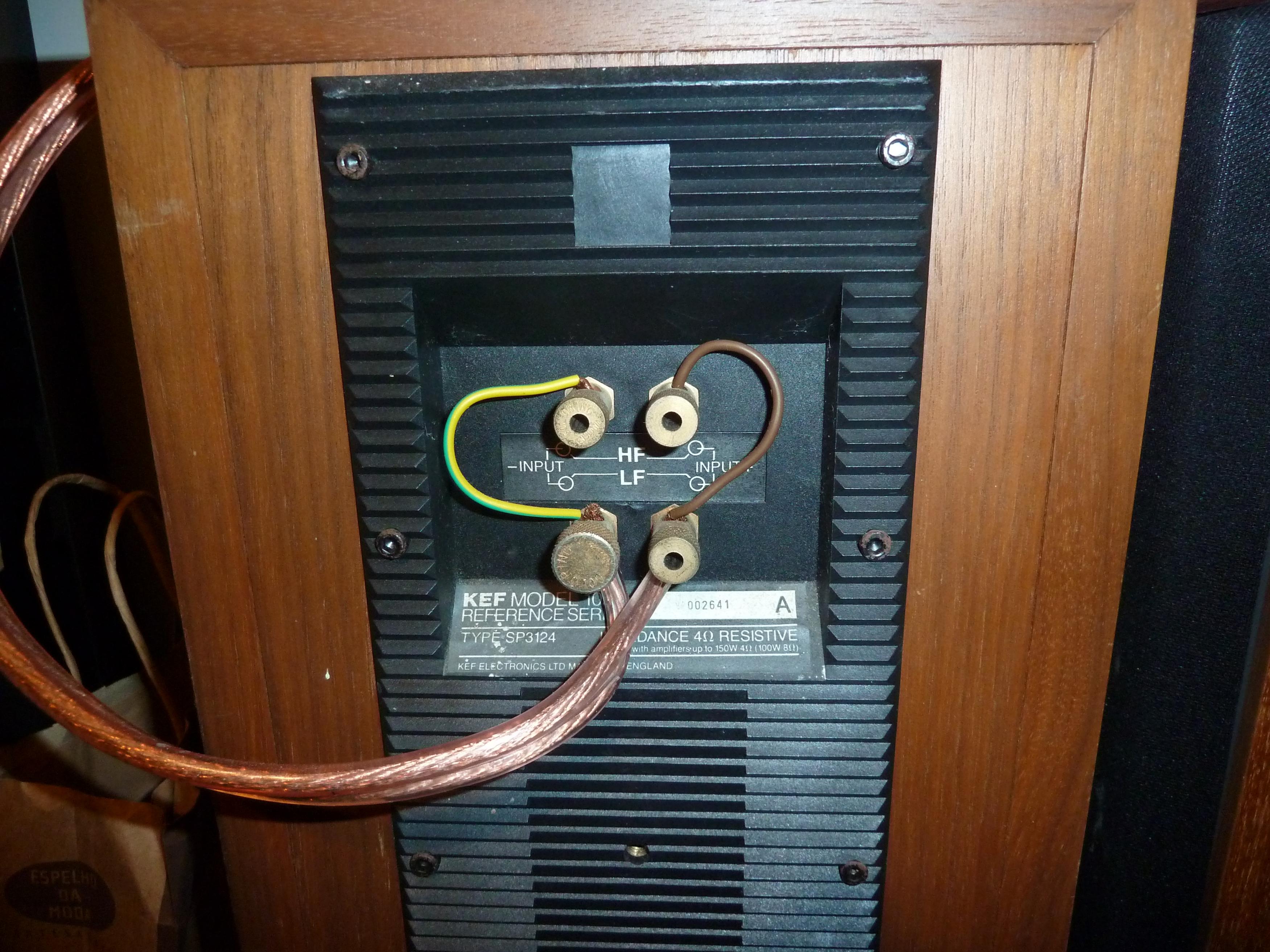

Only realised today - whether this was caused by the way i have these KEFs wired, they come with two pairs of terminals (HF,LF) - I bridged it so it should be connected sort of parallel. (attaching pic).

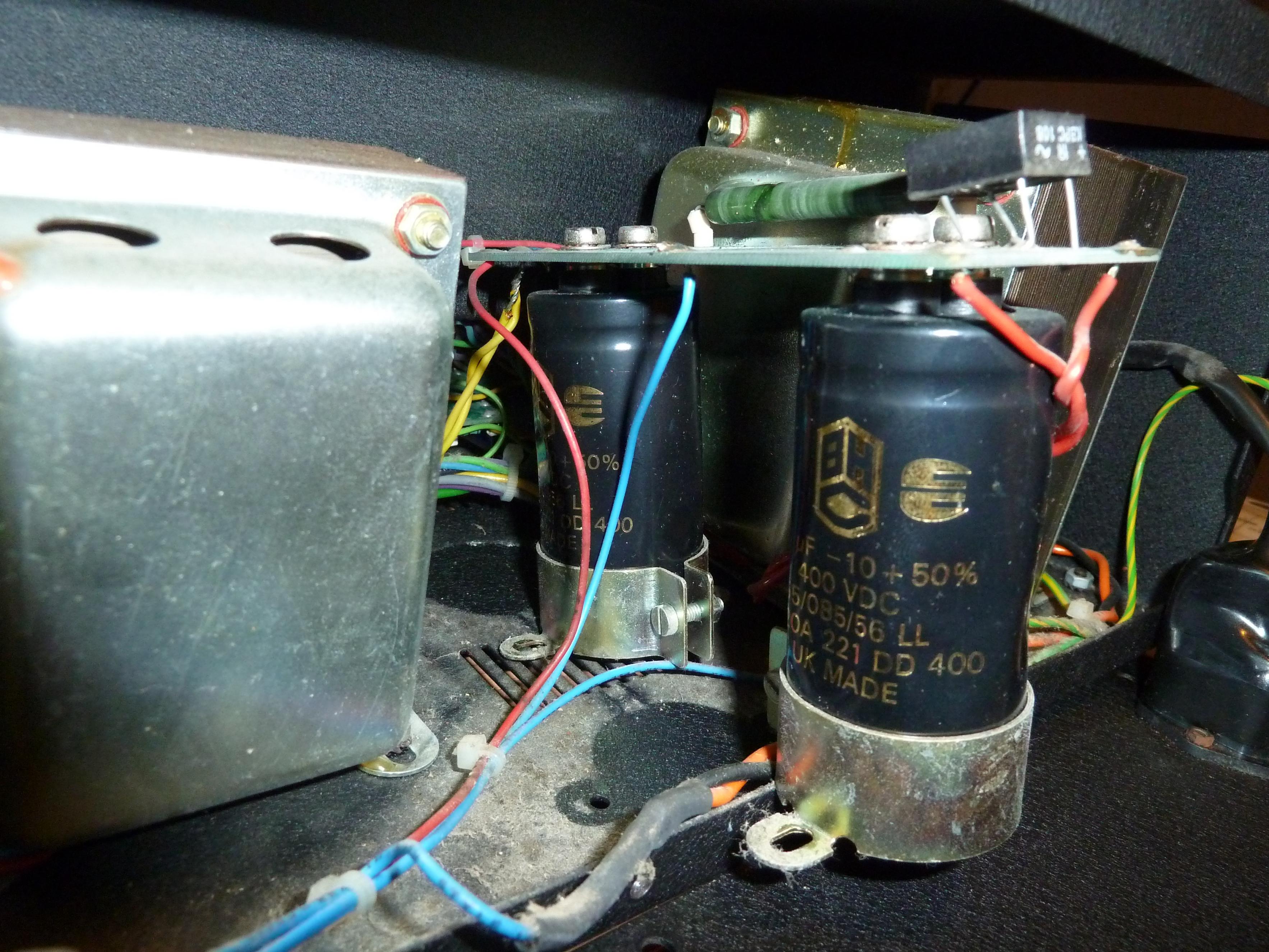

After 25+ years its a good idea to replace all electrolytic caps.
The only exception with this amp is that the two 220uF power caps might still be good. They have been in the 4-5 examples I have worked on.
That is what I thought, though could not know about these filtering caps, maybe i would not order, maybe i would.

I've put HT fuses in 4 or 5 of these, right after the 1st dropping resistor, before the second 220uF cap. I've done the same kind of thing in other amplifiers if it is necessary. They can not be heard whatsoever. Implentation is not difficult. I used sand filled ceramic slow-blow T-250mA 440VAC type. If they do fail they will not "explode". Up to you - I have more than I need.
Your unit is a later model. The earlier ones had Hinchley Mains and OPT's which were superb. The later ones did not. The Hinchley's had 4, 8 and 12 ohm secondaries so are easy to spot.
Your EL34 cathode resistors are mounted on that rather large circuit board which were later implemented. This was a less than clever "innovation", as the earlier models had them attached to the chassis with epoxy which helped dissipate heat. I have seen nice dark heat marks on some of those boards.... I also see the blue Philips cathode by-pass caps on the board as well
In two of the units I serviced, the DC filament bridge had gone - they sometimes used very cheap components. It looks like they used a cheaper HT bridge as well in your version. How sad - decent quality rectifier bridges are fairly inexpensive today.
The HT circuit board appears also to be a newer "innovation" that makes little sense. This is the first time I see this board. It would perhaps make implementing a HT fuse a bit of a bother.
I've just gone over another AI "first" amplifier. As in all of them, the electrolytics needed replacing. Believe it or not, I had to de-gauss one of the Hinchley OPT's in that amplifier. It now sounds better than new.

Btw, those KEF speakers have to be wired the way i did, obviously from the factory they used a gold plated piece of metal strip...

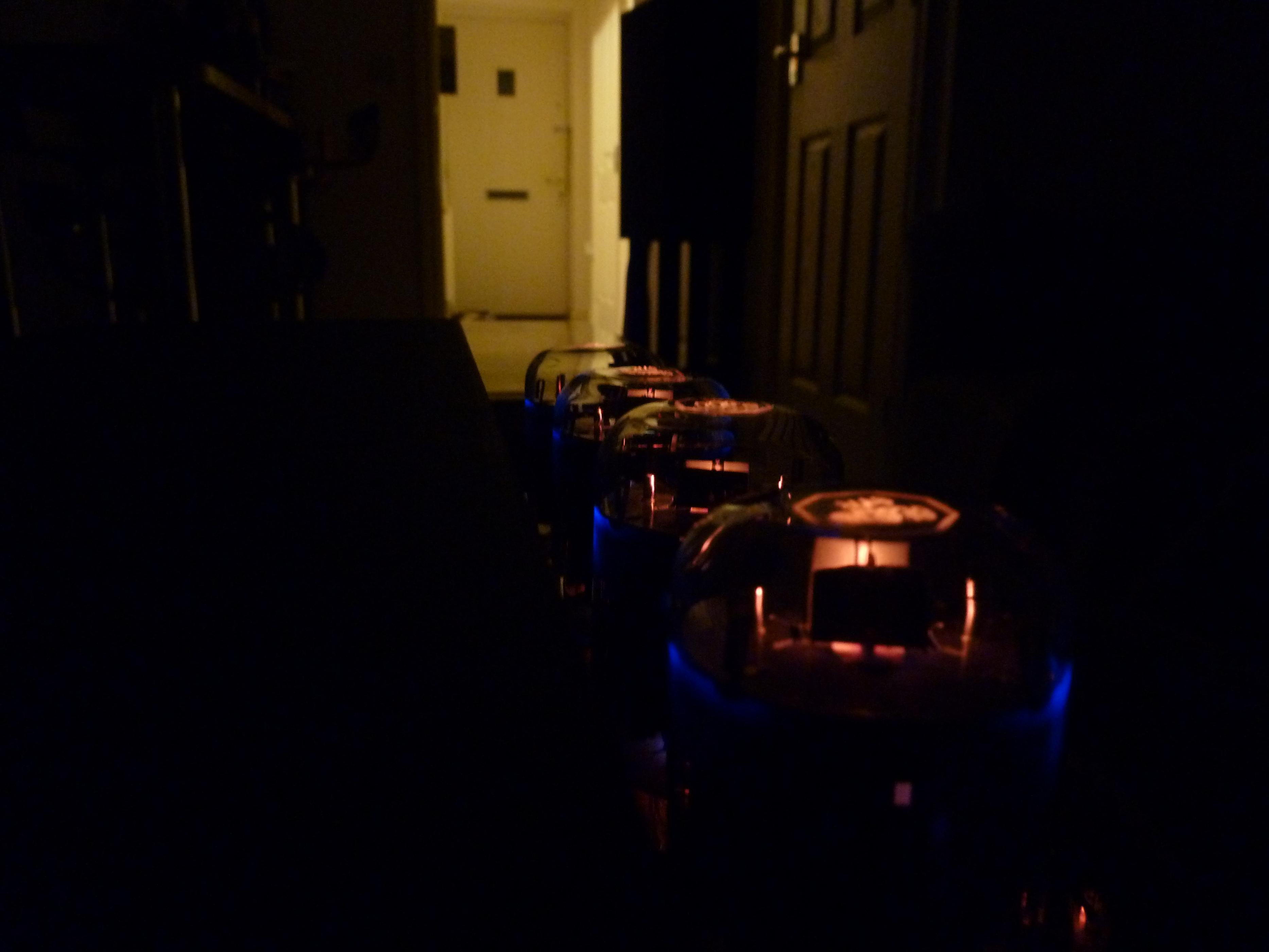

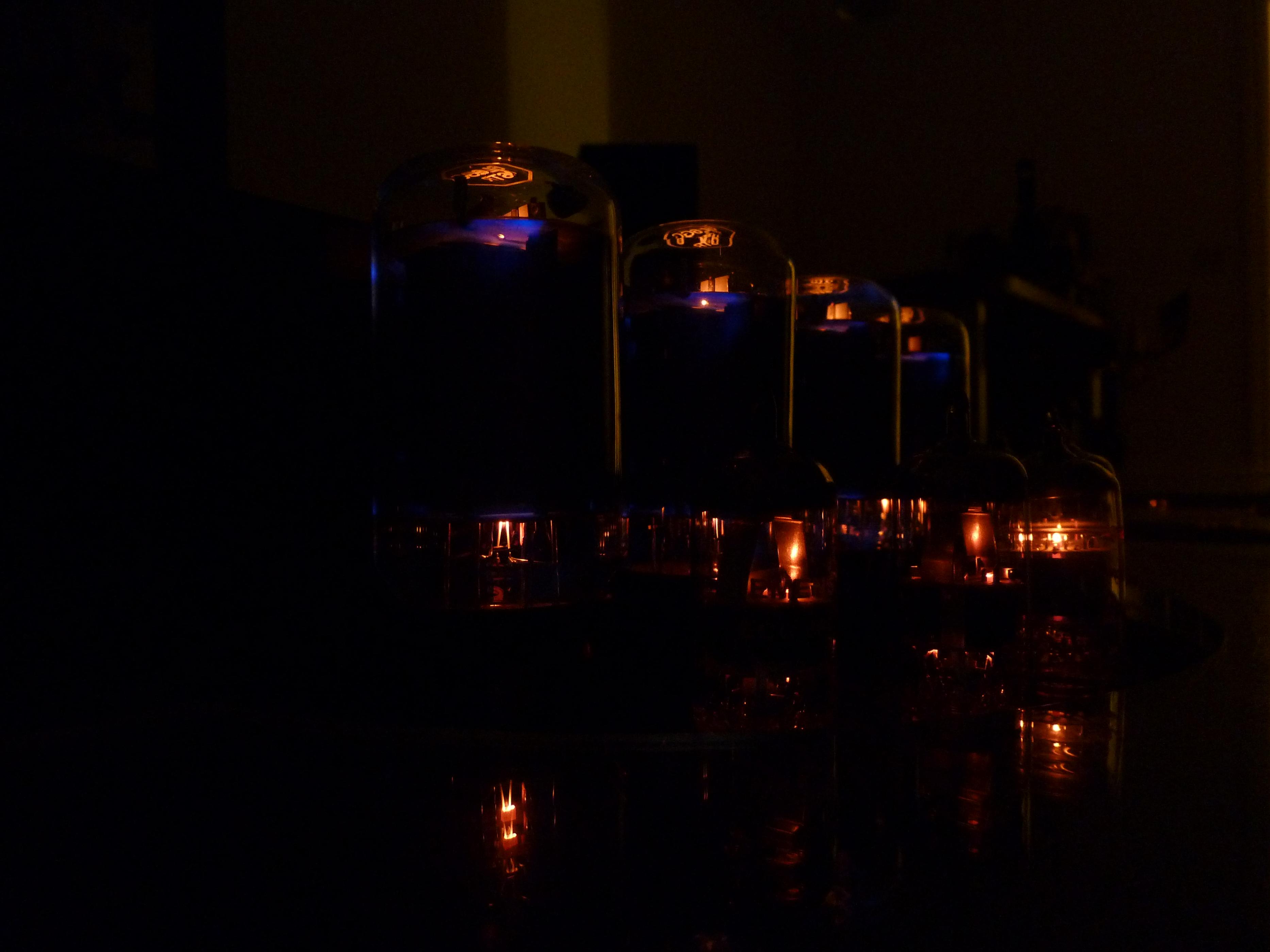

Switched it on one of the evenings and to be honest panicked a bit first..
I am off on Friday, will finally get it fused.
