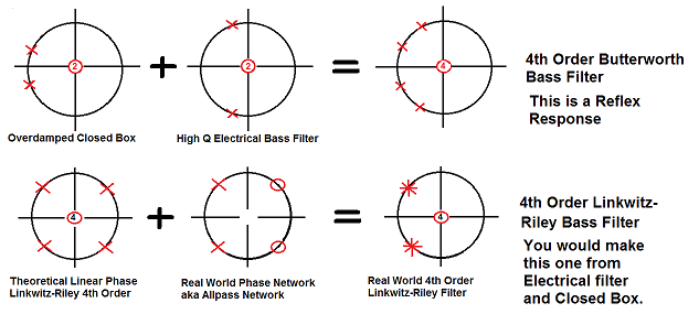

Oh dear. This thread is descending into unreadability, as usual. IF you want to understand GROUP DELAY, you will doubtless attend lectures on Linear Signal Processing:
EE2/ISE2 Signals & Linear Systems
But for those of you who don't have much time, I can reiterate it or explain it to you fairly simply. 🙂

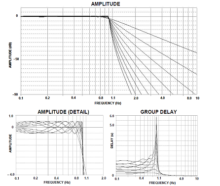

Real world steep filters produce group delay. That's it really. We had a rambling thread on the advantages of 6th order bass reflex speaker tuning as frequently used in active studio monitors. What it ignored is that steep reflex bass filtering also produces SLOW BASS or DELAY! Which is why closed box has better timing.
You can do tricks with digital filtering to produce linear phase, but with real world filters, group delay goes hand in hand with filtering. A theoretical ideal linear phase 4th Order Linkwitz-Riley comes with a bit of unwanted baggage. It's an ALLPASS network, that has energy storage or ringing or Group delay, whatever you want to call it.
You have to be open to the powerful Pole-Zero representation of filters to get it, but below is how it works. I can't explain the maths more simply. 😎

Just a simple capacitor demonstrates group delay.
Voice coil and capacitive loading effect of air on drivers cause group delay.
Audibility occurs when delay of a particular sound's fundamental alters the attack sound of instrument, and timbre of sustained notes. Most often this can be picked out with percussion, and with other instruments with bass range fundamentals. Picking out differences generally require being able to directly compare two systems with significantly different group delay characteristics.
This is complicated by group delay behavior of virtually all speaker systems. Modifying group delay character of signals for playback can be revealing.
Group delay effects for most people, listening to most material, on wide range of speaker systems has no detectability.
It is easy to induce audible levels of group delay via high order filters, and this has practicable impact on crossover design.
