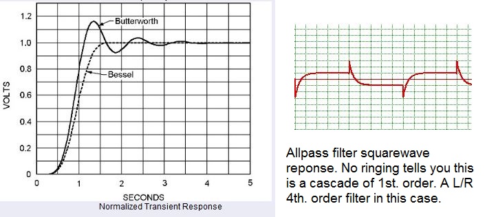

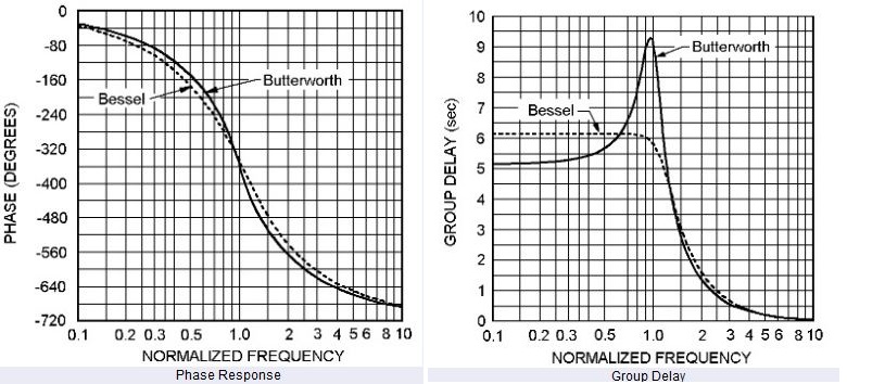

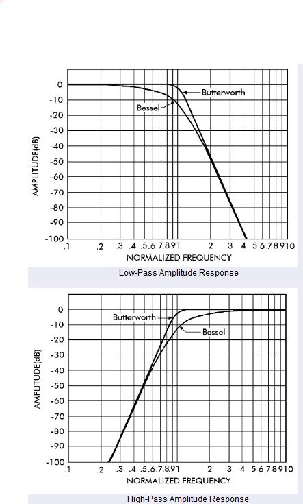

Group delay is a subject I studied as an engineer on telephone and data lines and at college purely for interest. So I'll tell you what I know. 🙂
Group delay is the rate of change of phase wrt to frequency in a channel. It describes the delay in the flow of information in a channel. Having built allpass opamp filters (which have flat frequency response but time delay), we could never actually hear ANY difference whatsoever, but it ought to be something you minimise. A filter with a high "Q" has more group delay than a filter with a low "Q". It makes sense that if energy is stored by a high "Q" electrical or mechanical filter, the time release of that energy is smeared and delayed. Ist. order RC filters introduce a constant delay at the bass end, 2nd. order allpass RCL adds a sort of ringing to the waveform.
High "Q" and steep slopes should be avoided. This equates to big closed boxes, even Acoustic Suspension, for fast bass response, and low "Q" Linkwitz-Riley filters for your crossovers. I won't opinionate about this too much, but here's the graphs. Group delay is really unavoidable in real time, but spatial filtering or digital techniques can avoid it altogether. In real time it is worth noting that smooth transitions at speaker and cabinet edges also minimise ringing.

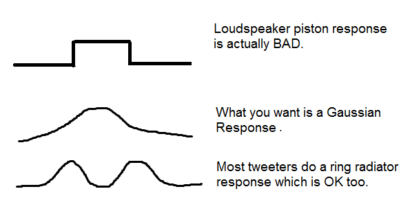

I should add a surprising finding from antenna theory. You actually don't want a loudspeaker that behaves as a rigid piston. The fact is a square or sharp circular aperture radiates very badly into the far field. Far better is the Gaussian aperture with a smooth rolloff at the edges. This is because the Gaussian aperture is its own inverse in the far field, so is mathematically perfect. It's the same thing of sharp transitions ring, smooth ones don't. 😎
