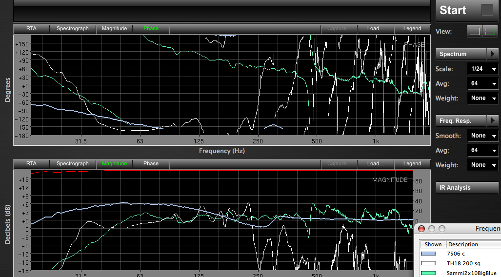

Cabinet decisions should be made with the sound pressure level level desired, BR,TH,and BP type boxes all have a big level advantage over sealed subs.
Since you are limited to around 7.5ms of time correction, cabinet designs showing more group delay at the crossover point would not be a good choice.
The TH 200 sq shown below, a long path tapped horn, requires a bit more than 7.5ms to align a sealed top cabinet.
The Sammi is a ported cabinet using a pair of $5 speakers, it would require little or no delay to align with a sealed top cabinet.
The 7506 is a Sony 7506 headphone, used worldwide in studios and soundstages. It has fairly flat response, where it is flat the phase response is also flat. Unfortunately for the screen shot below, most of its response happens to fall at about -180 degrees, so much of the trace ends up not being visible, it would be right at the top or bottom of the display.
Phase and frequency response are reciprocal, if DSP is applied to flatten the frequency response, it also flattens the phase response. If a PEQ setting were applied to correct the 7506 broad boost centered at 60 Hz, and the dip at 250, it’s phase response would also flatten out.
Same with the Sammi problem at 475 Hz.
The TH response above 250 would require far too many filters to correct, but sounds quite good in it’s intended pass band of 30 to 100 Hz. It would require sealed top cabinets to be delayed by around 9ms optimally.
The difference between 7.5ms and 9 is within 1/4 wavelength at 100 Hz, so your DSP would still work fine for that large tapped horn, but many home theater type TH designet to work down to 16 Hz would require twice that delay time to be integrated perfectly.
That said, there are many proponents using several subs all around the room without any time alignment to even out room response, things can subjectively sound good even though that type of set up is terrible when phase or group delay is considered.
In a small room, getting too picky about phase/group delay is akin to complaining about a kid with a squirtgun shooting at you in a rainstorm.
