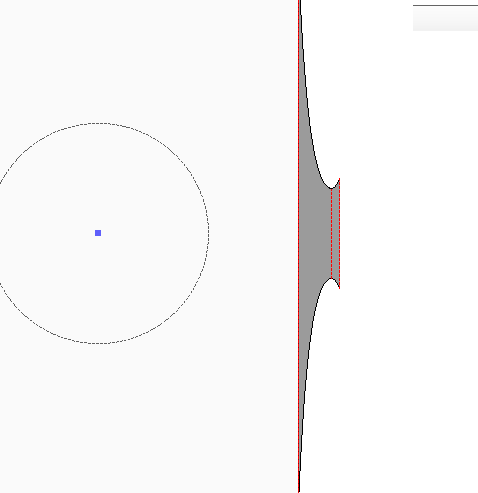

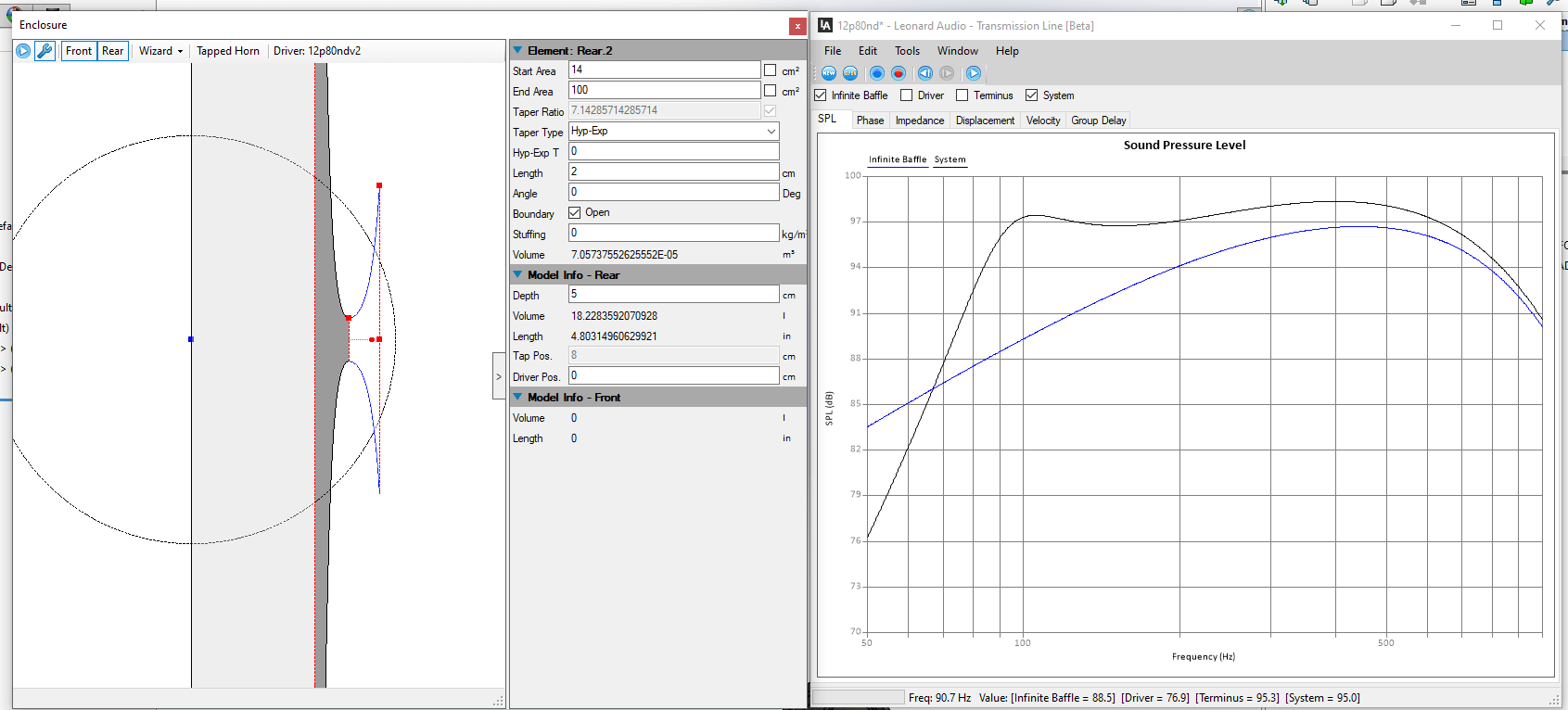

I used the Leonard Audio Transmission Line tool to model the 12p80ndv2 box with a large (32cm OD), shallow (3cm total) exponential rear port stuffed with 35kg/m3 material. Effectively aperiodic. I added a rear panel flare to tame resonances, port noise & air speed. Took just a few minutes to home in on good dimensions.
The whole exponential area / dark grey area shown in post 8. My apologies. I made the assumption that readers would recognise screenshots from Leonard Audio.Stuffing was applied to the port opening only? Can you please explain your considerations and why you choose this port over a conventional port?
I wanted a lower f3 than just a sealed box could give (~200). Aperiodic loading could provide a lower f3 point whilst maintaining excellent transient response.
Think of this port as a very short tapered transmission line.
In Leonard try switching between fully sealed, a round reflex port, a short exponential stuffed port and even a aperiodic port like this commercial offering
https://willys-hifi.com/products/scanspeak-aperiodic-variovent-290001
See what happens to resonances and low frequency extension. Tweak dimensions to suit your driver choice, transient and response goals.
I can prepare screens to compare various 12p80nd options if you wish to review?
“The Scanspeak Variovent or 'Flo-Vent' is essentially a resistive reflex port that offers controlled cabinet venting at low frequencies. Installing this vent in a sealed cabinet effectively lowers the woofer Q factor & increases the theoretical cabinet internal volume by a fifth, as seen by the woofer.
The aperiodic vent bridges the gap between infinite baffle & reflex designs, it allows deeper bass from sealed cabinets whilst offering a 3rd order final rolloff, resulting in an improved transient response over the sharp 4th order of traditional bass reflex designs. It is tempting when designing smaller systems with high compliance woofers to use small diameter, longer reflex ports to obtain a low tuned frequency - this can however give rise to chuffing noises from the port - the Variovent does not suffer from this.”
At xmax the 12p80nd would move a lot of air! I didn’t fancy making accommodation for chuffing ports.
I wanted to flatten the response so I would not have to add (too many) additional opamp stages to compensate for a sealed box.

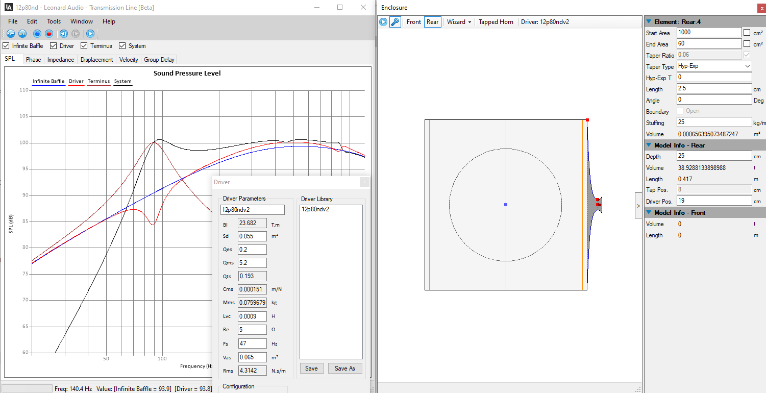

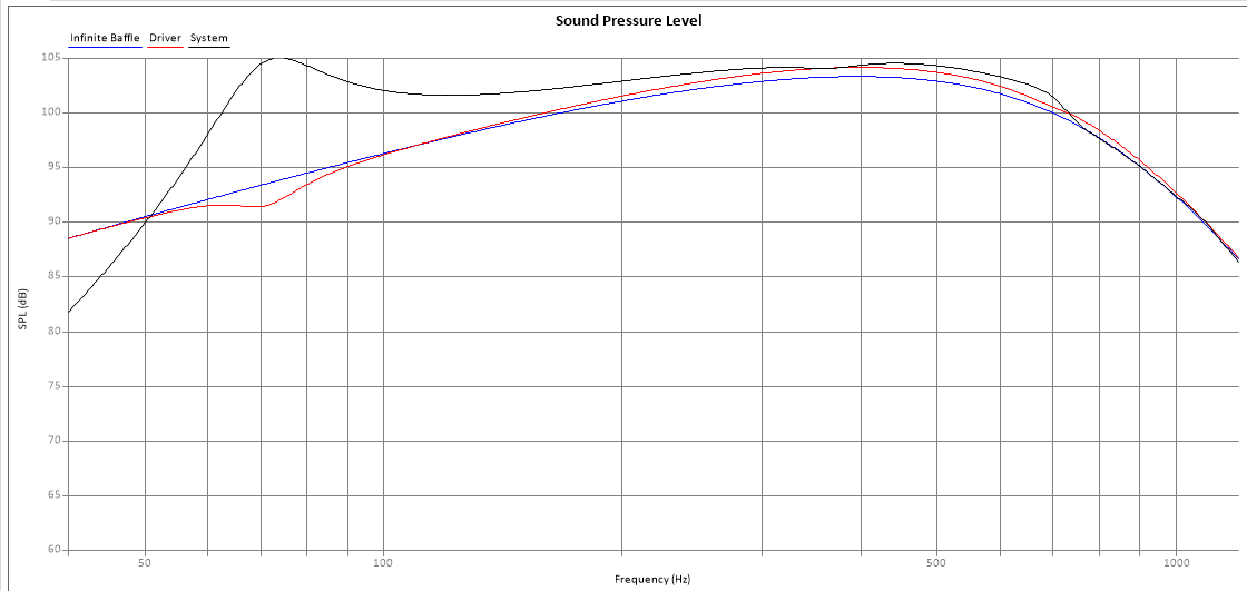

From the previous design in post 1. You’d need to set your driver, alter to your cab dims and such. Trial and error. Should set you on the right path though.
I've attached my Leonard Audio file for the 12p80nd. 40L volume with exponential short rear port a la @LineSource posts from many moons ago.
Feedback welcomed.
Feedback welcomed.

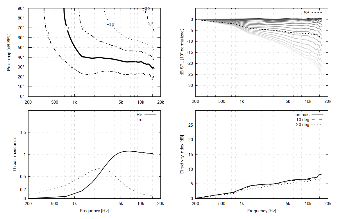

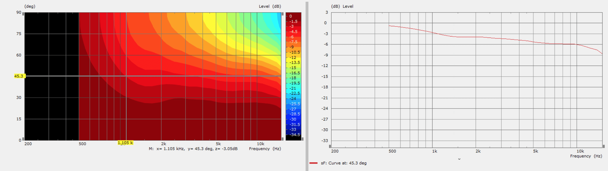

I'm eager to try the next version of ATH4 with box design scripts. I imagine the cabinet shape and location of the wg above will massively increase complexity / CPU calc time as we will no longer be dealing with just quarter symmetry.
In the meantime, please find attached wg at 20/30/45deg. This is just about as clean and linear as I can muster. No doubt it will change once boxed.
What do you think?
What do you think?
