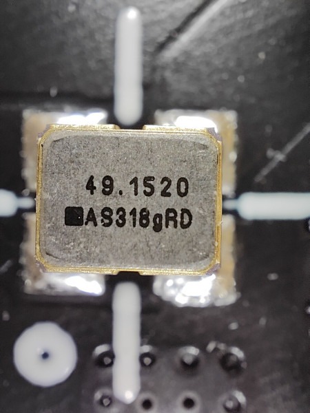

The stock clock is AS-318.

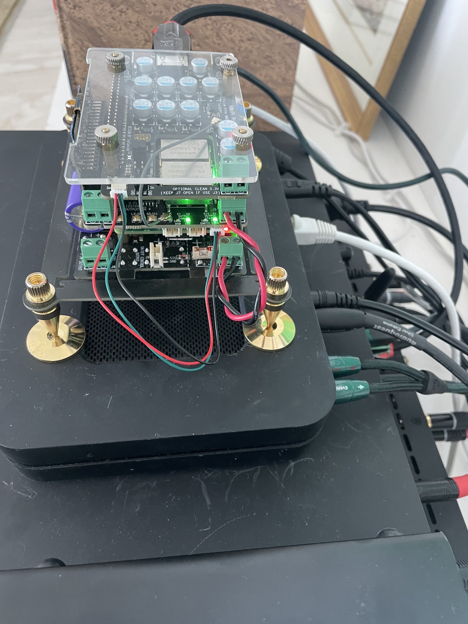

Total newbie here trying to stream the fifopi q7 into my Gustard r 26. Everything works well except I can't get the r26 to accept the fifopi's clocks since it always says ext err on the led screen. I get sound but must revert to the r26 clocks instead to eliminate the err. I've tried every imaginable setting option on both the r26 and thru the monitor controller on the streamer. Has anybody experienced the same issues?
