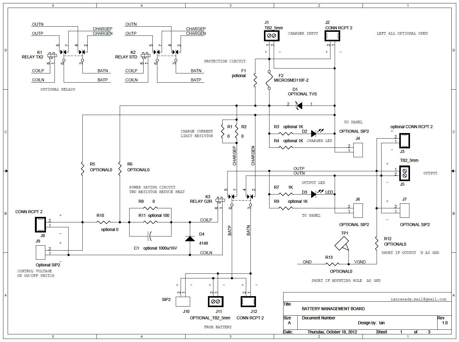

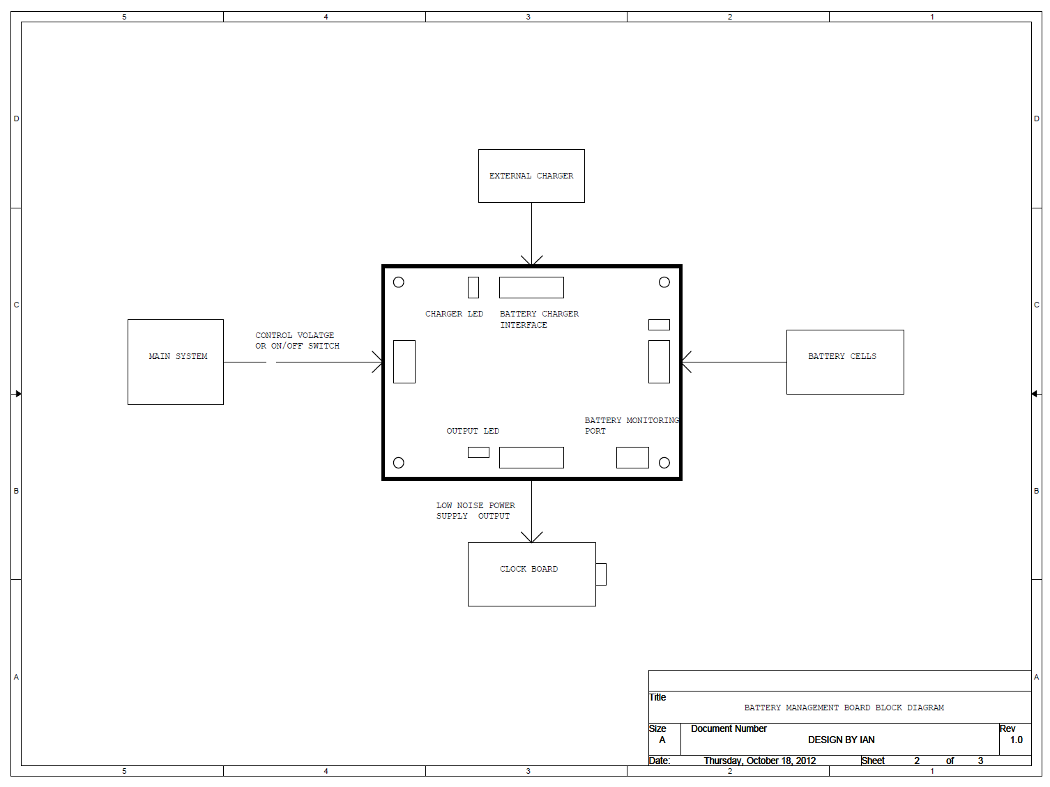

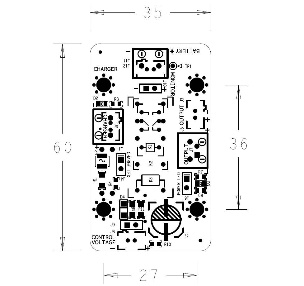

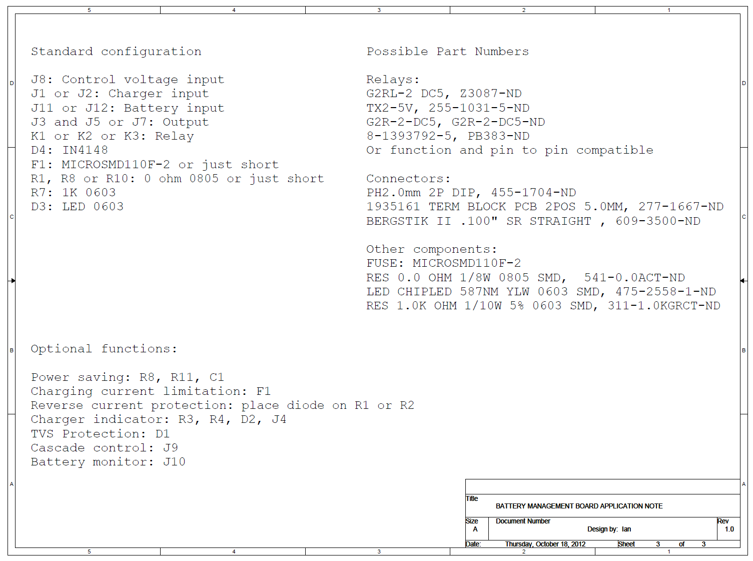

Schematics and BOM of the passive battery management board
The passive battery management board is approved functional. I know it’s one of the best solutions providing clean battery based power for isolated clock board and DAC. So I decide to list it on the next GB.
Here I attached the schematics, BOM and PCB silk screen. The principle and schematic are very simple, I don’t think I need making any note on it. Beside the standard configuration, there are a lot of optional functions, but you have to figure out by yourself.
In order to make sure everything is OK before the GB, I’d like to provide 10 free PCB samples for evaluation. To save time for both of us, please list your ID on the list below by yourself if you decide to apply, and then at same time, send me an email at iancanada.mail@gmail.com with your apply number, diyAudio ID and shipping address. PCB will be shipped next week. Apply will be closed if 10 names on the list already. Please let us know your testing result.
Ian
