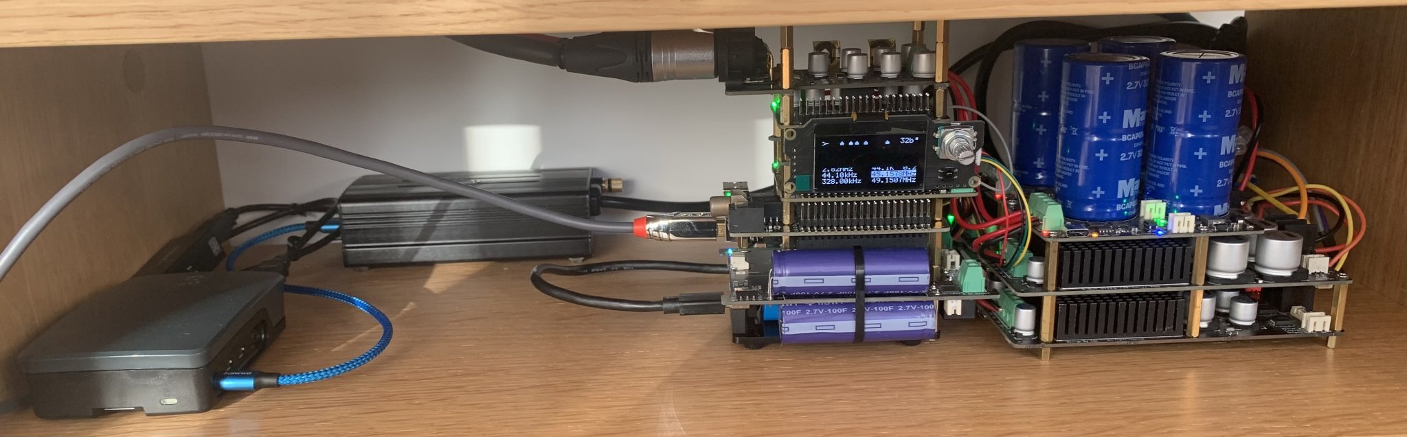

A short disciption off my Ian system
PI4 with picoreplayer LMS, LAN connected
PI4 with picoreplayer Squeezelite, WIFI, USB2 connected (recommended by SMSL), Allo power supply.
Topping HS01 USB isolator
ReceiverPIDDC with Amanero
FIFOPI Q7 with SC-Pure
ES9038Q2 in true sync and DPLL stopped
OPA861IV
And MonitorPIPRO
Powersupply:
LinearPI 5vdc to PurePI.
5vdc for FIFOQ7 from PurePI.
3.3vdc for FIFOQ7 from LinearPI.
3.3vdc for ES9038Q2 (AVCC and DVCC) from PurePI.
+/-5 vdc to OPA861IV from LinearPI mkII and UcConditioner.
And the angels sing🙂

Lso, would it be possible to upload a couple of photos of your system? It sounds like a really loaded one. 😉

Great stuff, Lso!
Have you seen any value in the MonitorPi Pro? Do you use it just as a display or also as a functionality controller?
And another question. How happy are you with the overall sound quality?
