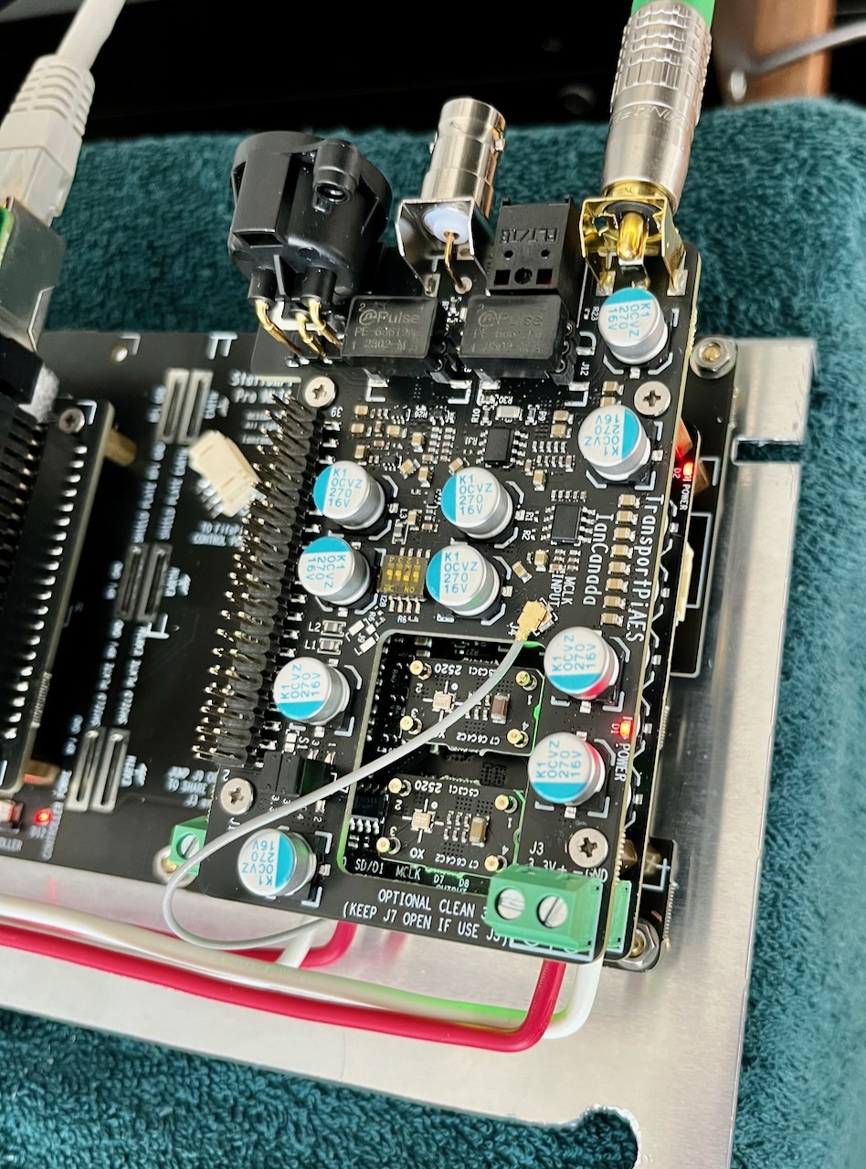

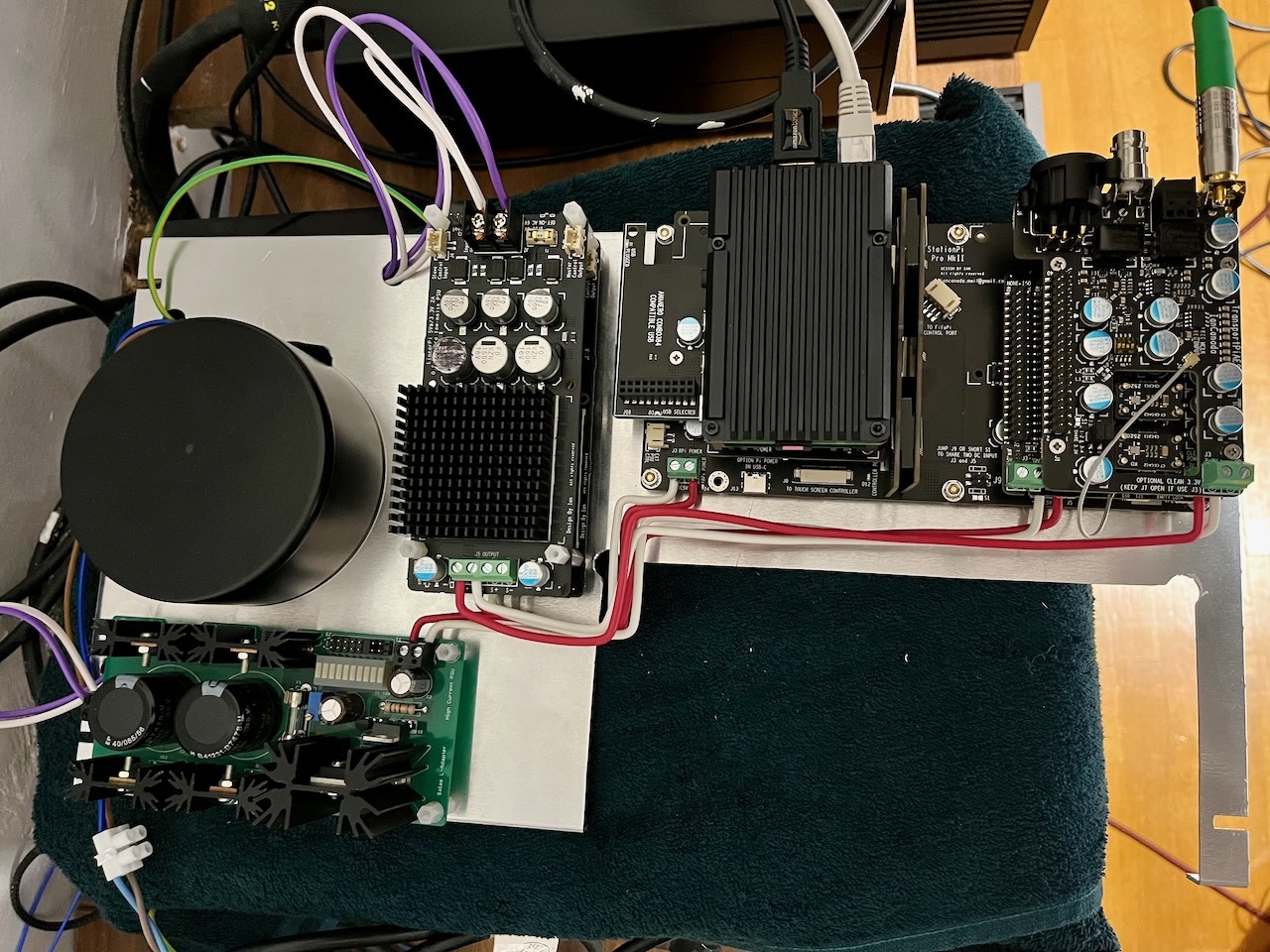

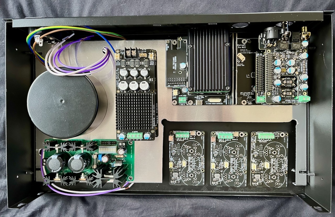

As a newbie with DIY digital sources, I have recently purchased a series of Ian Canada products, to build a 'flagship' streamer for my non-oversampling DAC (LAB12 DAC1+). The streamer consists of:
  • StationPi Pro
  • LinearPi Dual
  • Salas L-Adapter
  • 3 UCConditioner MkII boards
  • FIFOPi Q7
  • TransportPiAES
I have put (almost) everything together, apart from the 3 ultracapacitor boards, which will be placed and connected after a few days.
I am using Gentooplayer with Logitech Media Server, Squeezelite and Qobuz.
Although the system works fine, when streaming directly from the Rpi4 USB port (positioned on the StationPi Pro board, of course), the IAN Canada transport does not send music to the DAC, when the TransportPiAES is connected via the SPDIF coaxial cable to the DAC. All lights of the various Ian Canada cards light up as expected, and the streamer 'locks' fine with the DAC, when the SPDIF cable is connected (see photo with arrows).
Initially I used the 'IanFifoII' DAC in GentooPlayer. But I have also tried other DAC options, but without success. I am not sure whether I have a hardware (FifoPi Q7? TransportPiAES?) or software problem (GentooPlayer?).
Does anyone have any suggestions about what might be wrong and what I should test?
Thanks in advance for the support.
Panos
Athens, Greece

Hi Panos,
When using Gentoo, you can stream only from one output at a time, so either RPi-USB or the Q7/TransportPiAES. For Q7 to be utilized, you could try "i-sabre-q2m and I2S Generic" driver or similar.
And at the same time, you also should select the corresponding "audiocard" in 06. Player/Audio settings -> Squeezelite settings.
Few suggestions:
I got better results with Squeezelite-R2 than the classic one.
Experiment with kernels, many got the best results with EUPNOR/EUP100NOR variant. Version selection (6.1 vs 6.6) is a matter of personal preference. Also don't forget to set the profile and activate RAMsystem. There are a lot of other tweaks, but these are the fundamental ones.
Anyway, for the absolute best results I highly recommend setting up your new streamer for Diretta Target only and let the server duty be carried out by some other PC/Rpi. Once you try, there's no turning back 😁
There's also a support forum for Gentooplayer with other great guys and admins willing to help with these matters: https://audiophilestyle.com/forums/topic/55235-gentooplayer/page/233
Reactions: pkonstantinidis
Hi Wladimir,
thanks very much for your insightful instructions. That's indeed quite a lot for me to absorb.
The problem that i am currently facing is that I cannot make the Q7/TransportPiAES to work. It 'locks' with my DAC, but unfortunately does not send any music. All the lights light up, so there doesn't seem to be any hardware problem, but then again... no music. When I press the play button on my LMS, the 'lock' light of my DAC (which is already on) bleeps instantly, but nothing happens.
I have tries the I2S Generic driver, as well as a bunch of others. No good.
So, how can I determine whether I have a hardware or software problem? Is it possible that any of the StationPi Pro, the FifoPi Q7 or the TransportPi AES have a problem? Do I have to do something with the J17 jumper on the StationPi Pro? For the moment all pins and open.
Any clues about I should find my way out of the tunnel towards the light?

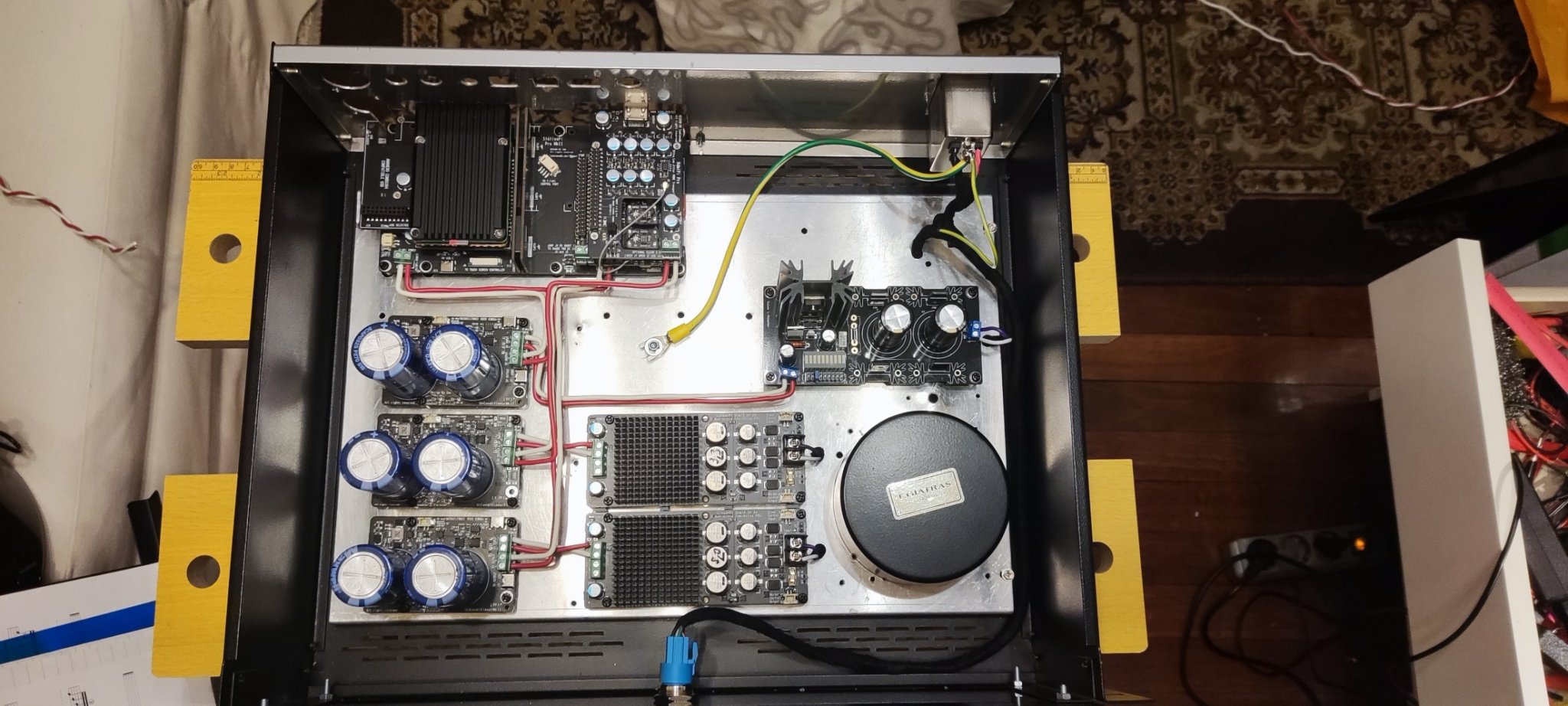

Hi, in my case Gentooplayer does not play with I2S Generic or i-sabre-q2m ONLY IanFIFO II setting. And sound device/card : card 0: sndrpihifiberry [snd_rpi_hifiberry_dac], device 0: HifiBerry DAC HiFi pcm5102a-hifi-0 [HifiBerry DAC HiFi pcm5102a-hifi-0]
Also in my case better results witn Squeezlite and not Squeezlite-R2 this can be system specific but i have very good analytic system.
In Panos case which i helped him with the installation, i suspect there might be a problem with the Station Pi Pro, someone mentioned bad solder in some pins, which ones have to be reflowed?
Can someone help to troubleshoot this problem, i have set his the same as mine (which by the way works perfectly) and the only difference between his and mine is that i use Hdmi pro .

Hi Badd99,
thanks for your recommendations. I've followed the guidance of Chris1967, who is more experienced than me on digital issues, and that's why I've started with GentooPlayer. Chris1967 is very happy with this Ian Canada setup, while I cannot get mine to work via the SPDIF connection of the TransportPi AES. In my case only the USB connection of the RPi works (placed on the StationPi Pro, of course). The difference of my system with that of Chris1967 is that I have a TransportPi AES, whereas Chris has an HdmiPi Pro.
I am puzzled about the source of the problem. Hardware or software? That's what I am trying to figure out, but I do not know how to go about it.
Any ideas perhaps?
Please guys, we would like help in troubleshooting the problem, we dont want usb solutions.
We are also in contact with the developer of Gentooplayer Antonelo.
Here we are asking what we can do to see if the hardware is working or not.
My build is working 100%, but i have Hdmi Pro in stead of Transport Pi, we are trying to establish if this is a hardware malfunction.
Thank you.
