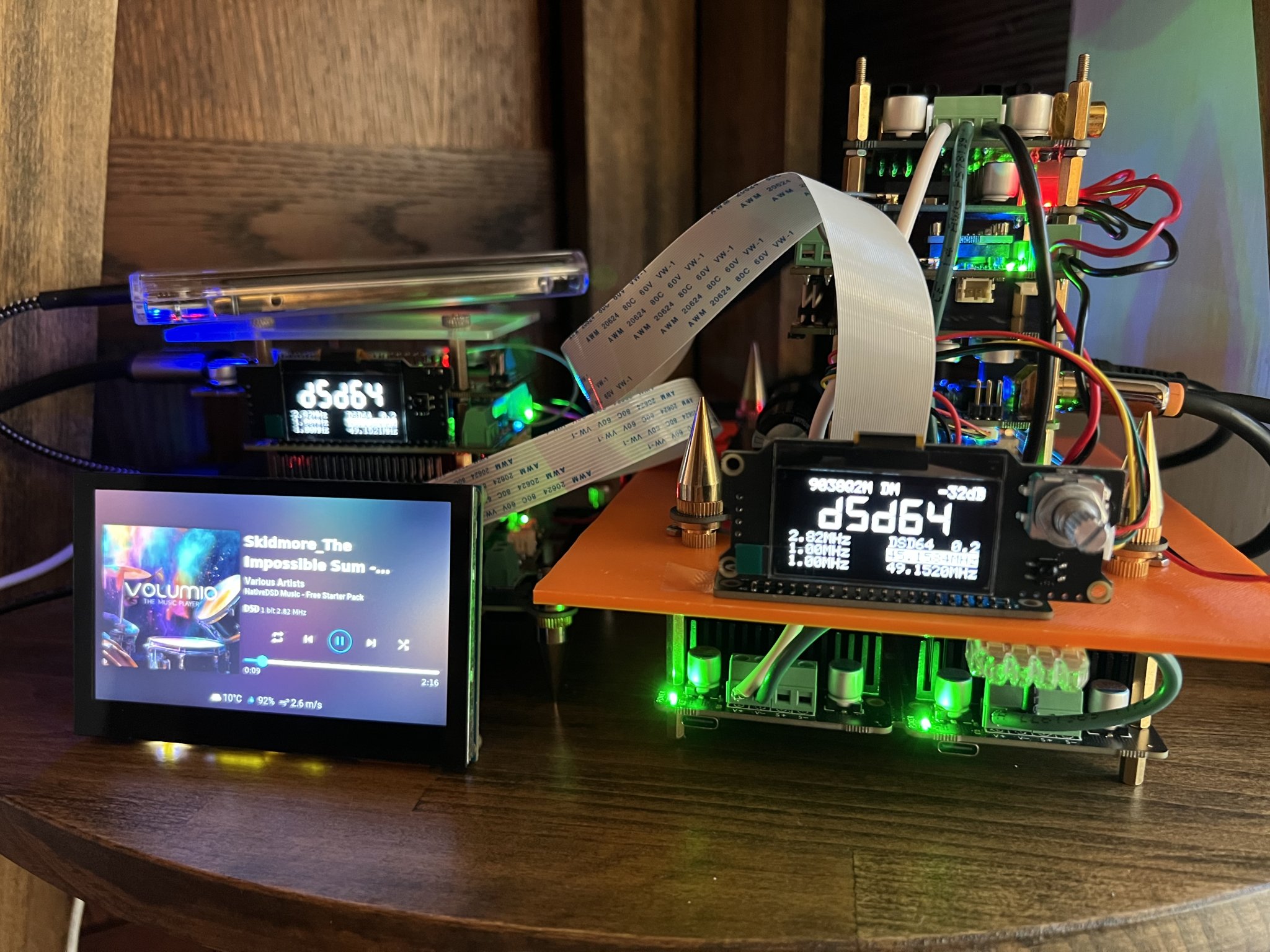

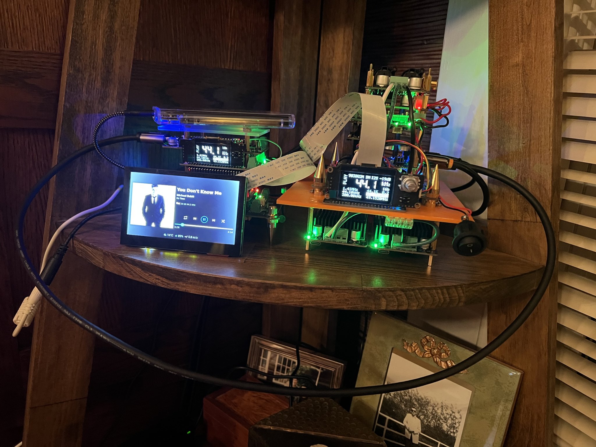

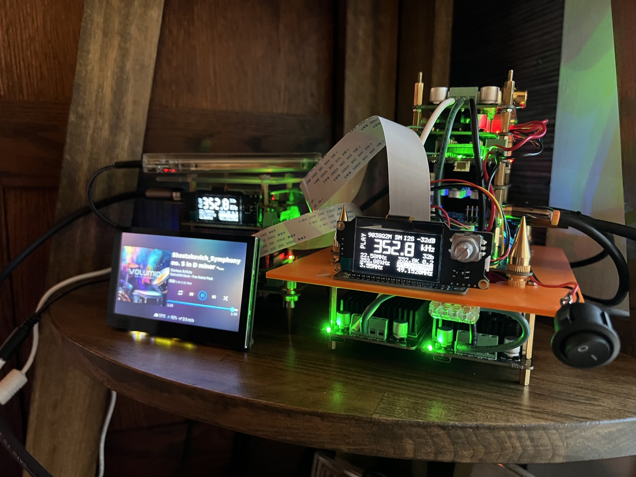

My streamer stack rebuilt with HDMIPro transport board and connected to my recently built DAC stack via ReceiverPiPro II via HDMI input. MonitorPi on streamer and MonitorPiPro on DAC. DAC output to powered professional studio monitors speakers via OPA861 I/V analogue board. Both stacks powered by PurePi II. Linear Pi Duo for the DAC output board. Irreverent DSI screen and SSD FLAC drive on the RPi4 streamer. IFi X 3 amp supply for streamer. IFi 2.5 amp for DAC. Dual 12v DC bricks for the linear duo.
May separate screen and music one day to a separate box but for now I’m loving it.
Thank you @iancanada for all the advice and guidance and newbie questions.
Now to figure out how I want to package them up but for now enjoying the bliss with a 🍷!
There is a lot of capability and power and sublime sound 🎶!

? How can the modules be used without RPi? Aren't all the modules based on working with RPi? At least you need to get the I2S from somewhereNo. Ian's modules can be used without RPi.
Not even the RPi. The Linux kernel running on the RPi. If you see link above I posted yesterday re gentooplayer, that kernel i believe can do the rates you are looking for at least the start guide indicates this.So, after reading almost all Ian's manuals, Amanero and pretty much all threads I could find here on diyaudio and roonlabs community it boils down to the capability of the RPi? Since it plays DSD256 over usb out of the box I thought there where hope. The point of using I2S is to keep the signal clean and native.
See my Post from yesterday. DAC on the right has no RPi. Streamer on the left does. i2S over hdmi from streamer to DAC.? How can the modules be used without RPi? Aren't all the modules based on working with RPi? At least you need to get the I2S from somewhere
Maybe, but using DoP for DSD. The I2S inputs on the DAC are for native DSD. DoP is used over coax and AESNot even the RPi. The Linux kernel running on the RPi. If you see link above I posted yesterday re gentooplayer, that kernel i believe can do the rates you are looking for at least the start guide indicates this.
It seems to me that you probably didn't read Ian's instructions carefully... I think each of them mentions " Rpi free mode" (FifoPi , ReceiverPi ,HdmiPi, ReclockPi ...)? How can the modules be used without RPi? Aren't all the modules based on working with RPi? At least you need to get the I2S from somewhere
On the Ian DAC I built HDMI is i2S. I’m playing a DSD right now on the DAC I built native DSD not DoP. Streaming from the Pi. It’s only 64DSD cause I’m not into DSD yet. It plays natively or DoP in my Volumio player and through the PiLess DAC I built. See screen cap and DSD on the Volumio screen and the deets on the monitor pi.Maybe, but using DoP for DSD. The I2S inputs on the DAC are for native DSD. DoP is used over coax and AES
I’m a newbie to DSD
When I play in DSD in DoP mode I get this view on the monitors. These files are from a free DSD starter pack I downloaded.
You, probably right. I have read like 1000 pages the last few days. so my head is spinning a bit. I think DSD64 and probably DSD128 should be good to go. I started looking into the PBi project less than a week ago.It seems to me that you probably didn't read Ian's instructions carefully... I think each of them mentions " Rpi free mode" (FifoPi , ReceiverPi ,HdmiPi, ReclockPi ...)
