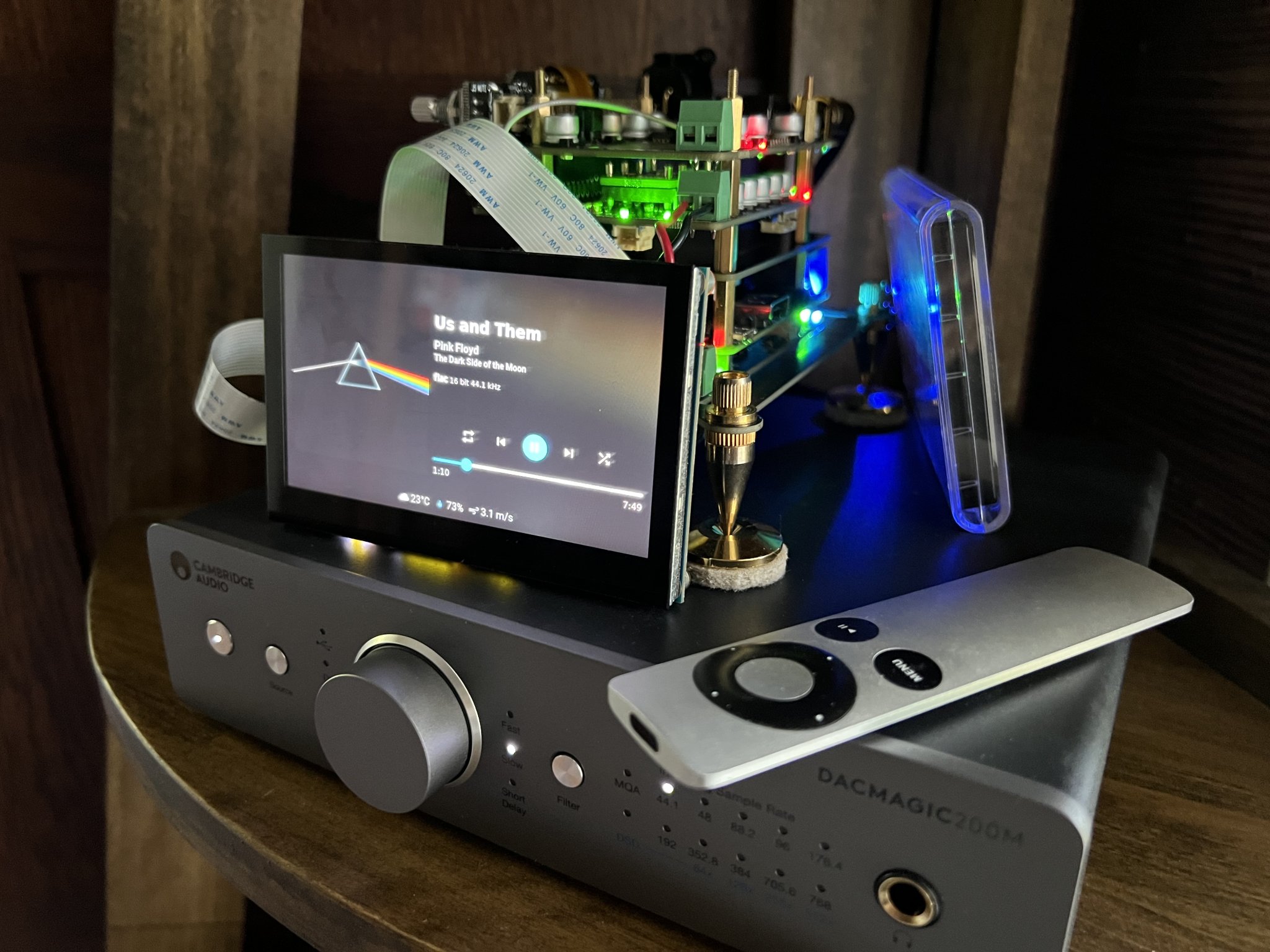

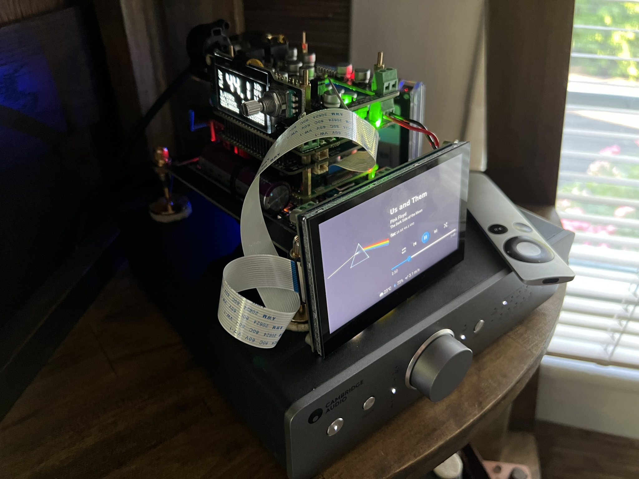

Ultimate DIY streaming stack
0. Spiked feet 👣 for that lunar lander 🚀 look
1. PuriPi (clean power)
2. RPi3B (Volumio, ShAirPlay, SSD FLAC)
2a. waveshare 4.3 inch DSI LCD Display for Raspberry Pi. No changes needed with current Volumio. Out of the box works.
3. ShieldPi Pro (noise reduction)
4. FiFoPiQ7 (re-clock magic potion)
5. MonitorPiPro for control, statistics and infra red receiver.
5a. Re-purposed Apple Remote. Works with Volumio and MonitorPi. See Ian’s instructions.
6. TransportPi AES (digital transport to an external DAC). Or use HDMIPro for I2S out.
7. External SSD into RPi USB for your high res audio files.
8. Send out to external DAC via coax digital or optical or i2S HDMI Ian transport boards
9. Serendipity 😍
10. Build Ian DAC to replace your external DAC 😂

Hi. This is a ´streamer transport’. There is no DAC board because it is sending out a digital signal to an external commercial DAC. The input is from the RPi (ssd drive and airplay network service) which is already digital so no DAC required.Hi! Which DAC is your build using? Any DAC recommendation for a build like yours? (I saw tda1387 could be an option, but not really available or you have to solder it yourself)

This thread is about the hardware the Ian Canada makes mainly.
Ian Canada
I’ll be making a custom DAC soon so maybe check back and in the meantime research the documents above.
