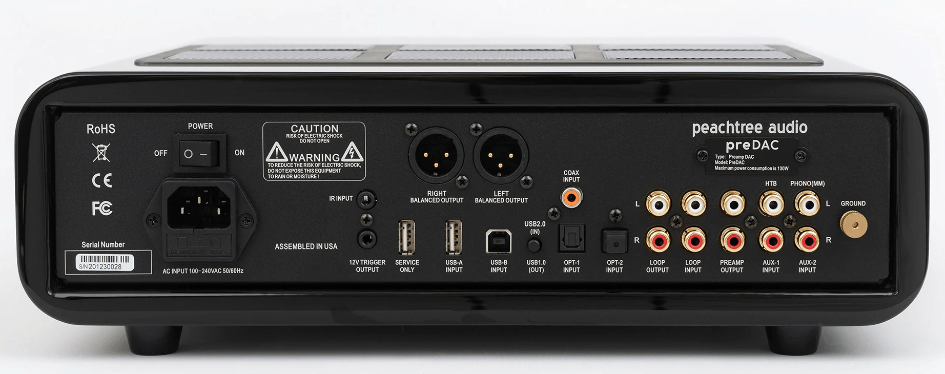

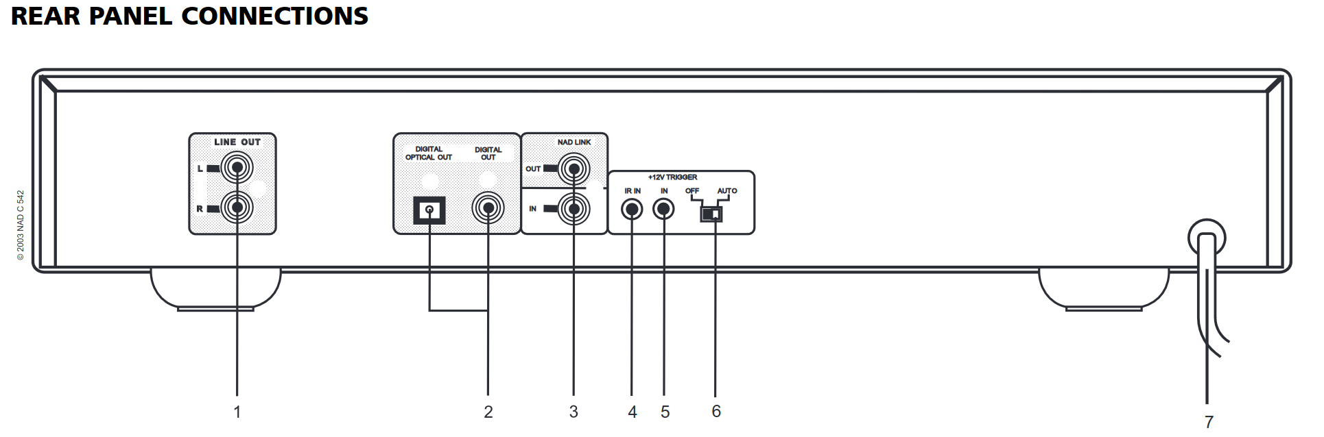

No problem. Thanks for expanding on your system. It gives me a bigger picture now of your current setup.
I'm really the worse person to comment as I'm cutting edge modern (No Mains, No Traditonal Ampfliers, High Efficiency, Optical Isolation, Isolation, <1 Ohm or milliohms range, WAV-only w/ embedded album art, realtime kernels, RAMPLAY, Max Transparency, Max Resolution, Max Transient Response, Clocks at the low frequency possible, etc.), so legacy OEM DAC chains I really shouldn't comment on at all.
With that said, I'll try to point you in a possible direction.
If you think about the NAD C542, it runs on Mains power so I recommend just a cheap Toslink cable since it provides some isolation and should be more compatible with Ian's stack (ReceiverPi DDC). Ian mentioned feeding any Toslink into a ReceiverPi is irrelevant because the Q7 will handle it's business and convert your signal with a modern Clock. So you can't go wrong feeding a ReceiverPi Toslink. If you think about the legacy clocks inside the C542, it should be a modern improvement in the signal. Ian's Stack will act like a conduit feeding it a legacy optical signal and then it converts to a modern clocked optical signal into your Peachtree.
So C542 -> Toslink -> Ian's Stack -> Peachtree PreDAC should render an modern improvement with some isolation over C542 -> Coax -> Peachtree PreDAC
This should also give you flexibility if one day your C542 goes kaput by just replacing it with another TOSLINK IN Source.
As for your PC source, I recommend opening your PC and look if you have an free PCI-E slot.
If you have a free PCI-E slot, I recommend checking out Startech's site for which PCI-E USB fits your needs best? Maybe you want USB-C + USB-A for future expandability. Just make sure it's using the ASM3142 chipset otherwise pass.
https://www.startech.com/en-us/search?search_term=pcie usb 3.0
If you find one that works for you, you can check out prices on Provantage:
https://www.provantage.com/service/searchsvcs?QUERY=startech+pcie&SUBMIT.x=0&SUBMIT.y=0
Provantage usually has the best prices on Startech cards.
From there, JRiver -> USB PCI-E -> Wire World -> Peachtree Pre DAC
For future consideration, keep a USB optical cable to pair with your Wire World down the line. But this also introduces complications on how to power the USB optical cable. For example, I can justify powering my USB optical cable with UcPure/UcBalancer because I have 3 5V outputs to share with my gear. One of these 3 outputs will power one side of the StationPi. So I can only recommend a USB optical cable one day, not now, if you eventually run UcPure/UcBalancer @5V powering the StationPi Audio side. Otherwise, it's really difficult to justify an USB optical cable without proper Off Mains Power.
A possibility is Jriver -> USB PCI-E -> Wire World -> ReceiverPi Pro, but this is an unknown for now. If you really need USB into Ian's Stack, there's a BridgePi but better to wait to see what the ReceiverPi DDC offers. Focus on your C542 then the PC side should naturally integrate.

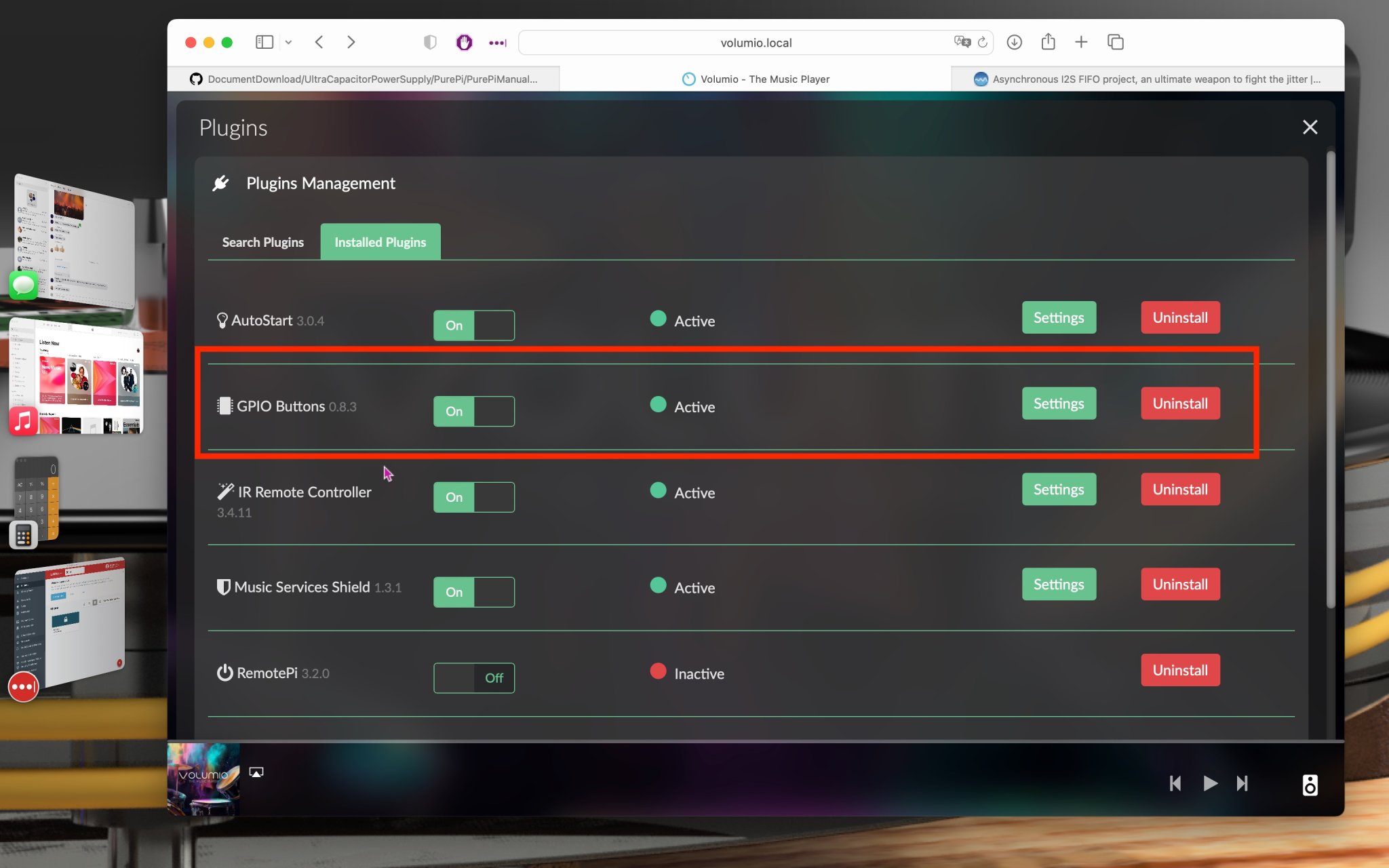

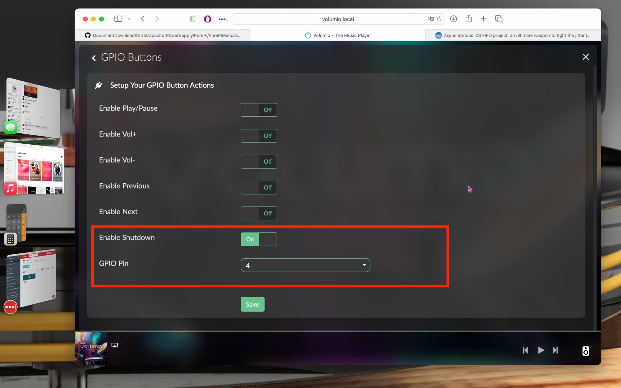

How to enable safe shutdown via Volumio. I have found a way to easily enable this in the volumIO settings. See my other posts for the streamer stack i built and the boards I am using, as my scenario is using ShieldPi pro in my stack.
Steps.
1. Add the GPIO plugins from the plugins manager.
2. Select Enable Shutdown and ensure you have GPIO pin set to "4" via the dropdown. This corresponds to Ian's instructions for the ShieldPi Pro and the addition of a line to config.txt. With the plugin you don't have to edit the config.txt boot file.
3. Ignore the other options as you can use the IR remote for most of them if you have MonitorPi.
4. Now when you press the tiny button (yes it's there) on the front of ShieldPi Pro, it will safely shutdown the RPi world.
I am still working on how to make it come back on with the button. I haven't figured that part out yet.

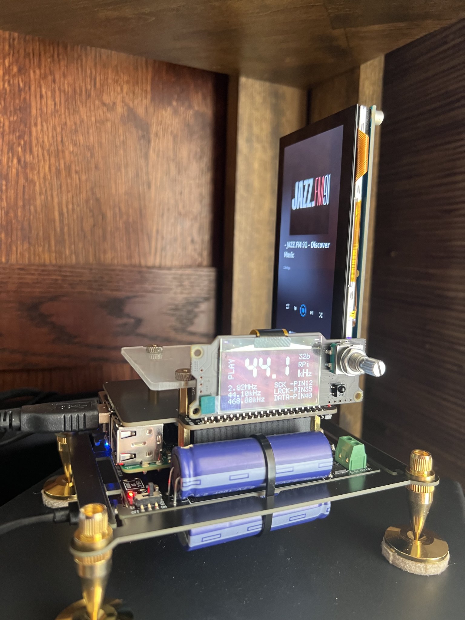

Did you know you can use MonitorPi on just a standard RPi install to see what’s going on? Yep.
Here is a MPiPro on ShieldPro on RPi3b. Running Volumio.
Here I’m playing via I2S with no i2S HAT. But you can see what MPiPro picks up. I’ve also got a DSI 4.3 screen running at same time.

@fusion360guyDid you know you can use MonitorPi on just a standard RPi install to see what’s going on? Yep.
Referring to your line "Here I’m playing via I2S with no i2S HAT", Could you please share more about how you are doing this and input and output connection details....
