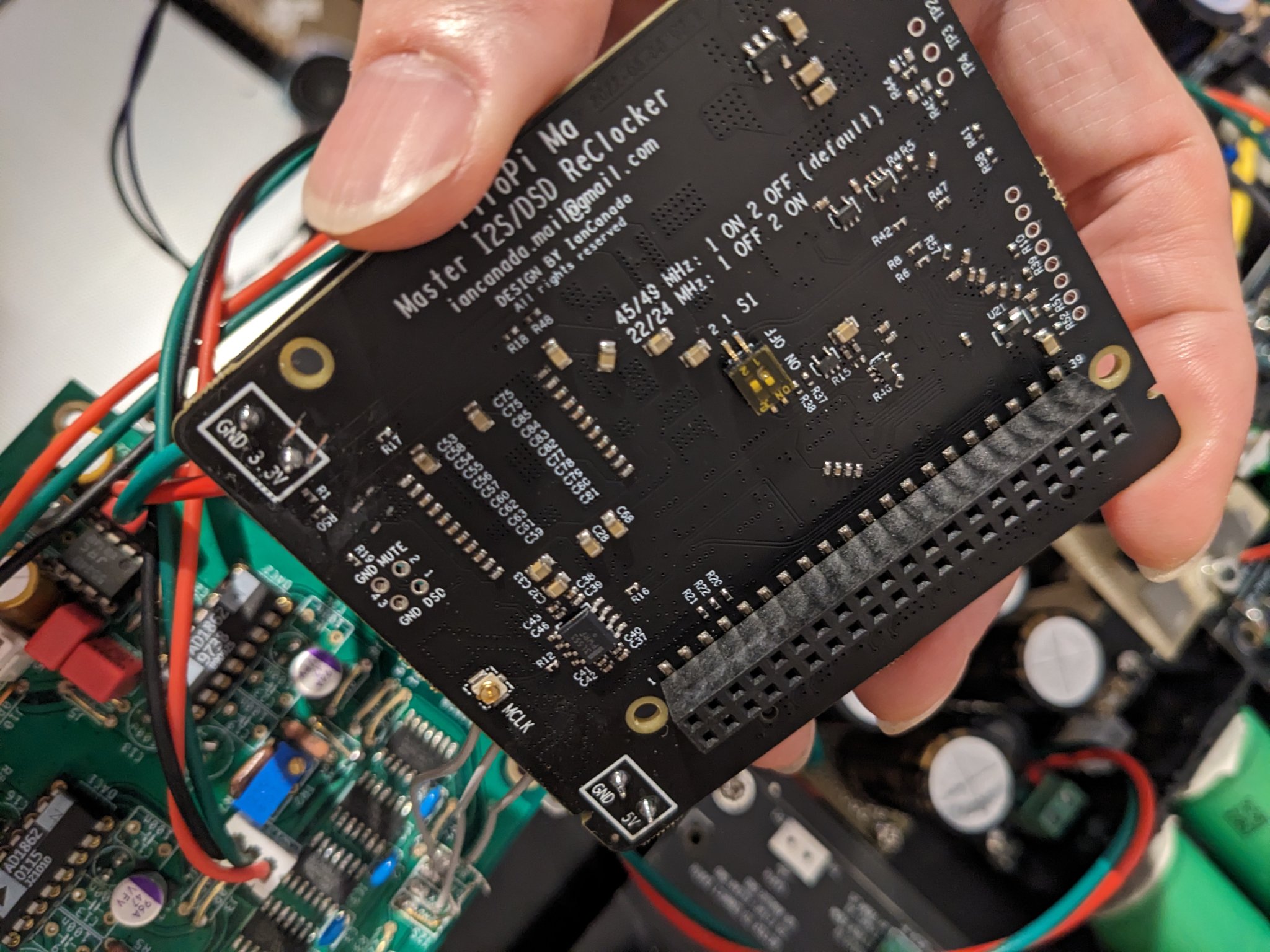

Yeah the dirty side of the FIFO Pi MA needs some power.
i have the same setup, i give 5 volts through the pi (or isolator) and 3.3 volts to the FIFOMA 1.5.
if you put 5 volts through the fifoMA it won't work.
and the isolator must be configured as master.
software volumio, driver hifiberry dac+ pro.
dac dion audio 1543 nos dac.
