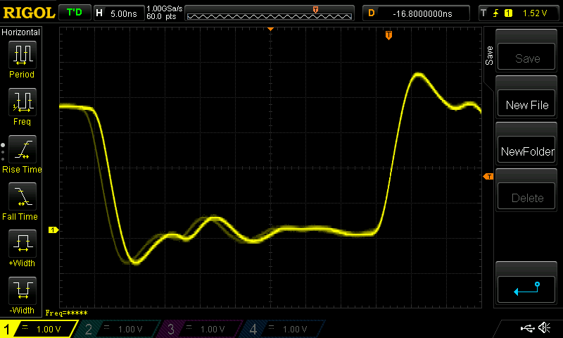

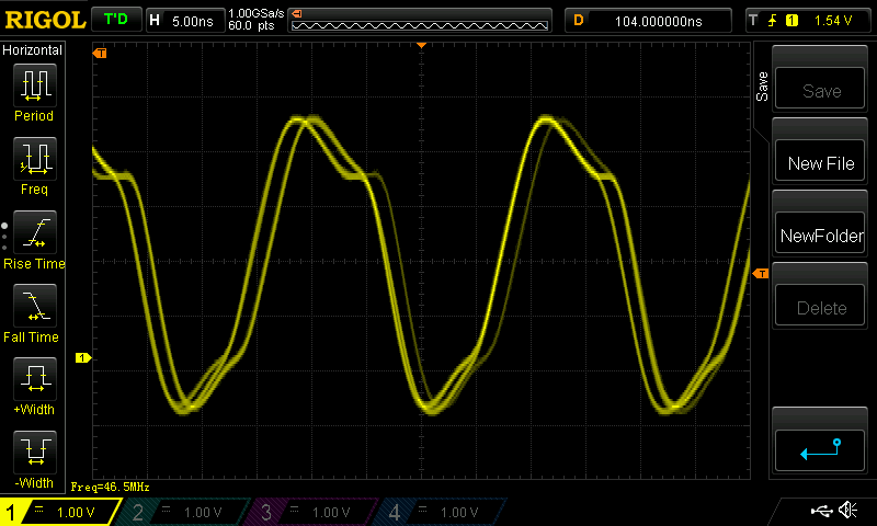

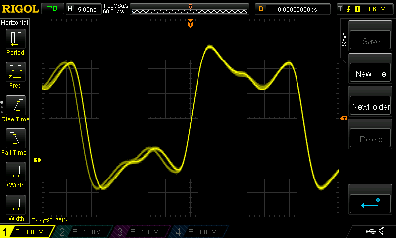

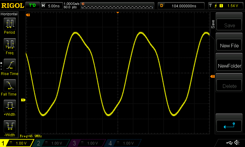

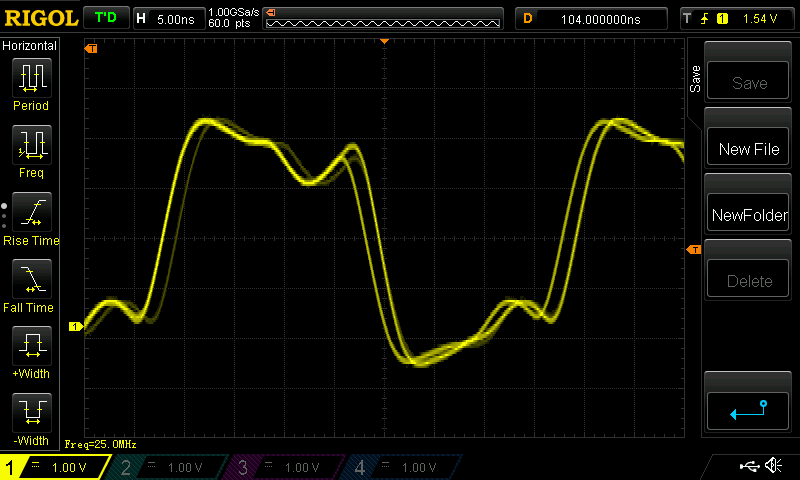

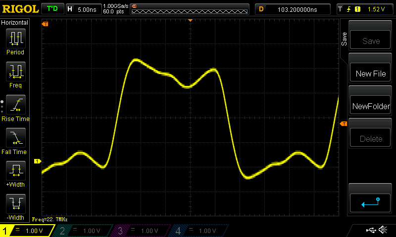

If the fractional part were always set to zero, the output frequency would slightly deviate from the requested value, but only clean integer divison would be used and no jitter from the MASH. A trivial patch
The resultant frequency differs from the requested one because the fractional part is missing. The code could be improved with rounding instead of flooring the int part.

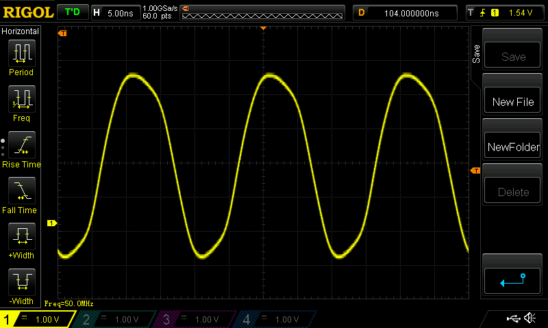

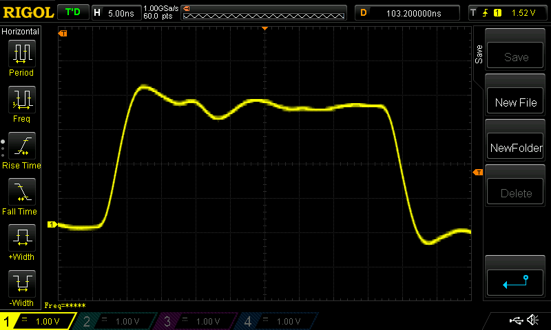

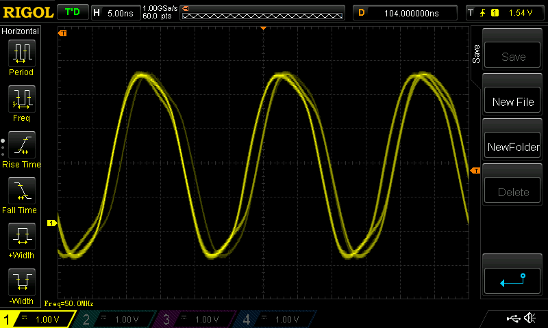

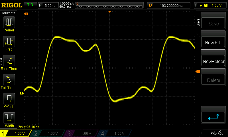

My scope is only 100MHz, at max. resolution 5ns/div the 1.3ns is hard to catch at slower rates. Therefore I started from higher frequencies. Scope traces in the same order.
768000Hz vs. 781250Hz diff 1.8%
705600Hz vs. 732421Hz diff 4%
384000Hz vs. 390625Hz diff 1.7%
352800Hz vs. 355113Hz diff 0.7%
192000Hz vs. 192110Hz diff 0.06%
96000Hz vs. 96055Hz diff 0.06%
No scope traces:
88200Hz vs. 88778Hz diff 0.7%
48000Hz vs. 48027Hz diff 0.06%
44100Hz vs. 44221Hz diff 0.3%
If someone is willing to accept the playback speed error, the above patch vastly improves the jitter of I2S master on RPi.

Same RPi I2S SCK after FifoPi and ReClockPi
It would be sad if the FIFO did not clean the horrible jitter from the fractional division 🙂 But it would be interesting to see pictures of the RPi bitclock pin in the integer-only mode on your gear, not on my entry level scope with long interconnects. I believe it would be nothing outrageous, my 2 cents the 1GHz scope would show no visible jitter either.
@phofman
Yes, there was no any visible jitter in the waveform on my 1GHz LC584AXL screen. However the jitter measurement package still tells the RMS time jitter of the SCK (or BCK) after FifoPi and ReClockPi was 3.76 ps. There is no ideal jitter cleaner in the real world, but FifoPi and ReClockPi did a good job, the result is already much much better than the original SCK from a RPi output, which was at 1000ps level!
Sck88JitterAfterReClockPi by Ian, on Flickr
Ian
Ian
Are there any other clocks out there other than the accusilicons, crystek, well tempered, that are worthy to be tried?
As shown above the fractional output from RPi always contains two frequencies with periods of 1,300 ps difference, by design. Your FIFO output must be (and is) many orders better, also by design 🙂
