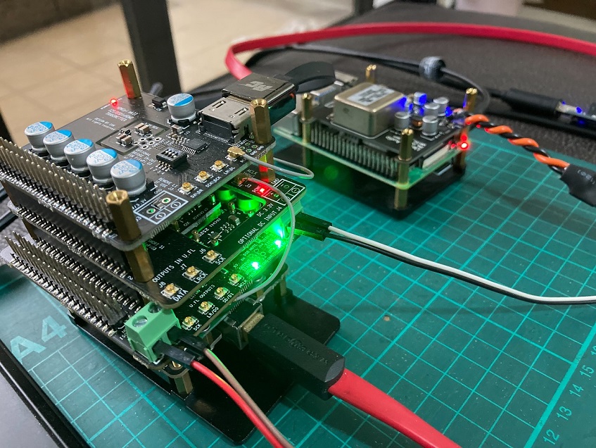

To change the clock on the rpi4 board you can refer to this circuit
?? RPi PLLs the 54/27MHz clock to several GHz and generates all the required clocks via fractional dividers. The fractional division (SMASH) used for clocking the I2S interface in master mode generates huge jitter, many orders larger than any impact of the original crystal before the multiplying PLL can have.
IF the clocks on the addon board were used for slaving the I2S interface (with an I2C-controlled clock divider to generate bitclock at cost of a few dollars), it would make sense. Not this.

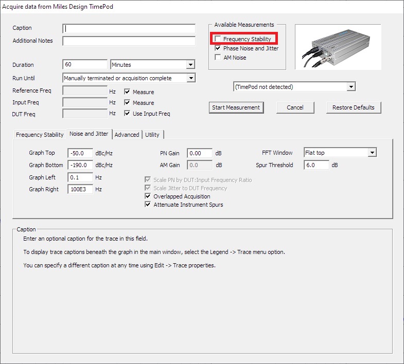

You should know that for an oscillator using SC-Cut crystal without the oven the frequency will drift more than 5Hz, just take a look at the inflection curve of such crystal.
However, when I measure the phase noise I disable the Frequency stability measurement in the Timepod because with the above mentioned DUT the tool shows an alert message indicating that the frequency is drifting more than 5Hz.
This was the case and it was enough obvious.
So one should try before claim.
Interesting details, so if the time pod warns about the frequency drift, you disable the warning. Didn’t occur to you that the over 5Hz drift may affect the SQ more than the phase noise? And why do you think the time pod is signalling a warning if the drift doesn’t matter?
I believe you have not clear the difference between phase noise and frequency stability (Allan deviation), short term vs long term stability.
I don't disable the warning, I disable the "Frequency stability" measurement, that's different from phase noise since the Allan Deviation is a separate plot.
If I don't disable the "Frequency stability" measurement the phase noise does not change.
Is this clear?
Then by measurements the phase noise is not affected by the frequency stability. dot.

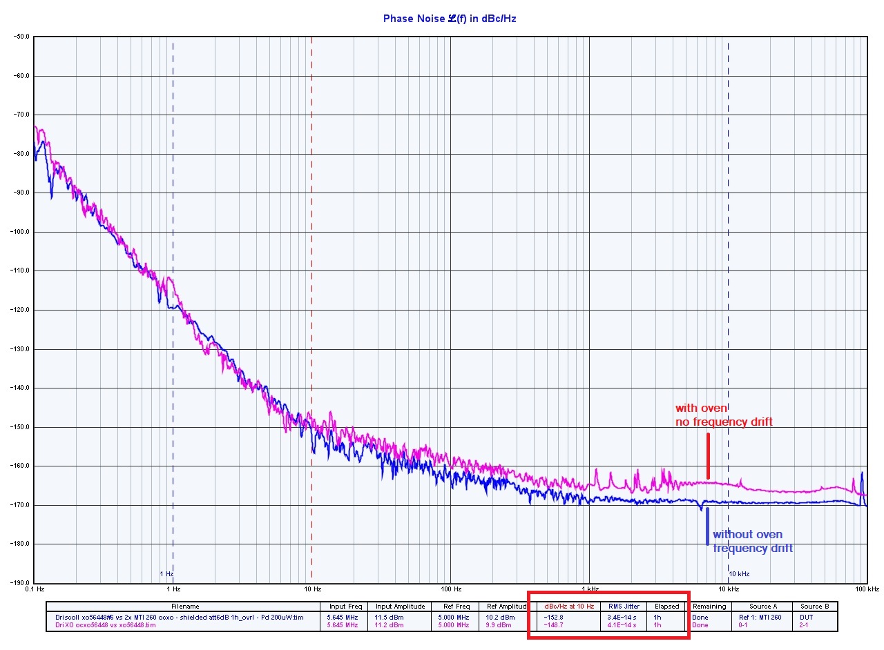

The problem is that it's difficult for you to follow.
Anyway the pink curve is the phase noise plot with the oven (no frequency drift) while the blue plot is the phase noise of the same oscillator without the oven (with frequency drift).
They are practically overlapped.
Now please buy the R&S FSV3000 and try to demonstrate the opposite.
Until you will succeed you are just posting rants without any proof.
As usual.
I have a big dilemma: who to believe, Rohde & Schwarz or Andrea Mori.
If anything, the dilemma is whether to believe Rohde & Schwarz or John Miles / Bruce Griffiths / Microsemi.
However, the dilemma does not exist, since you have posted a link that does not explain anything about the specific case.
Anyway the main problem is that I have published measurements (proof) while, as usual, you are claiming without any proof.
Again please buy the R&S FSV3000 and try to demonstrate the opposite instead of claiming without any evidence.
The frequency shift was 2kHz fm modulated signal in the video if I heard it correct… Seems different to the drift of the Andrea clock.
Sure, since you seem to be yet another expert in the matter, have you computed the theoretical phase noise error @1Hz due to a 5Hz FM fluctuation? It’s a rather trivial calculation that I’m sure you are aware of. If in doubt, I am also sure Andreas would be more than happy to help.
