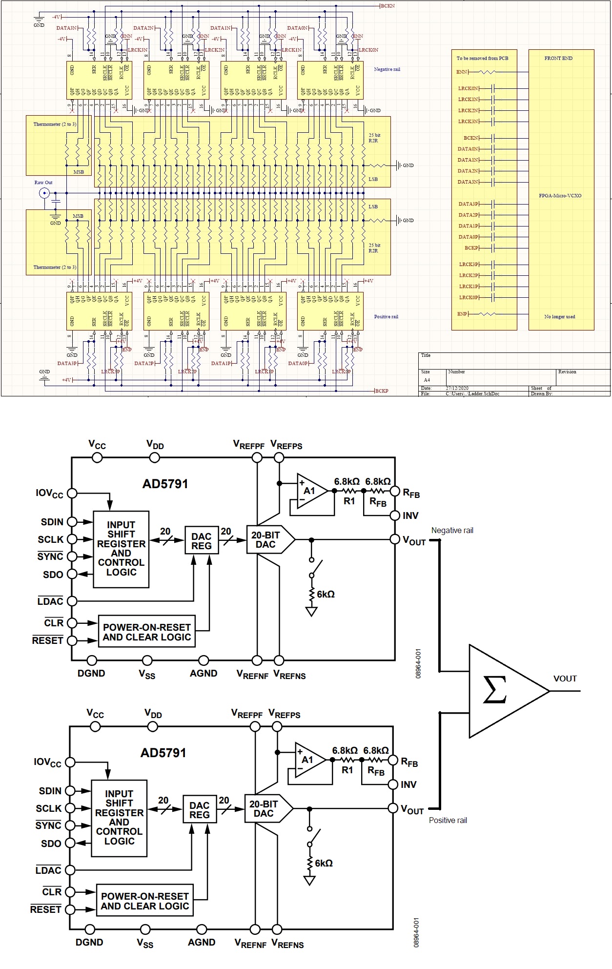

I have read the data sheet, I know that audio is not specified between the applications.
Anyway I don't see any disadvantage using sign magnitude architecture such as the PCM1704, I see only advantages even for industrial applications.
Moreover, even if the DAC is not specified for audio use, IMHO it does not mean that it cannot be used in audio applications.
Is the DAC in the upper part of the attached picture suitable for audio applications?
If so, I don't see much difference than the DAC at the bottom of the picture.
You clearly don't understand the business, twice the silicon for all customers even if they don't need it. Let the few 1000 audiophiles that still want to play with multi-bit DAC's buy four or as mentioned design an external de-glitcher. It's been done and the results are remarkable, maybe you are up for it.
Wrong Scott, I think he understands the business perfectly; the AD5791 is now the perfect part for a High End Audio DAC.

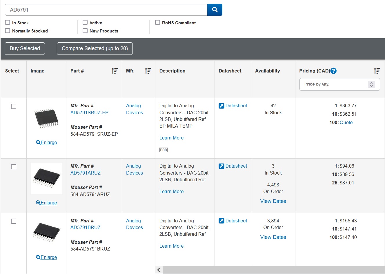

IMHO, doubling the DAC part of the chip does not mean doubling the wafer area, control logic and other parts remain almost the same.
You need 2 x 19 bit DAC instead of 1 x 20 bit DAC, wich means adding 90 resistors (64 for 6 bit thermometer decoded plus 26 for 13 bit R2R decoded), several active devices operating as switches and a little control logic.
I don't believe this means doubling the wafer area, I could estimate less than 50% more, maybe less.
Just for speculation we can assume a cost increasing about 10% (50% of 20%).
And just for speculation let assume a wafer cost of $3 per square inch or $ 0.00465 per square mm.
The AD5791 is a TSSOP-20 package device, 6.5 x 4.4 mm or 28.6 square mm, so the wafer cost would be $ 0.13299.
Finally a 50% wafer cost increasing means $ 0.0665 for a product sold at $ 113.53.

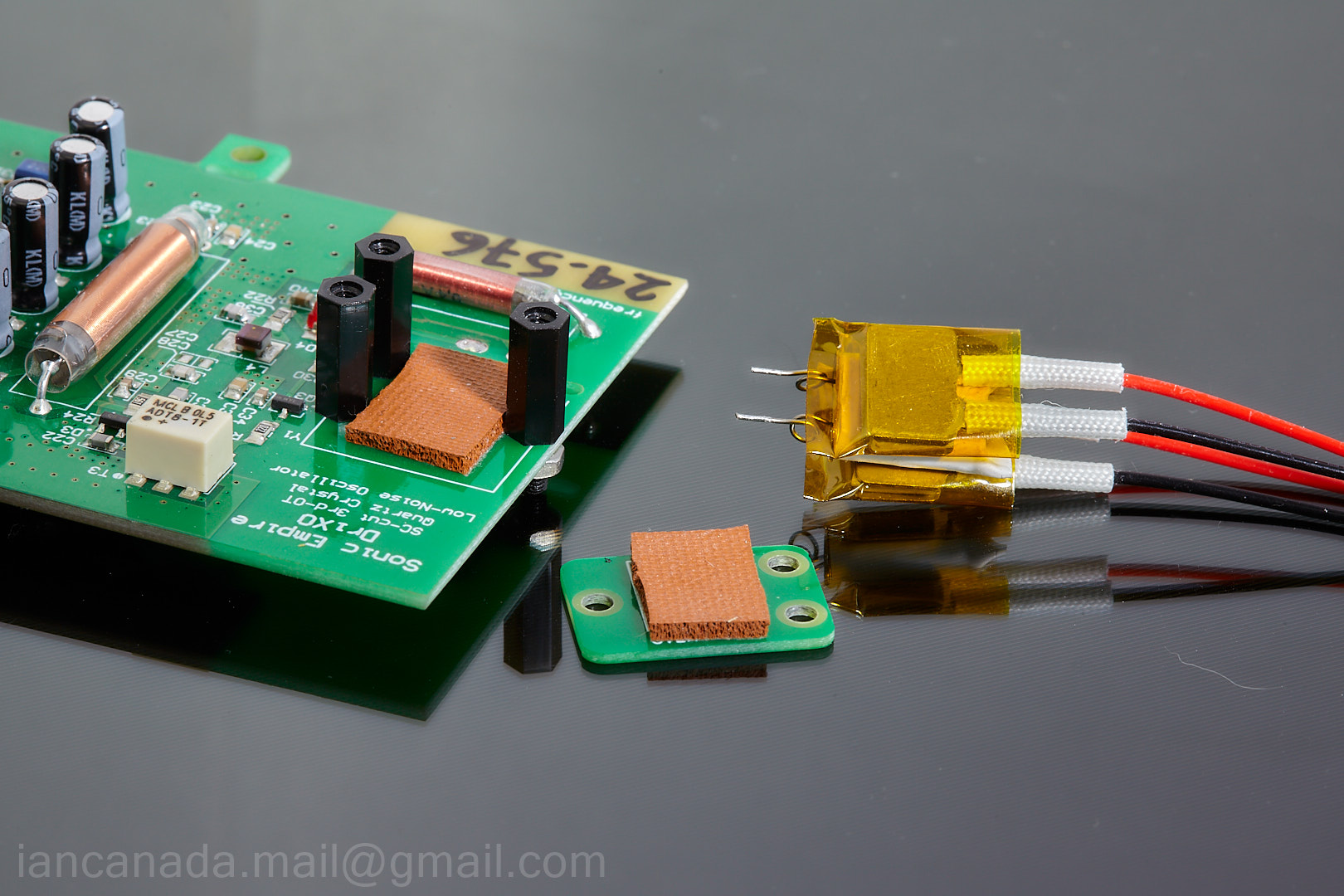

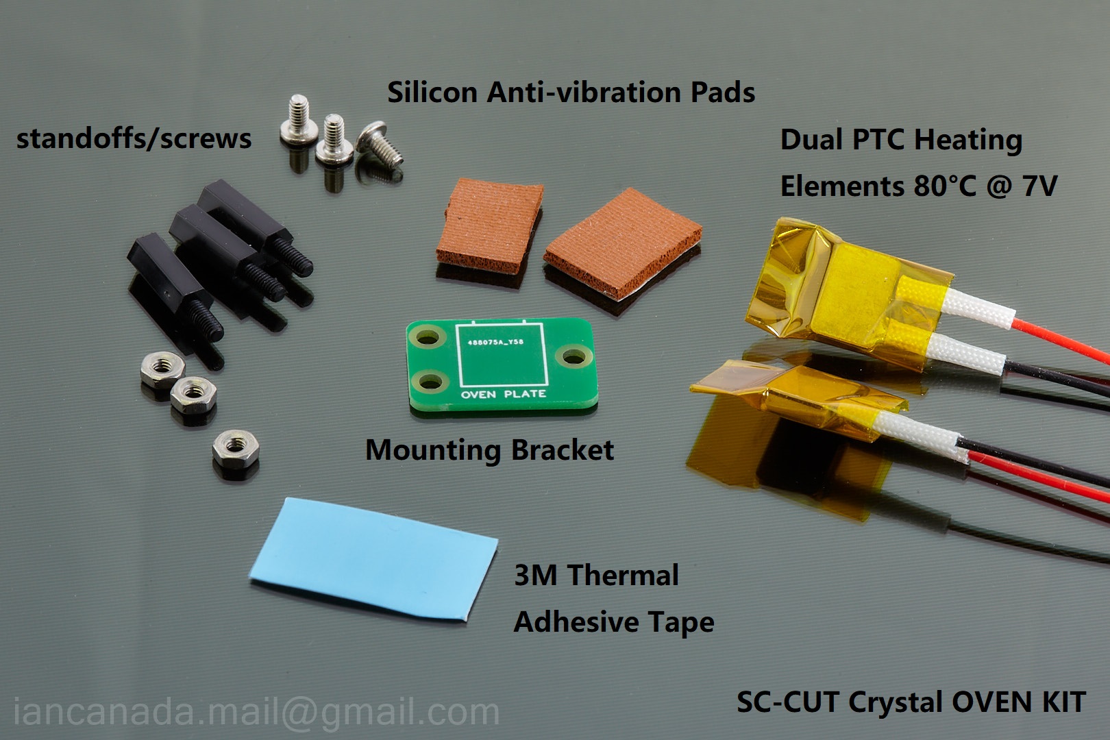

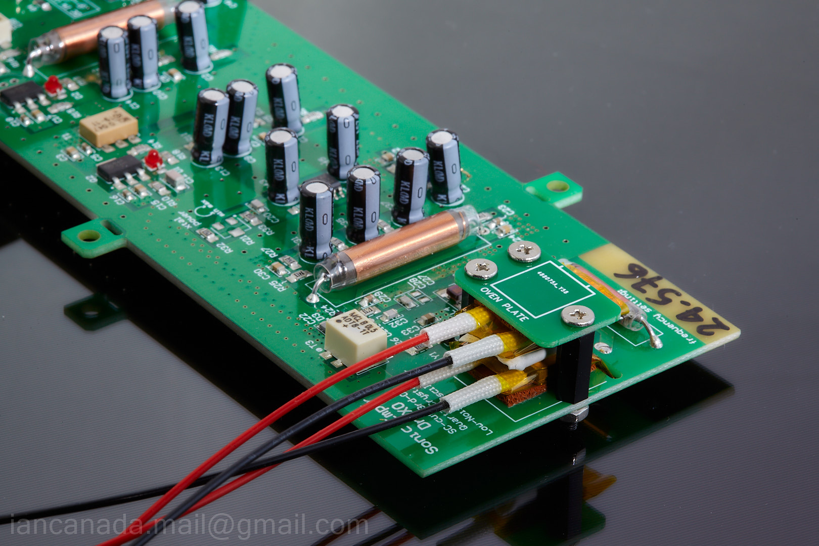

Trying to get the most out of TWTMC clocks for FifoPi (10)
Oven solution for SC-Cut crystals

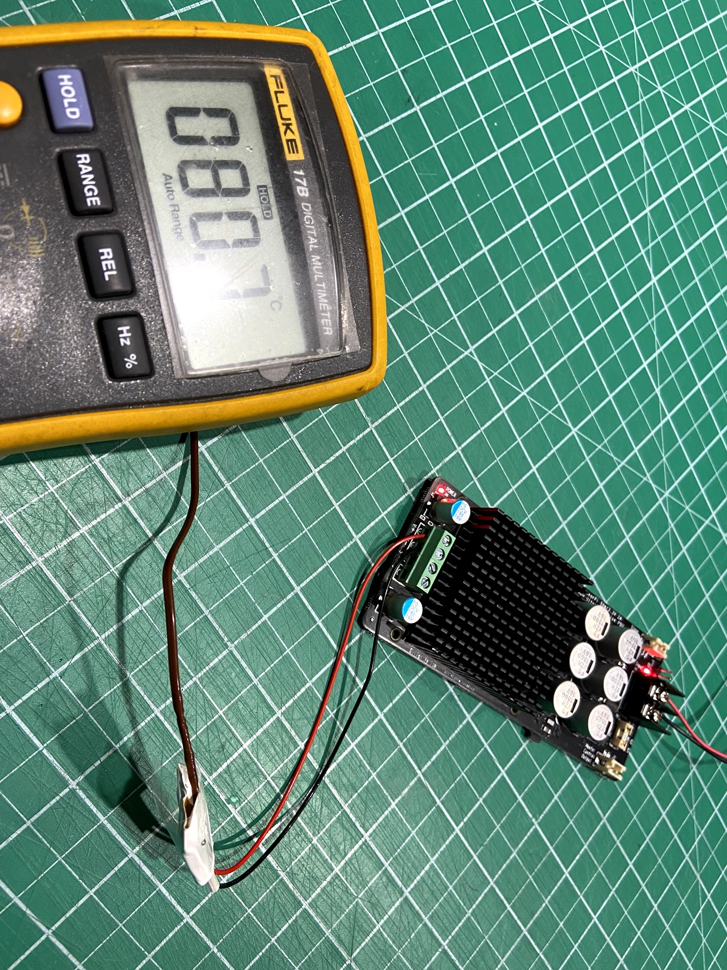

SC-Cut crystals need ovens at 80-90°C to achieve a better frequency stability. The temperature is pretty high. I’ve tried several solutions without success until I finalized this dual heating element PTC ceramic oven solution.
The PTC heating elements were customized at 80°C with 6.5-7VDC voltage. Increasing voltage can make the temperature higher a little bit but not by too much. Each heater will consume around 250mA current before warm up so a dual oven will need 0.5A. A LinearPi configured to 7V would be a very good power supply to drive the ovens. Low EMI noise power supplies are preferred. Please don’t use SMPS to avoid introducing EMI into the OCXO case.
I use a dual PTC heater configuration for the SC-Cut crystal to make the temperature evenly on both sides. It’s a better solution than the single heat element configuration.
The oven KIT will include:
2*PTC heat element
3M thermal conductive adhesive transfer tape
Silicone anti-vibration pads
Mount bracket
Standoffs / screws
Drilling holes on the aluminum front panel of the Hammond case can result in shorting the isolated DRIXO output to ground. I designed a panel PCB with a double shield layer to fix the issue and to make things easier.
After installing this oven KIT to my DRIXO, it really made a change to the sound quality in my system. At the beginning, I didn’t feel any improvement. But after warm-up for more than 24 hours, the sound stage becomes more open. And then, after turning off the oven power for half an hour, it comes back again. I did this test back and forth a couple of times, the results are the same. But anyway, it is a subjective test. Different systems and different people may have different results. So, please just trust your ears.

I actually think this is an interesting development as no one else other than Andrea experimented with a heating element on the 5MHz SC cut crystal. I thought about getting a cheap ebay usb heating pad to run the experiment. That remains an option, or if Ian creates a kit that addresses heating and vibration it may be an attractive option. I like that someone is working to push the boundary of this thing.
Surely this could operate from a surplus wall wart phone charger? Is there any issue that would not equally created by another wall wart to power say the network router that may be on the same circuit? I realize your system is running on a Power Plant. Have you tried powering the heater with a switching PS that is outside the Power Plant domain?
@Wlowes,
PTC ceramic heating elements are self-feedback components. The temperature is decided. Temperature is not sensitive to the voltage of power supply. So I don't think the quality the power supply is really matter for the PTC. The only thing I'm concerned about the the possible EMI noise. Because they will be installed very closed to the Sc-cut crystal.
As long as the heater power has an independent/isolated coil, I don't think it needs the Power Plant domain. Or, you can try it by yourself. Hopefully I could make this OVEN KIT available together with the SinePi.
Ian
Ian
Not sure of your heating elements you are using, but I would be very careful in selecting them. An analog temperature controller is required, "bang-bang" controllers could have a very ugly impact on the oscillator spurious.
