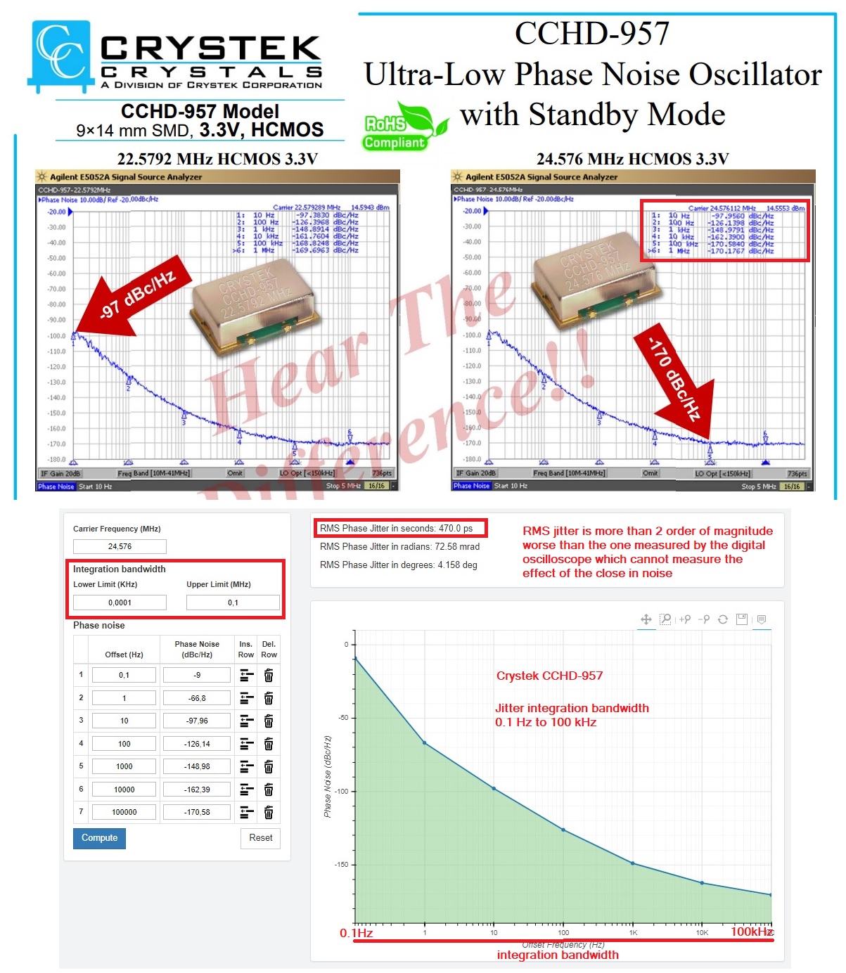

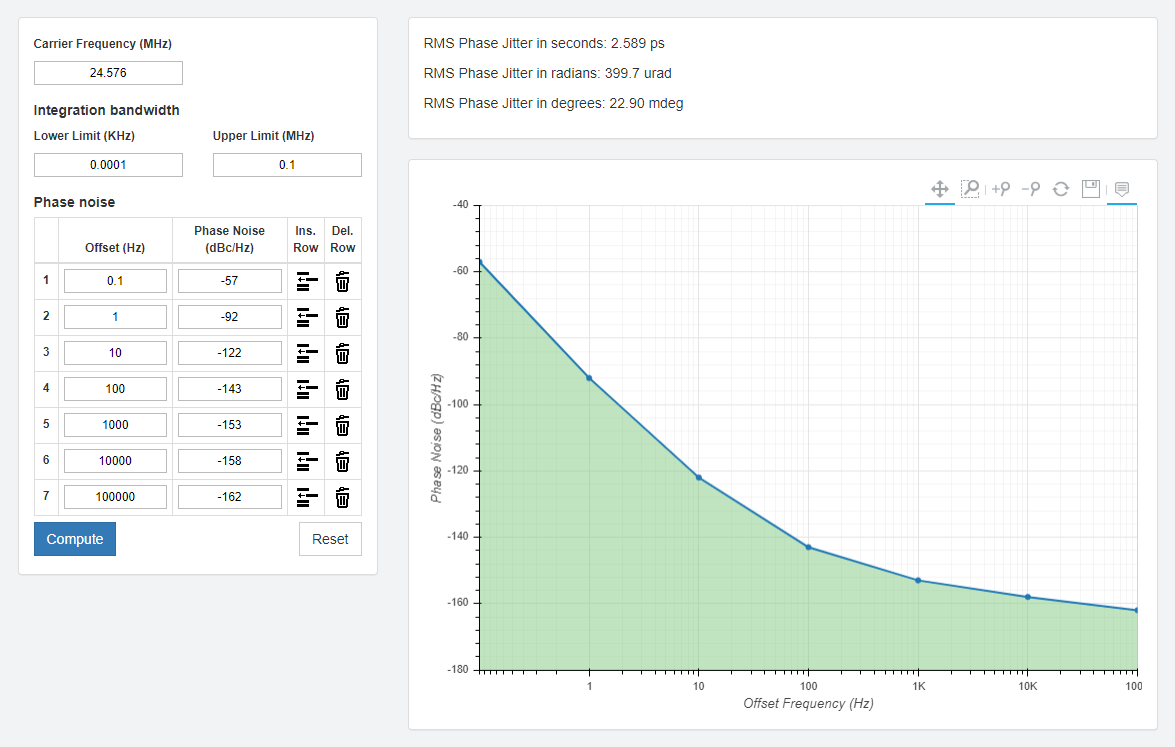

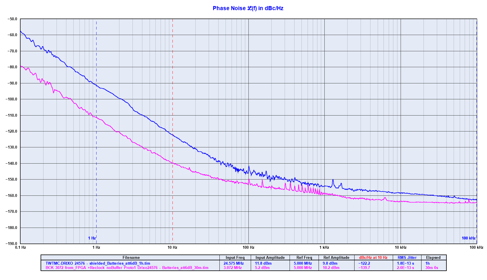

I respect the jobs you did for the community. But as an engineer, I really can not help to point out if there is something that obviously incorrect. I’m sorry if that makes you feel uncomfortable.
1. ”The Driscoll oscillator at 22.5792 MHz has a jitter of 76fs” That’s totally wrong
Assuming your phase noise plot measurement was correct, based on this result, the estimated RMS phase jitter will be 2.589ps for the integration bandwidth from 0.1Hz to 100KHz. 76fs was 30 times wrong! Please see the attached screenshot for how it was calculated.
Next time when you post your jitter results, please do indicate that they are phase jitter, and don’t forget to specify the integrated bandwidth.

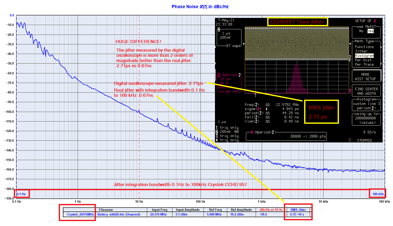

Time jitter is a real parameter of a clock signal which can be measured directly in the time domain. Phase jitter doesn’t exist in the real world. It can just be indirectly estimated/calculated from a phase noise plot. Theoretically phase jitter can be closed to time jitter, but with conditions. You have to integrate it through the full bandwidth.
Really don’t know how you got the number 76fs. Can you explain?
2.589ps is still within LC584AXL’s time jitter measurement range though it’s very close to the jitter measurement noise floor (2ps by default). And by comparison, it can clearly tell which one is better and better by how much in RMS time jitter difference. Please do not worry at all..
2. ”Evidently the problems you are pointing out do not actually exist by measurements” It’s true for you but only because your measurement tool can not see them.
Unless you upgrade your phase noise analyzer to E5052B or the same/higher grade, you will never see the crosstalk. The reason is that your TimePod has a very narrow detection bandwidth of just 100KHz. It’s really impossible for a TimePod to see the crosstalk as long as the crosstalk phase noise spur happens above that range. That explains why you didn’t notice the cable ground introduced crosstalk issue when you designed your squarers.
Don’t tell me that only the clock close-in phase noise affects the sound quality and you don’t think the crosstalk matters. That’s only your point. Based on my real listening experiences, both phase noise floor and the time domain clock signal quality are also significant to the final sound quality, just in different ways.
3. ”The phase noise of the BCK is around -140dBc at 10 Hz from the carrier, better than the phase noise of the sine wave input from the Driscoll oscillator at 24.576 MHz.” That could be still questioning
What your TimPod measures a square wave clock is just the phase noise of the fundamental frequency components because the 27MHz LPF converts the square wave back into sine wave again before feeding into ADC. All harmonics frequency components were cut off by the LPF filter. So your TimePod may not exactly tell the real quality of a square wave, no mention the rising and falling time.
Converting a square wave back to sine wave before feeding signal into ADC, it really seems meaningless to evaluate the quality of a sine to square converter in this way.
4. ”In fact the problem is less than zero”
That sounds more like marketing words. An engineer usually doesn’t say it in this way because we know in the real world nothing is perfect. If you think the problem is less than zero it could be just because your tool can not see them.
Ian

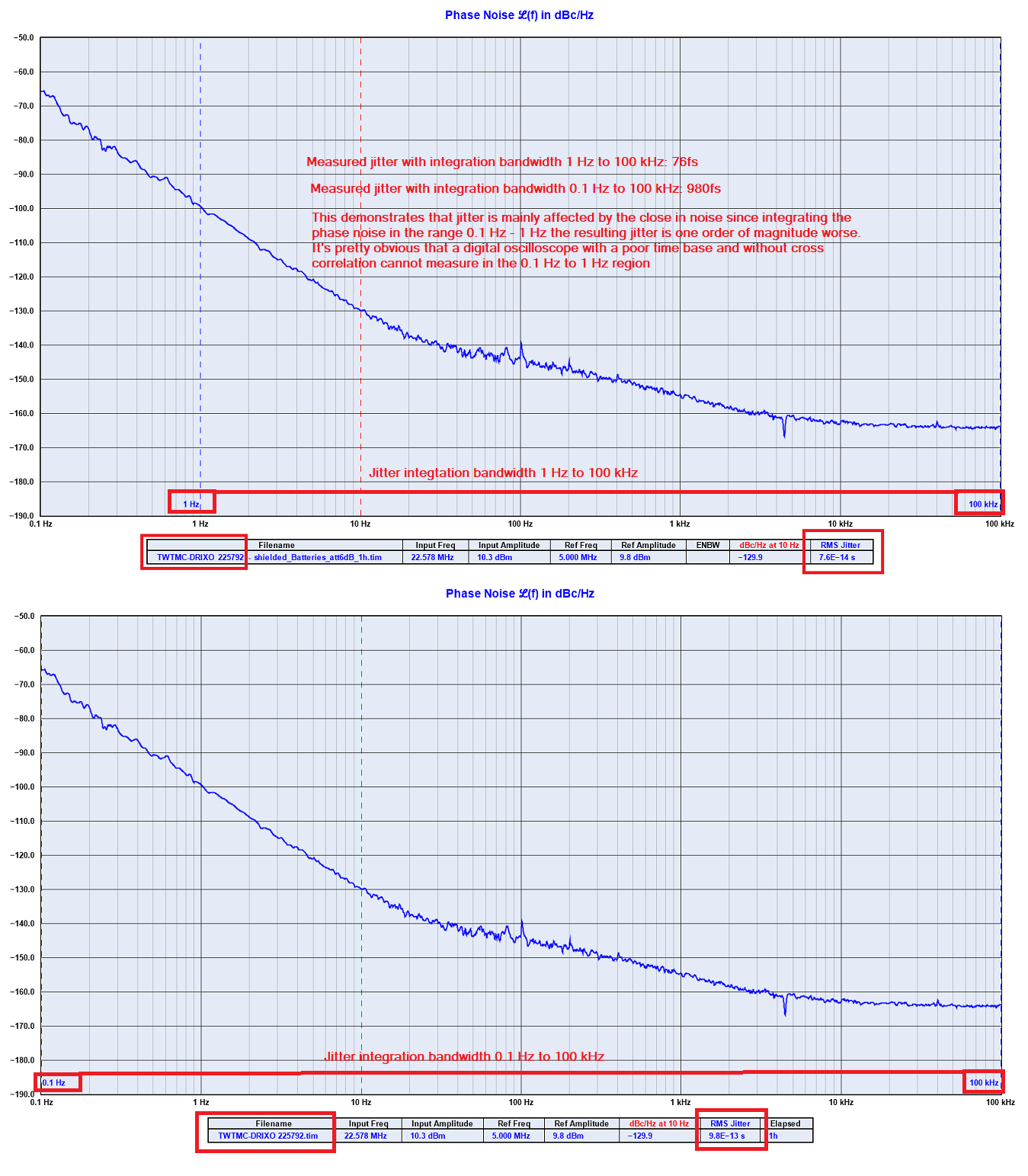

First picture
The RMS jitter of the DRIXO oscillator at 22.5792 MHz calculated with an integration bandwidth 1Hz to 100kHz is 76fs, no doubt from the upper image.
The RMS jitter of the DRIXO oscillator at 22.5792 MHz calculated with an integration bandwidth 0.1Hz to 100kHz is 980fs (lower image).
It was pretty obvious since the jitter is mainly affected by the close in noise.
Although the jitter noise floor of your digital oscilloscope (2 to 7 ps) is far worse than the DUT you would measure (980fs), there is no way your tool could measure with such integration bandwidth lower limit (0.1 Hz) because its time base is much worse than the DUT and moreover the cross correlation is the only way to reach such lower limit (and your tool does not use cross correlation).
Let me demonstrate the reason.
Second picture
Using an integration bandwidth from 0.1Hz to 100kHz the RMS jitter of the Crystek CCHD-957 is 0.67 ns, while you have measured 2.71 ps with your digital oscilloscope.
This demonstrates that your tool is not able to measure the close in jitter, it substantially measures the noise floor but it's not capable of measuring the close in noise.
It's suitable for telecommunication mesurements but not to measure the close in jitter and it's quite obviuos due to its poor time base.
Third picture
By calculating the RMS jitter of the Crystek CCHD-957 starting from the phase noise plot of its datasheet, the resulting jitter is almost the same measured by the Timepod when using 0.1 Hz to 100 kHz integration bandwidth.
The lower image clearly shows a calculated jitter of 0.47 ns, a little better than the one measured by the Timepod (0.67 ns), maybe the specific DUT has a little worse noise floor.
Anyway the resulting RMS jitter is very similar, 0.67 ns vs 0.47 ns, while you have measured 2.71 ps, more than 2 orders of magnitude better than the real jitter.
I hope it's clear you have no way to measure such close in jitter with your digital oscilloscope, the time base of your tool is much worse than the DUT you would measure.
It's phisically impossible.

May I ask you guys why are you stopping the integration for calculating the jitter at 100KHz?
Usually, the integration upper limit is twice the carrier frequency (see the AD reference https://www.analog.com/media/en/training-seminars/tutorials/mt-008.pdf ). As such, it will lead to a wideband phase noise contribution larger than you are currently estimating, and the jitter contribution of the close in phase noise may decrease.
This would significantly affect the jitter results for the sine to square conversion process; the process significantly affects the broadband phase noise (something that indeed the timepod has difficulties measuring, due to the limited input bandwidth) and to a much lesser degree the close in phase noise (I’ve already posted in another thread two authoritative references about). As such, limiting the phase noise integration upper limit to 100KHz will always show a small jitter increase due to the conversion, since the close in phase noise contribution is overestimated.
There is also a legitimate question why are you taking the lower integration limit at 1Hz; since the phase noise increases much like the 1/f^n noise in the analog domain (where everything on top of 1/f noise is called “excess noise”) integrating down to 0.001Hz will show a much larger jitter contribution of the close in phase noise.
Because when the noise floor is reached the plot becomes flat.
For oscillators in the 20MHz range the noise floor is reached form 1kHz to 10 kHz from the carrier.
Even a poor oscillator like the Crystek CCHD-957 reaches the noise floor at 10 kHz from the carrier as clearly showed in the datasheet.
It has been measured by the E5052A and the baseband was 10Hz to 1MHz from the carrier, and not twice the frequency of the carrier which would be around 50MHz.
The R&S FSWP can measure up to 50GHz but its baseband noise measurements does not reach twice the carrier frequency (100GHz!), its baseband is limited to 30MHz.
Of course the baseband upper limit of the FSWP (30MHz) is higher than the one of the Timepod (100kHz), but you should know the reason: the frequency limit of the Timepod is 30MHz and at such frequencies the noise floor is reached far below of its baseband upper limit of 100kHz, while the FSWP can measure 50GHz oscillators and at such high frequencies the noise floor is reached at higher distance from the carrier than 100kHz.
The broadband phase noise does not affect much the jitter, the jitter is mainly affected by the close in phase noise as demonstrated shifting the integration bandwidth lower limit from 1Hz to 0.1Hz in a previous post.
The RMS jitter of the DRIXO oscillator at 22.5792 MHz calculated with an integration bandwidth 1Hz to 100kHz is 76fs, while the RMS jitter of the same oscillator calculated with an integration bandwidth 0.1Hz to 100kHz is 980fs (lower image).
Moreover the 300000 Euro FSWP phase noise analyzer has the same LPF input filter of the Timepod around 30 MHz as clearly showed in the datasheet, indeed its baseband upper limit is exactly 30MHz.
You should know that the FSWP uses down conversion to measure up to 50GHz, no instruments can measure directly 50GHz and even much lower frequencies.
It's quite obvious that moving the integration bandwidth to lower frequencies such 0.001 Hz the jitter increases dramatically, but you should know that to measure down to 0.1Hz from the carrier the cross correlation takes several hours to do the job (8 and more).
So what would be the benefit?
We are talking about measurements comparison between a phase noise analyzer and a digital oscilloscope which cannot measure at such close in frequencies to the carrier Since it has a poor time base and does not use cross correlation.
It would be a wast of time since the digital oscilloscope measurements limit it's very clear from the picture I have posted: using an integration bandwidth from 0.1Hz to 100kHz the RMS jitter of the Crystek CCHD-957 is 0.67 ns, while the digital oscilloscope has measured 2.71 ps, more than 2 orders of magnitude better than the real jitter.
Again quite obvious since the jitter floor of the digital oscilloscope is 2 to 7 ps.
