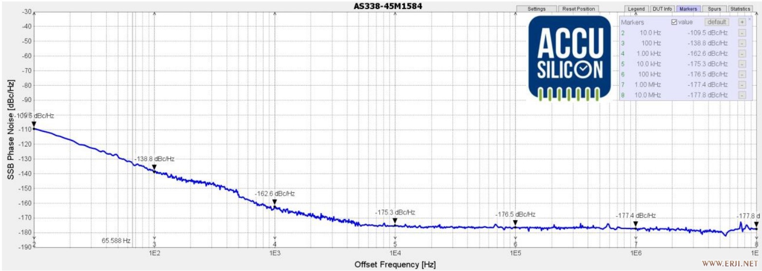

Yeah, I think Accusilicon are having a laugh with that price; taking advantage of people and I certainly wouldn't go near it unless they themselves test and characterise it thoroughly; rather than leaving it for customers like Ian's measurements to prove its worth the money.
$50 for AS338
I was quoted $50 US per clock via email by Acculisicon for the AS338.
Via email from their rep....echoing prior shared info, I realize. I asked where to purchase in reply but they haven't replied back yet.
All of AS338 tested performance but close-in (tyipcal 0.1Hz - 10Hz) phase noise still some deviation,
through the trial-produce test result distribution pertty okay. I have to say something about "Listening",
AS338 is not just "AS318B update", it is totally new thing - optimized sound quality first, new sealed
case and hi-end quality inverted-mesa AT-Cut crystal and almost lowest noise oscillation ASIC, then
we got low phase noise and good short-term stability spec. In fact ACCUSILICON is semiconductor
company that's why we can make so low jitter oscillators line, Most audiophile feel OCXO sound better
than SPXO one of key reason is OCXO short-term stability much much much better than SPXO, so we
improve this in AS338 design, alothugh AS388 still worse than high-quality OCXO, it is cost issue lah.
