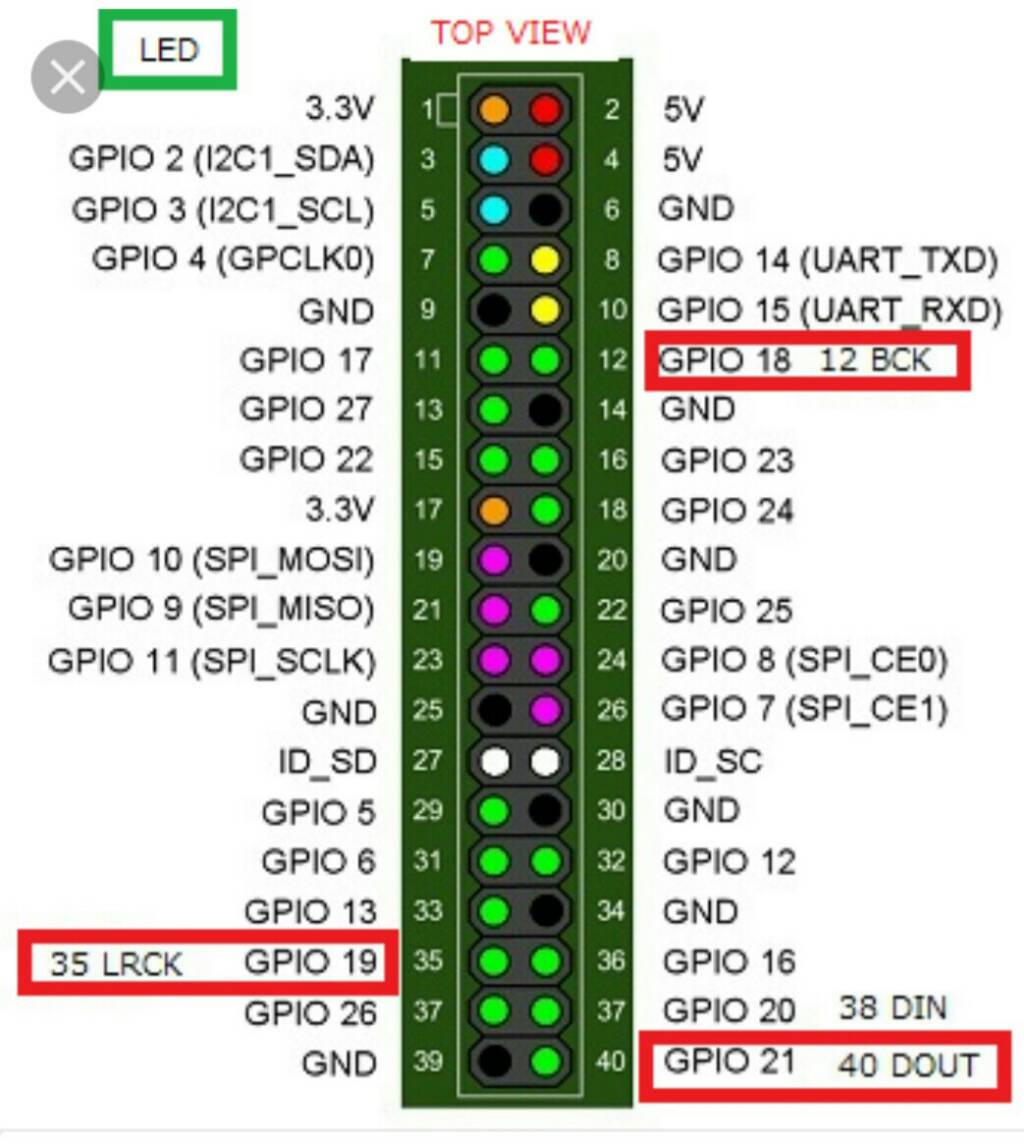

Can someone explain if i need the controller board to use Ian's es9038q2m (first edition) with i2s in from BeagleBone?
Does it depend on synchronous or asynchronous modes?.
I guess the following pins should be enough
BCLK
LRCLK
DATA
GROUND
May be someone have pinout of the dac board.
PS Can not find the right thread to ask, sorry

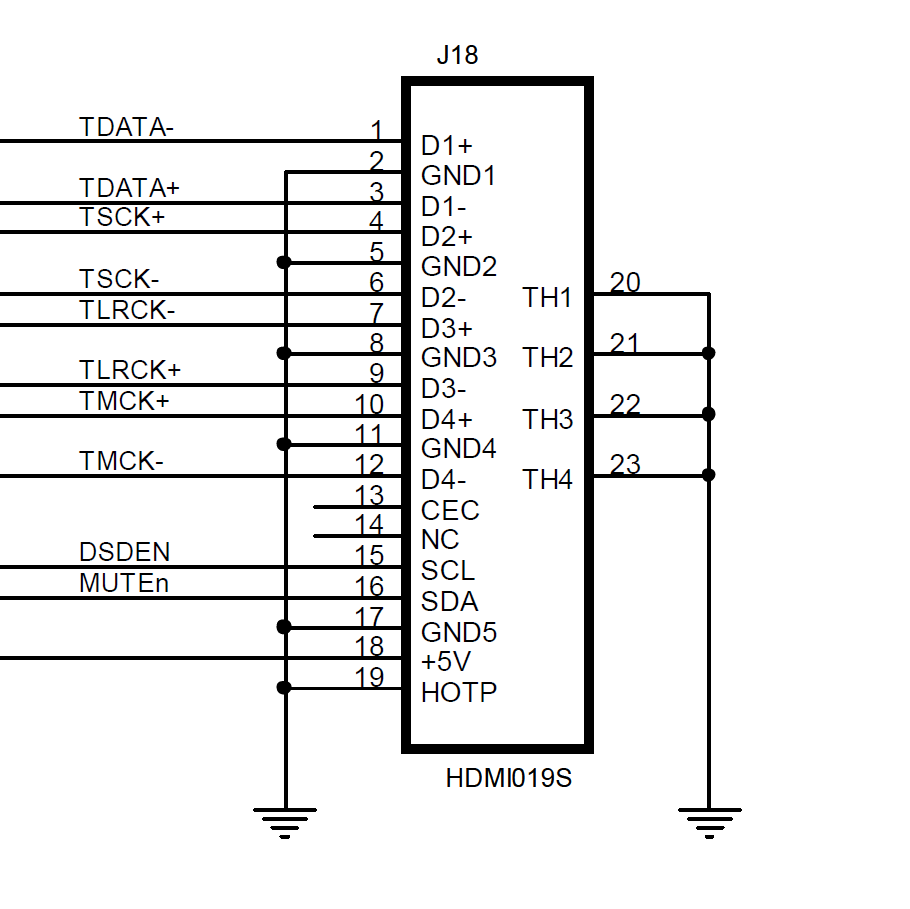

HDMIpi MkII, smoothly switches PCM/DSD, eliminates any possible popping sounds
HDMIpi MkII PCM/DSD/DoP transmitter board was designed to work perfectly with FifoPi Q3 and external DAC by additionally providing both DSDen and MUTE signals over HDMI cable.
The new upgraded features are:
New DSD enable and MUTE signals over HDMI to make it possible to control external DAC switching between PCM and DSD and eliminating any possible popping sound.
Enhanced decoupling capacitor networks to improve power supply performance.
When working with FifoPi Q3, besides MCLK, both DSD and MUTE signals need to be connected to HDMI MkII to make external DAC switching smoothly between PCM/DSD, and to eliminate any possible popping sounds. Please see the pictures for details.
When working with Topping D90, Some settings of Topping D90 DAC needs to be changed from default, otherwise the left/right channel will be reversed. Please hold the power button when you turn on the power switch to enter the setting mode,
1. Change setting 8 to REV
2. Change setting 9 to DSDR/DATA

Dear Ian,
Nice will order HDMIPi MkII, any update on the ReclockerPi? might want to get them together
Hi Ian,
Is the HDMI connector at the exact same position as on the TransportPi?
And is the TransportPi getting the same update?
Br,
Mario
Br,
Mario

Dear Ian,
ReclockPi is under evaluation now. Very promising so far. I'll make it available as soon as possible.
Ian
Hi Ian,
Br,
Mario
Yes, HDMPi MkII didn't change the position of connectors. You can upgrade directly.
Ian
