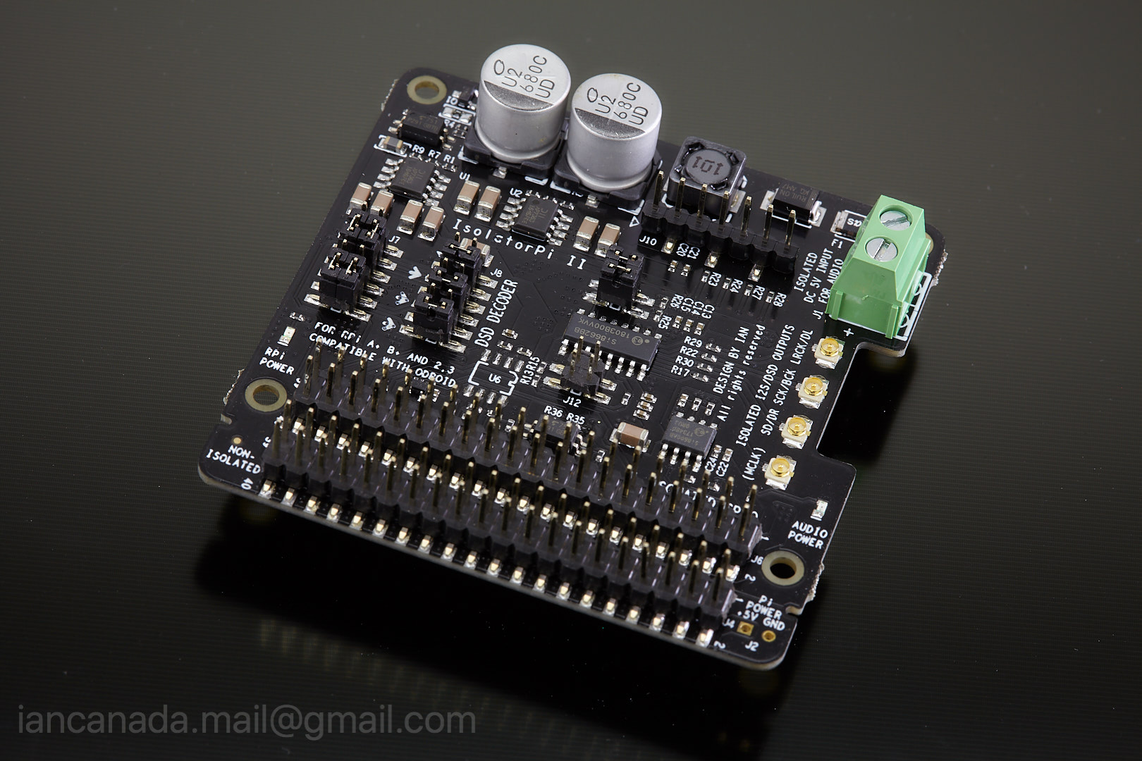

Does anyone recommend the IsolatorPI for the i2s -> RPI-less?
I was considering #20 -> RPi-less, but it seems cleaner with the IsolatorPI.
Also, does the IsolatorPi run off the GPIO power?
I'm curious how much of a noise difference this will make to have a separate RPi/Odroid -> RPI-less setup. If it's worth the effort versus just using a traditional RPi + FiFoPi + TransportPi stack. Or is the IsolatorPi a legacy product that's no longer needed in the chain?

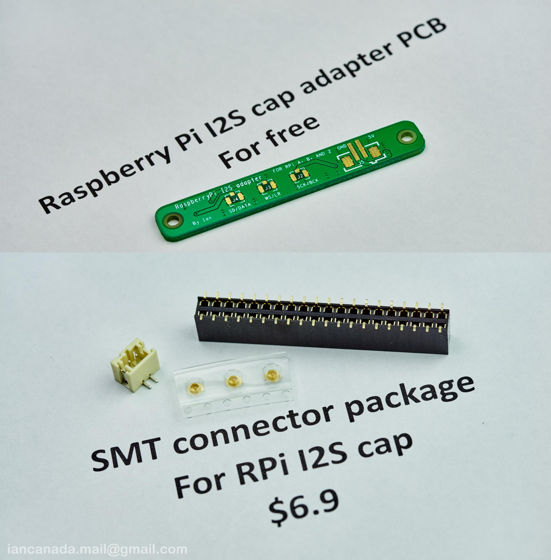

But I'm not sure whether to pursue the RPI-less route ATM.
Ignore, I have to independently power the IsolatorPi so dealbreaker since I don't have a MKIII ATM.

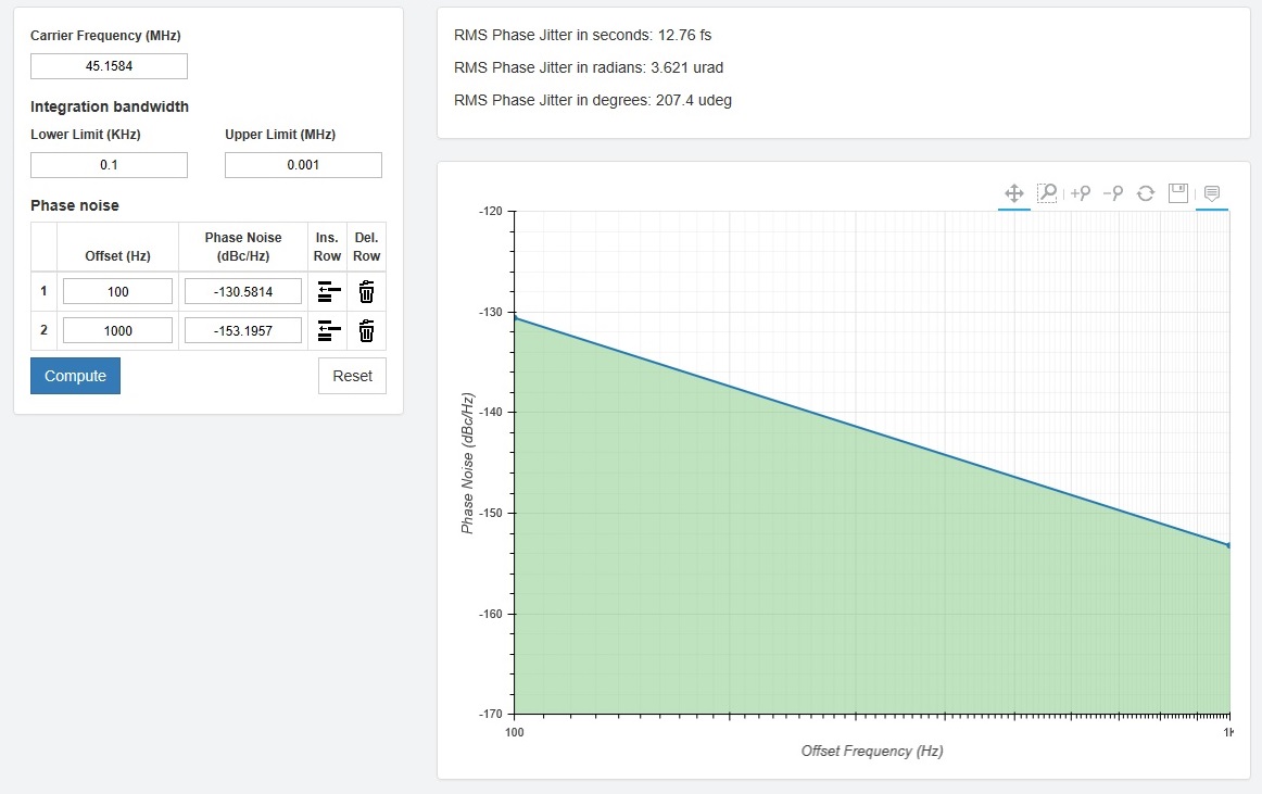

How does your oscilloscope measure the jitter?
As you know the calculated jitter depends on the integration bandwidth.
You should measure the phase noise rather than the jitter, phase noise is absolute while jitter is strictly related to the integration bandwidth used for the measurement.
I can not remember to have seen an artificial bandwidth limit in a LeCroy jitter package. So I assume the bandwidth limit equals the scope bandwidth.
The scope, a LeCroy LC584AXL, is running at maximal sample rate and the 50Ohm input impedance is used. So the most likely setup is that no probe is used but the source is directly connected by a cable to the scope and thus the bandwidth is the full scope bandwidth of 1GHz.
P.S. there is no integration. the scope measures in the time domaine, so measure the jitter directly.
Jitter is a relative measurement, so the result depends on the integration bandwidth.
A measurement close to the carrier shows higher jitter than a measurement far from the carrier.
In digital to analog conversion we look for the best short term stability, we don't care about long term stability.
So, it's crucial that the lower limit of the integration bandwidth is close to the carrier, that means not more than 10 Hz from the carrier, better if it's 1Hz from the carrier. While we don't care about the upper limit of the integration bandwidth.
This is the reason why is better measure the phase noise rather than the jitter, phase noise is absolute, not bandwidth dependent.
If the integration bandwidth is not known the jitter value does not say nothing.
You can find a lot of "phase noise to jitter converter" on the web (or if you want "frequency domain to time domain converter") that help to understand. Try adding measurement points each time closer to the carrier and you will see the jitter grows exponentially.
A jitter value of 600 ps says nothing if the lower limit of the integration bandwidth is not known.

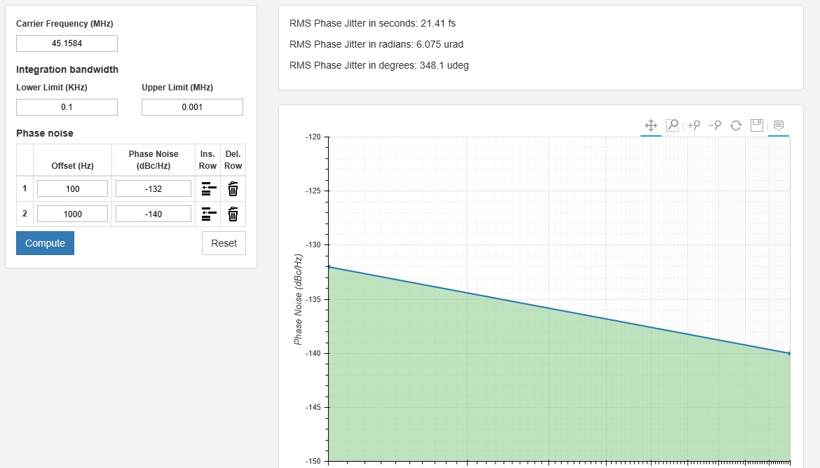

You mix up phase noise and jitter. The close in phase noise is higher, yes, but contributes next to nothing to the jitter due to its relative small occupied 'frequency band', regardless if you include it to the integration or not - try it with your mentioned jitter converter.
The phase noise in e.g. 10Hz offset to the clock has no '10Hz offset effect' to the in the produced audio ... thus marketing statements, that the clock has low phase noise in the audio band, e.g. below 20kHz, are nonsense ... at least if you interpret them naively.
10Hz offset to the clock hevily affects the digital to analog conversion.
The jitter measured with an integration bandwidth starting at 100 Hz from the carrier is almost the same for most oscillators, including the standard one provided by Ian, the Crystek, the NDK, the Pulsar and maybe the SOTA oscillators like Wenzel and Oscilloquartz.
What makes the difference is just the close in jitter (in time domain or phase noise in frequency domain, the same thing viewed from a different point of analysis), that's the reason why the best converters on the market are focused on very low phase noise oscillators.
Please try the jitter converter to understand. I have no time to do it for you.

Please, explain the following jitter plots, the first is the Crystek CCHD-957 at 45.1584 MHz and the second is the Pulsar Clock at the same frequency.
From your statement about the integration bandwidth I have calculated the jitter with a lower limit of 100 Hz from the carrier, taking phase noise data from datasheet (no jitter declared, phase noise only, that's logic).
As you can see from the plots the Crystek is much better than the Pulsar Clock, 12.76 fS against 21.41 fS.
Is that right?
If so, why the Crystek costs a fraction of the Pulsar Clock?
