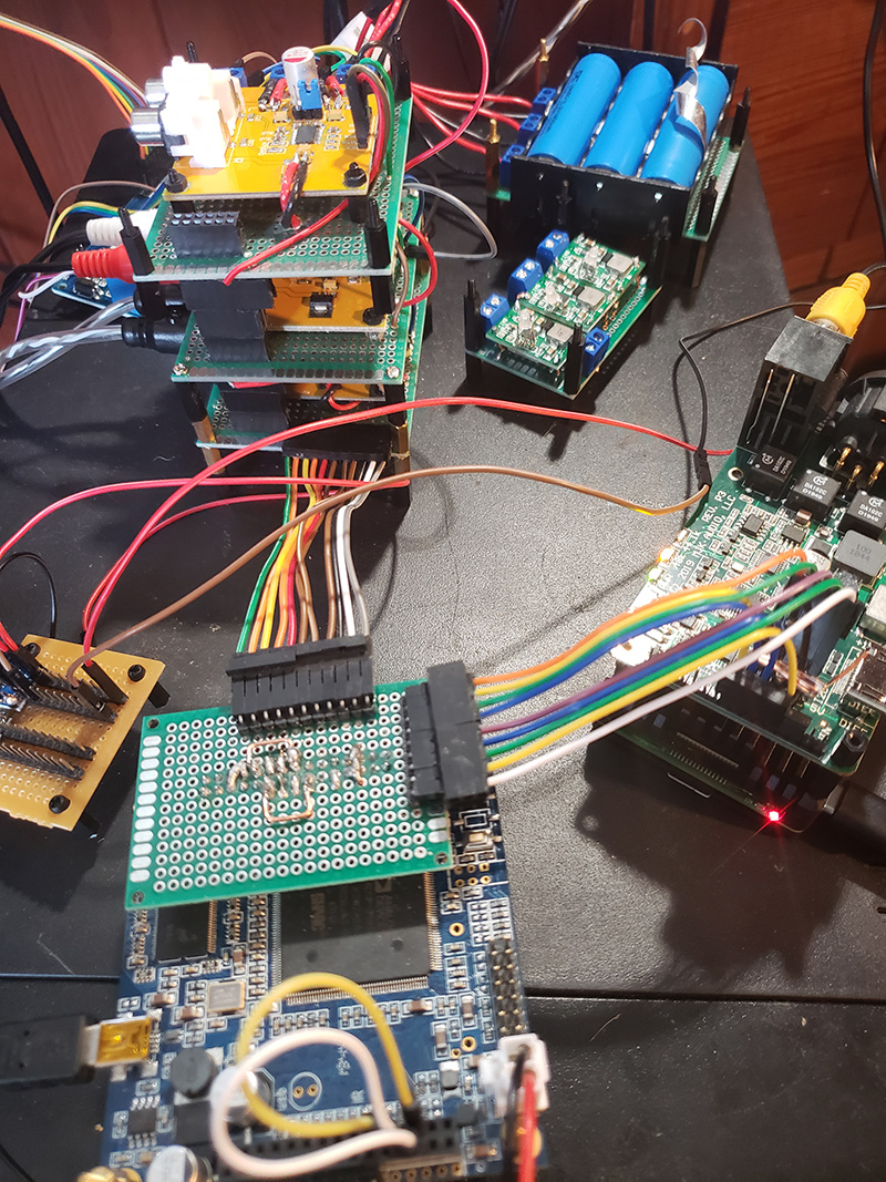

I whipped up a prototype breakout board for the MiniSharc to connect with the Pi2AES (to be replaced by Ian's Fifopi ultimate) and stacking headers on dac breakout boards to distribute the signals from "master" dac breakout board to "slaves".
Those cheap PCM5102 dacs ($7 each!) are there just for prototyping purposes .. and for making early power supply & other mod mistakes inexpensive... but I'm astounded by the difference in swapping the 3 regulators for LifePo4 power. And, yes, I did "semi-blind" A-B testing with a Schiit Sys... as I will continue to as I compare Dacs and dac mods.
Once I lock in a DAC direction, I'll likely look to acquire a McFifo and McDual if they will benefit the sound ... I hope they will be available as Audiophonics no longer lists them.
With MiniSharc set to slave in/slave out, I'll run the Master Clock signal directly from the FifoPi (Pi2AES for now) to the Dacs. Those boards will require some additional al surgery as they are currently set to PLL mode, though.
I noted they have resistors on the BLK and LRCL lines... I assume I'll need one as well for the Master Clock signal?

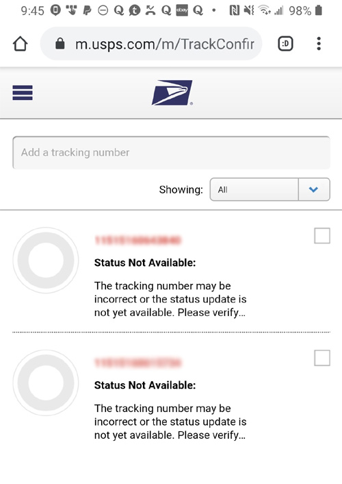

(Side note )Audiophonics got back to me on the ghosted tracking of the late Fifopi Ultimate/TransportPi/clocks/ConditionerPi/etc order and said they "initiated a complaint ticket with Colissimo International" ...still no sign on Collisimo/USPS tracking of any activity since the packages left France in June, though, so I may need an alternate source for those as well .... considering it currently appears they are on the bottom of the Atlantic waiting for archeologists to discover them 3,000 years from now like the Antikythera Mechanism, speculating on their purpose and wondering who the great leader "FifoPi Ultimate Q2" was, since the objects of art (or weapons) were obviously created in his honor (or to defend his territory).

I bought some boards from Tea Bag back in May. He promptly shipped them and 4 days later had reached the UK... presume Heathrow Airport and its huge mailing import duty system.
The tracking thence stopped and seemingly sat in the ether for about 5 weeks. They finally showed up a couple weeks ago after Tea shipped May21st.

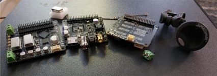

The new toys just arrived!
Image attached of, left-to-right, FifoPi Q2 Ultimate, TransportPi, ConditionerPi, umm, "GuitarTunerPi?" .. Accusilicon clock in background.
Thanks, that means a lot coming from you! I am excited that the ConditionerPi, TransportPi, and FifoPi Q2 Ultimate just arrived.
The proof is in the listening, of course, and I trust that will be excellent, but first impressions: These boards are extremely well constructed. They radiate quality. I'll share more as I integrate them in my new system.

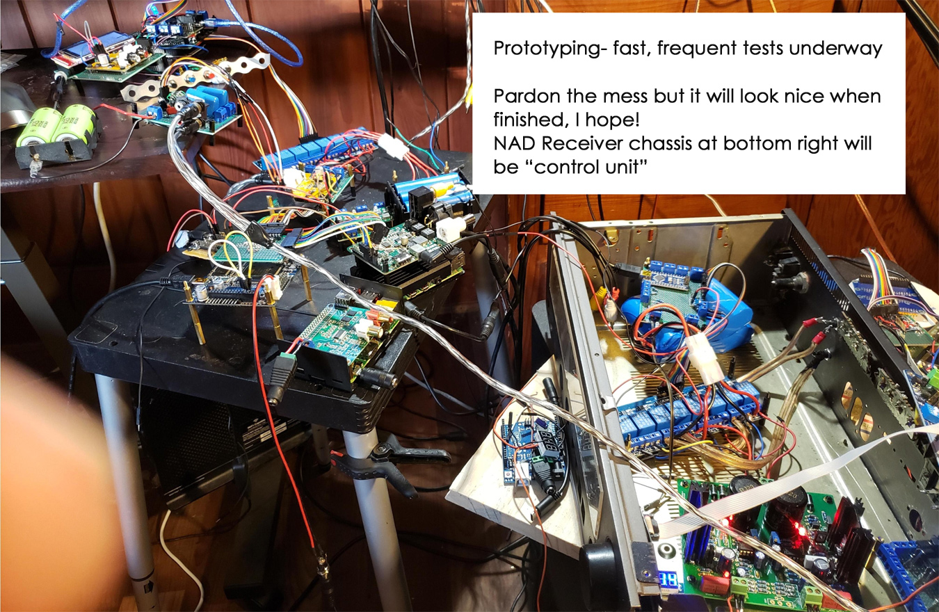

and, if you are reading this and have an idea to share or see something I am making a mistake on or could do better .... please share in reply. 🙂
Raspberry Pi4 running Volumio *-> ConditionerPi -> TransportPi** -> FifoPi Q2U -> MiniSharc in slave mode -> DAC Stack*** -> (future possibility: McFifo and McDual, which I appreciate because of my Scottish heritage) -> PGA-8CH 8-channel volume control/preamp board -> amps -> speakers
* considering Moode as a more stable platform
**maybe.. or maybe not needed since I am using i2s out to the MiniSharc
*** testing and building various possible DACs while working initial system out with cheap PCM5102 boards with various mods to test power supplies, etc.

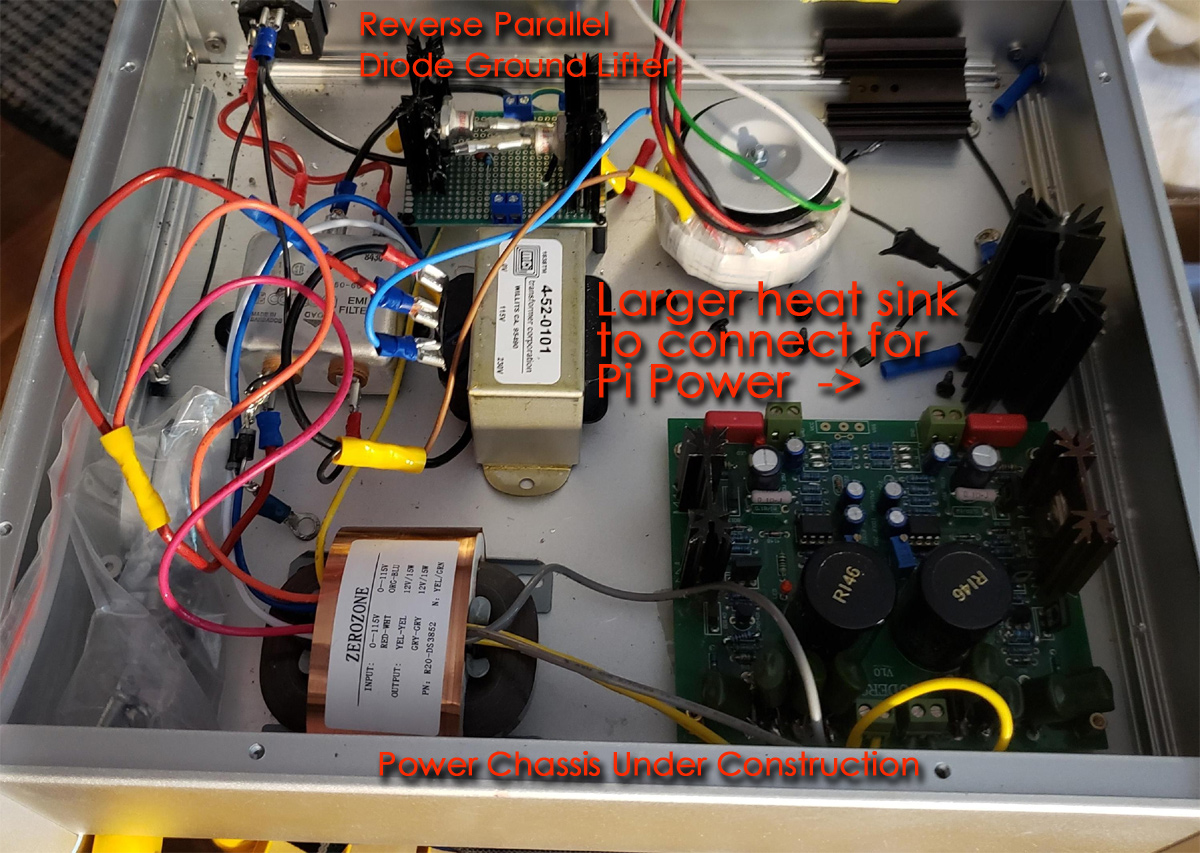

The power system is
* R-Core transformer + Modded "Studer 900" board powering thee MiniSharc and, possibly, the Raspberry Pi
* Toroidal transformer via Audiophonics for PGA-8CH board
* Above in separate chassis, to be connected with umbilical cable
* LifePo4 power for 3.3V circuits, managed with Arduino system + relays and TP5000 boards to charge. Currently, I am using this with 3 circuits per PCM5102 board replacing the LM1117 regulators, for instance. I initiated this system before Ian launched his LifePo4 board or would likely have purchased one of those as they look excellent.
* Maxwell 350F/2.7V Ultracapacitors I aim to build managed systems for.
Speaking of managed systems,
The control system is Arduino-based
*Arduino Mega running, among other things, relays for battery management and system power up-down, responsive to...
* ESP8266 board controlling and pulling info from Volumio over WiFi via their API.
* A satellite Arduino Nano or 2 running power modules, (soon) monitoring heatsink temperature and voltage measurement via optocouplers (or with the flying capacitor method if I can get it to be consistent enough) and communicating with "mother ship" Mega via serial.
All Arduinos are galvanically isolated from the audio circuits, of course... but if stray noise creeps in from them in spite of that, I'll take other measures up to powering them with batteries and putting them in separate boxes...
Amps are ChiFi tubes (Yaqin for mids, Nobsound SET amp for tweeters)
plus vintage NAD 2700THX for the woofers... and the servo-feedback-loop empowered class D amps packaged with the ....
2 Rythmik 12" holding up the bottom end beneath NHT Classic 3's I've had forever but converted to active duty, initially with DBX 234s analog active crossovers, when I got bored and yanked out the passive crossovers last year.
de note for the curious about multi-amping- it took some patient work with REW and a calibrated mic to work out the nuanced but, overall, going from passive to active crossovers was like lifting not just a veil but a thick, shag-carpet curtain between my ears and the music.
I'm looking forward to contrasting the difference with that analog active setup with a hopefully-optimized digital active setup, including FIR filters etc. As I mentioned earlier in this thread, I'm keeping the analog side for ddigital-free vinyl and low-latency movie watching.
Next steps, for the curious and those who might wish to contribute ideas-
1. integrated system power on/of/sleep (recharge, etc) management via Arduino & relays.
2. pushbutton/ rotary encoder + remote layered menu system to toggle between Volumio (or Moode, or?) player management, power management, system feedback like battery & UC voltage + heatsink temp, etc
3. MiniSharc management via Arduino via #2
4. Continue A-B testing DAC possibilities with various chips- the modded PCM5102s will hold down the fort while building a TDA1541-based board to contrast with TDA1387 board I just built. I am enjoying learning as I optimize and hear the distinctions.
5. Explore FPGA programming for DAC filtering and, hopefully, DAC building a la Chord & PS Directstream. I am new to FPGA but am usually a quick study at such things.
6. Modify PGA-8CH board, possibly replacing op amps with discrete circuits and upgrading power supplies.. or find higher fi alternative
7. related to 4, 5, and 6 (PGA-8CH does have relatively generous gain available in active mode) experiment with DAC filters and output stages (if needed)
8. Add McDual & McFifo if jitter is an issue at a later stage ... or, just because ...
9. and a partridge in a pear tree
cheers
Chris
Beautiful. Both on receiving your order and the photos of your project.
Overseas tracking is tough sometimes. I followed an order from the Australian Post then it disappeared when crossing the ocean. It showed up when I went USPS site, but in your case nothing is showing. Never appeared on the Australian post till a few weeks after delivery.
Since the AS318 is in the background of your photo, I'm motivated to place an order from France at the end of the weekend before business day opens in Europe.
